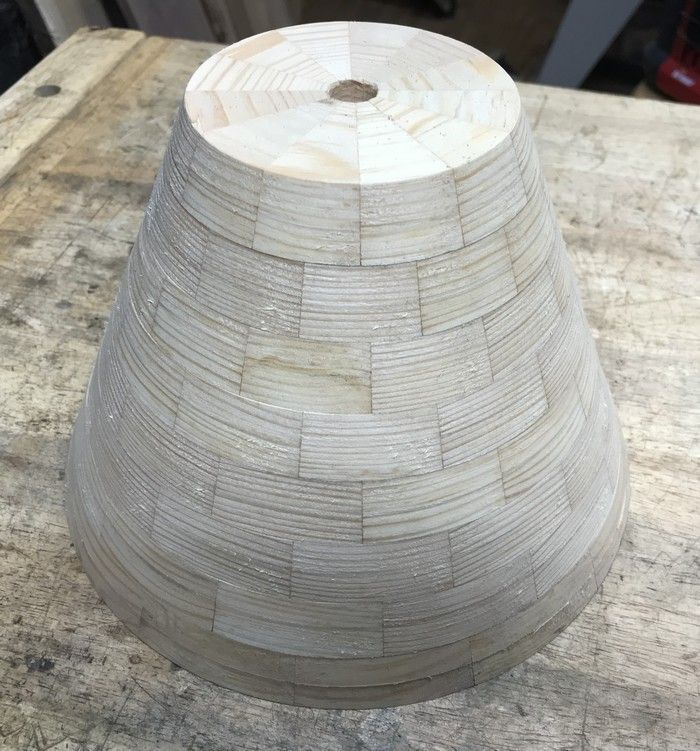

November 9, 20215 yr Popular Post comment_274699 On 11/6/2021 at 6:43 PM, HandyDan said: There is a machine designed specifically designed for cutting bowl rings. Belonged to a forum and the owner and some of the other fellas were expert with those machines. I believe Gerald had one at one time but anyhow it is a Ring Master Lathe. Here is a link. https://ringmasterlathe.com/ @Smitty Dan hit the nail right on the head. Here are a couple of pictures that show the rings that were cut on a ringmaster lathe and then those rings stacked up. You can make a bowl from a board very efficiently with success. Report

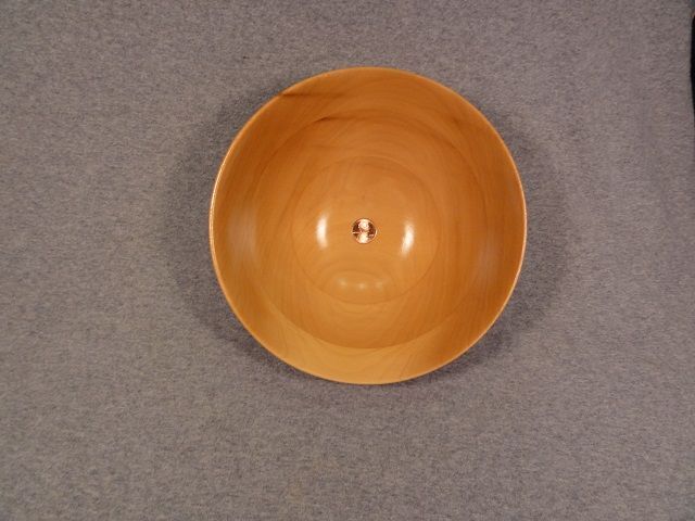

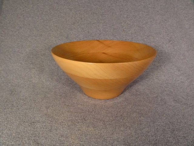

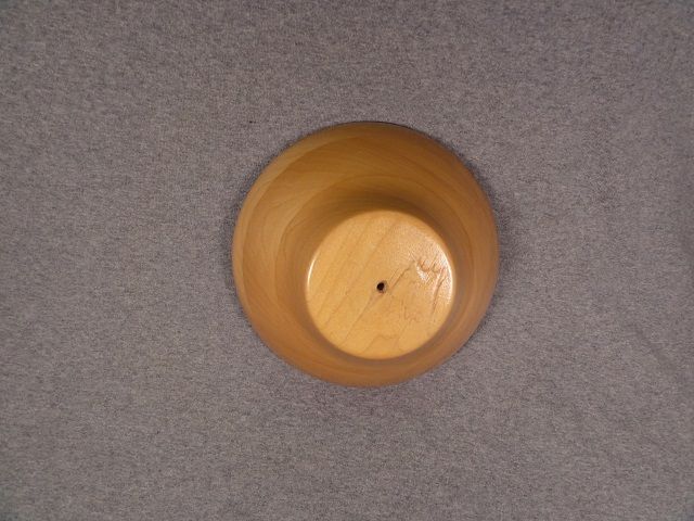

November 15, 20215 yr Popular Post comment_275279 I made a bowl from a board using a parting tool to cut the rings quite a few years ago. If I remember right I just widened the gap so the parting tool didn't bind up. I just guesstimated the angle and went for it. The rings were no where near the accuracy of the Ringmaster but close enough to glue them together. I would have been there all day using sandpaper to smooth it out so a used my bowl gouge and worked the sides before sanding. I used a screw mound to cut the board into rings and then to turn the sides and sand it. I drilled a .75 recess in the bottom and glued a penny in to cover the hole. The penny is a 2012 and I am sure that's when I did this. I don't know why I didn't do the same on the underneath. At times I have thought to add a flat disc base for weight, drill a hole in the side and make it a yarn bowl. Report
November 15, 20215 yr comment_275283 2 hours ago, HandyDan said: I made a bowl from a board using a parting tool to cut the rings quite a few years ago. Super! I like the penny idea! Report
