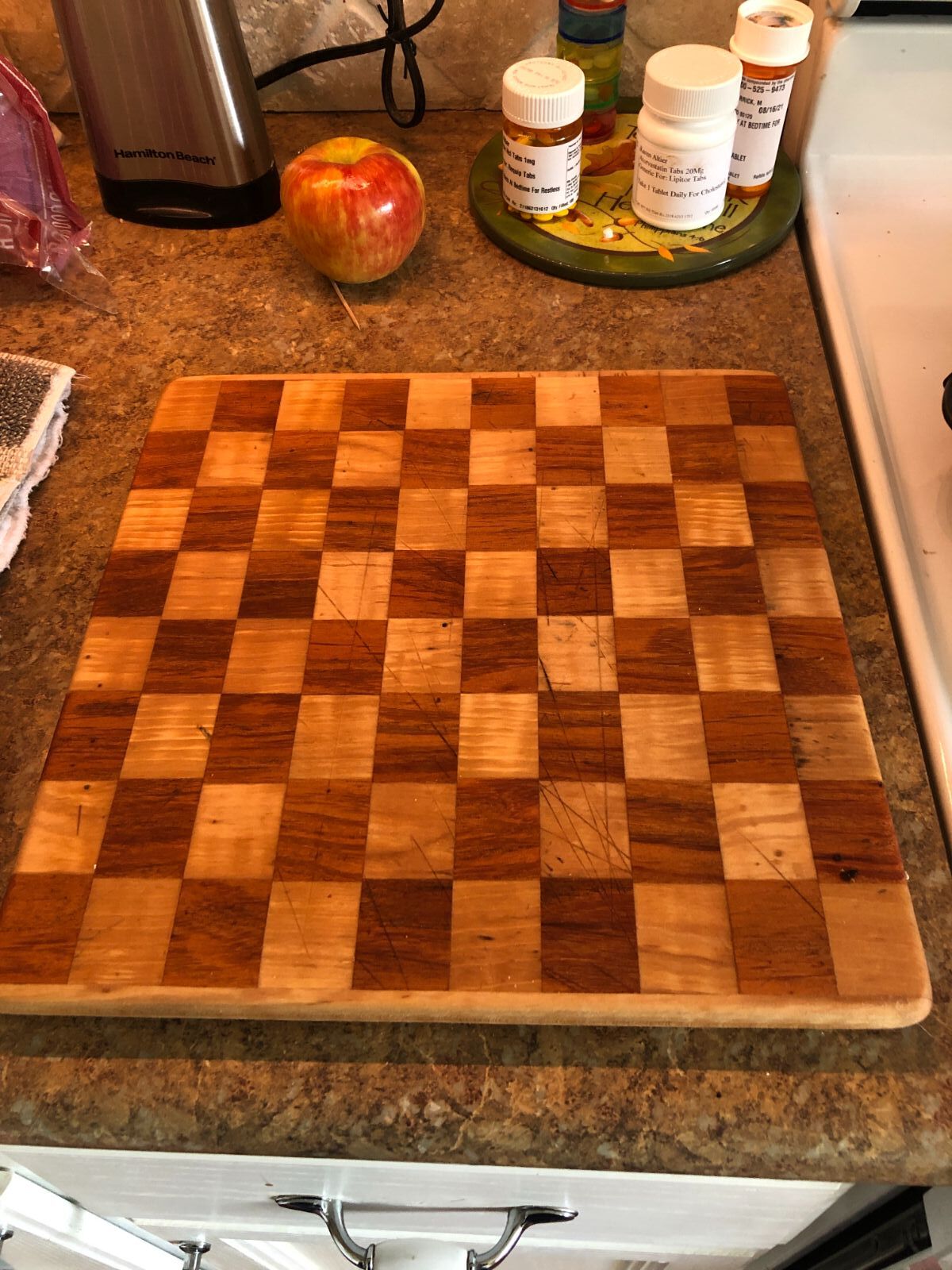

October 14, 20215 yr Author Popular Post comment_272813 Here is one of the reasons I asked about extra support for cutting boards. I made the cutting board pictured possibly 20 years ago. It was made of 2 hardwoods and was stripes only. (No squares.) It became beat up from all those years usage. My wife wanted to toss it. I thought I'd try to make squares out of it. When I cut it up, it was full of biscuits. No wonder it had held up so well. I cut it up into strips across the grain and selected the best of the best and made this one. Its about a foot square. It shows wear, even tho I sanded it really well. I was VERY sure my wife would NOT like it. It seems that even after 50 years of marriage, I still don't know here tastes. She loved it. Edited October 14, 20215 yr by Ron Altier Report
