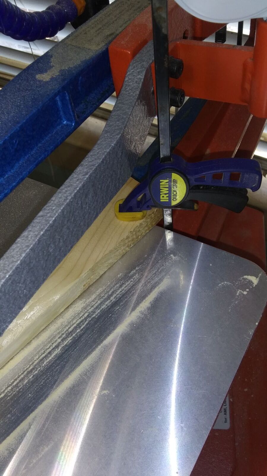

There is an easy jig to set up for straight line cutting; a fence, and use spiral blades.
.035 drill bit #65 FD #2/0 new spiral blades.

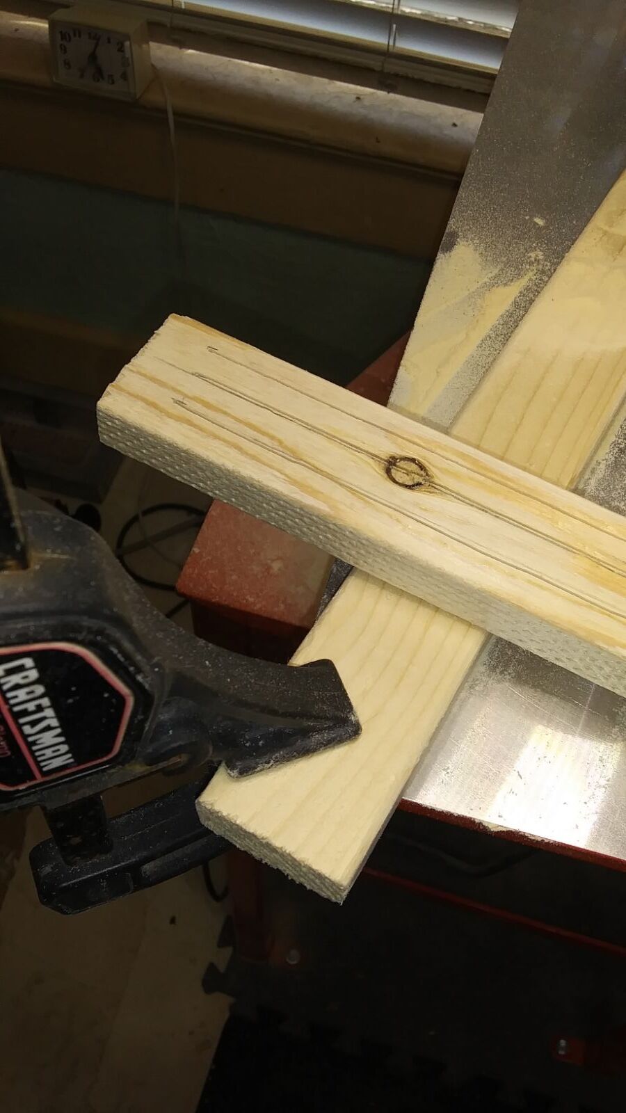

IF you need a straight line and you don't think your skill are up to it, or if you need several parallel lines cut:
Oh oh, you went there... :BitingNails:

Bump; as this is what I was thinking about when I posted about the popsicle sticks.
Ah, yes, the old "How do I cut a straight line?" thing.
Most of us still dwell on it.
For me, I have learned to sit straight behind the kerf, start the line from the far end of the cut (minimizing the corrections), coming forward with my body helps, when possible I pull the piece through thereby keeping corrections to a minimum. Seems to work most of the time for me.
Forgot cutting across grains - go slow........
