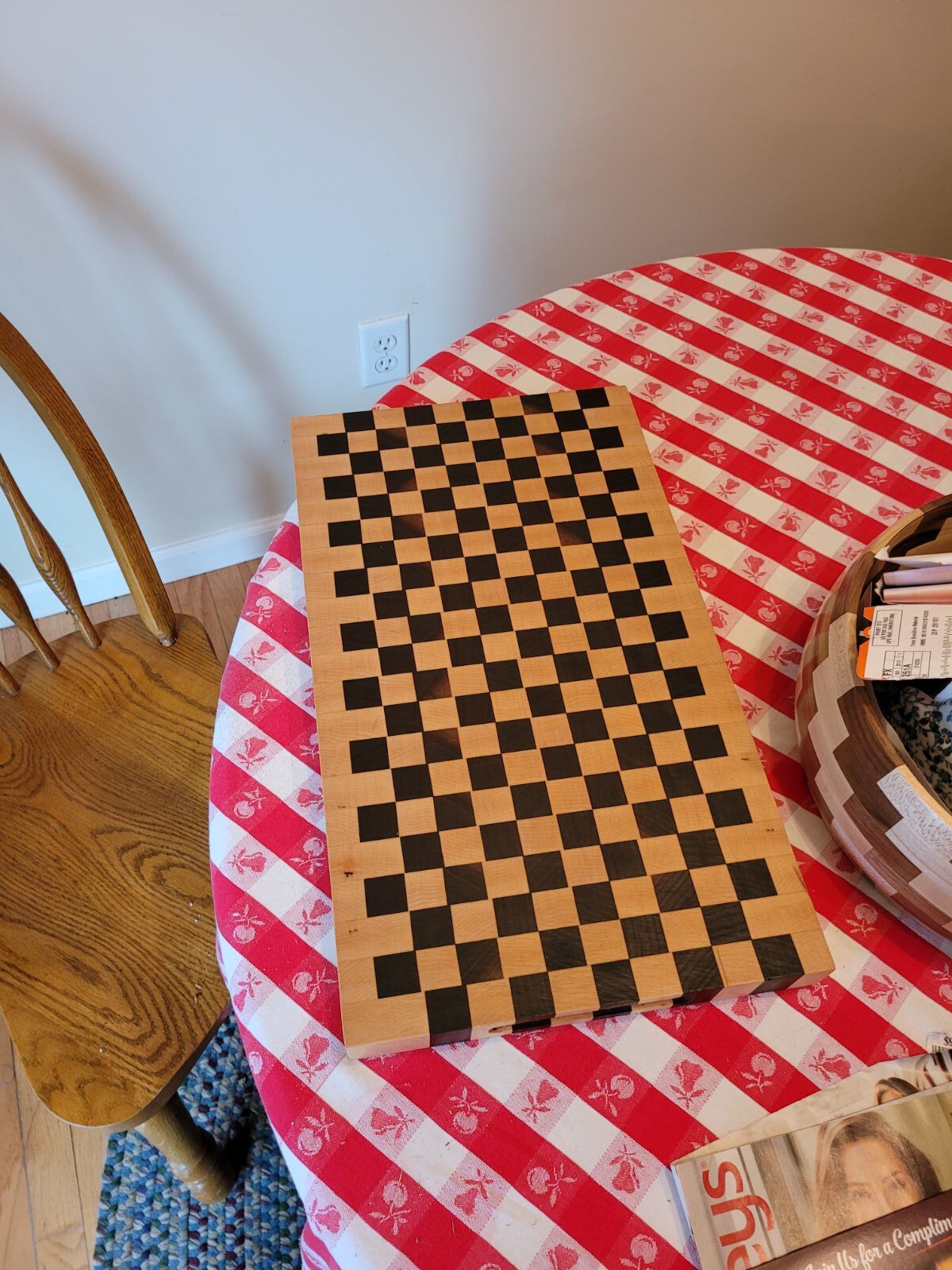

September 26, 20215 yr Popular Post comment_271818 This was my first attempt at a cutting board. Everything didn't line up as planned. Now that I have a planer I am looking forward to better results. It is an end grain board made from Maple and Walnut. It is 11 inches by 20 inches by 1.5 thick. Report
September 26, 20215 yr comment_271819 Not a good idea to run an end grain cutting board thru a thickness planer. It can cause the pieces to tear out and split Report
September 26, 20215 yr Author comment_271821 4 minutes ago, lew said: Not a good idea to run an end grain cutting board thru a thickness planer. It can cause the pieces to tear out and split I agree. What I need the planer for is making all of the pieces square and the same size. Then getting both sides smooth for cutting and the final glue up. I finish sanded it with an old Craftsman 3” x 21” hand held belt sander. Report
September 26, 20215 yr comment_271824 That’s how I did mine too. On my first one, I sanded a little too heavy and the heat caused it to bow. Left it set overnight and it flattened out OK. Report
September 27, 20215 yr comment_271829 Think you done good. I used a wide belt sander on all of mine. Report
September 27, 20215 yr comment_271835 Looks good here. It looks like a really good job for a first time. Report
September 27, 20215 yr comment_271865 Looks good for a first one Rusty. Does your new planer have a spiral cutter head ? I thought it did. That should handle end grain easily. Paul Report
September 27, 20215 yr Author comment_271877 1 hour ago, Masonsailor said: Looks good for a first one Rusty. Does your new planer have a spiral cutter head ? I thought it did. That should handle end grain easily. Paul Yes it does. Report
