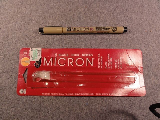

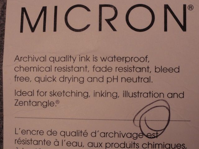

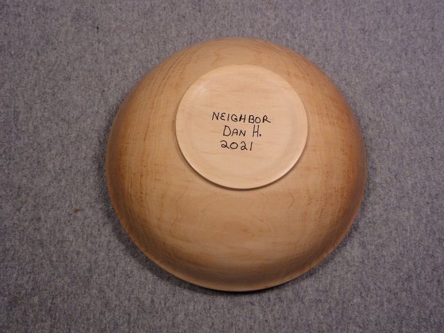

August 25, 20215 yr Popular Post comment_270160 If just using some type of pen to sigh your work I found this Micron Pen to be the best. Dries quickly and finishes don't make it run/smear. Not expensive either. Picked it up at the Hobby Lobby. Just did this today and applied wipe-on poly over it 15 minutes later using a brush. Report

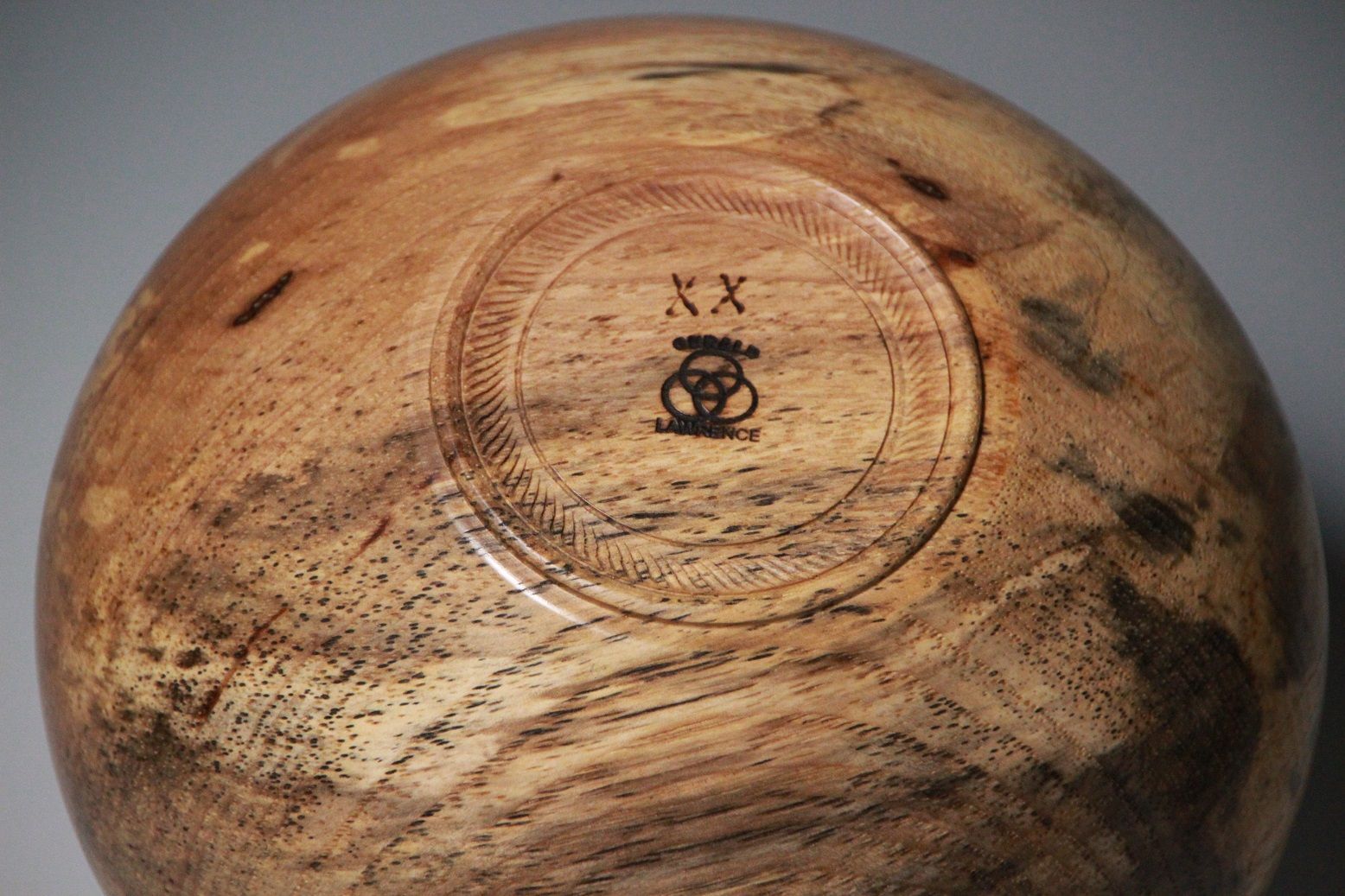

August 25, 20215 yr comment_270161 i either use one of my brands, or a wood burning pen (often for the year, as 2 of my 3 brands don't have a year) Report
August 25, 20215 yr Popular Post comment_270167 I just found that brand recently. I like it because it is not supposed to fade over time. I did notice that it does smear when putting a wax finish over it. That may be happening because I have been using the sanding paste first. I’ve looked at branding irons but I am leaning towards a laser device. They are slightly more expensive but way more versatile Report

August 28, 20215 yr comment_270342 I use Micron for a pen and inks on occasion,..I've tried several and there are other's out there I like...but Micron is my favorite. Report

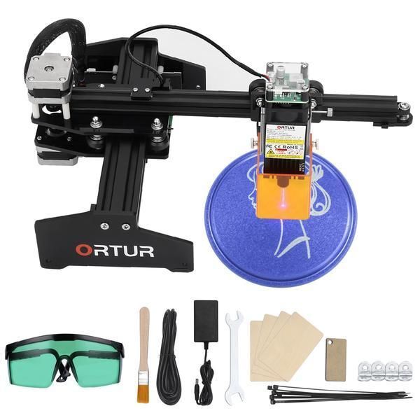

August 28, 20215 yr comment_270395 2 minutes ago, Gene Howe said: Any 20 watt input (5-7 watt out put) diode laser will do the job. You'd need a Y axis rotary roller to engrave on cylindrical objects. The bottoms of bowls would pose no problem for most Laser machines. Most are very light and can easily be elevated and made stationary at a height to allow engraving on the bottom of a bowl. There's a learning curve with matching any graphics software to the unit you choose, as well as dialing in the burn settings. I use Gimp for manipulation of the graphics and, and Light Burn to control the Laser. You'll also need a lap top unless you have a Mac or PC in the shop. Gene, This is the one I am contemplating, as it would be used only for signing work. Seems to have everything you mentioned as far as software and I do have a laptop. Generally familiar with Gimp but would need to learn Light Burn. https://orturoffice.com/collections/engraving-machines/products/ortur-laser-master-desktop-laser-engraver-cutter-laser-engraving-machine-32-bit-motherboard-laser-grbl-control-software-easy-to-install?variant=39880362754224 Report
August 28, 20215 yr comment_270396 If all you ever want to do is sign your work with easily available fonts, you wouldn't need either Gimp or Light burn. Logos are a different story. Report

October 7, 20215 yr comment_272414 On 8/28/2021 at 2:33 PM, lew said: https://orturoffice.com/collections/engraving-machines/products/ortur-laser-master-desktop-laser-engraver-cutter-laser-engraving-machine-32-bit-motherboard-laser-grbl-control-software-easy-to-install?variant=39880362754224 Thank you for the link. The small footprint of this device solves a lot of problems. .40 Report
