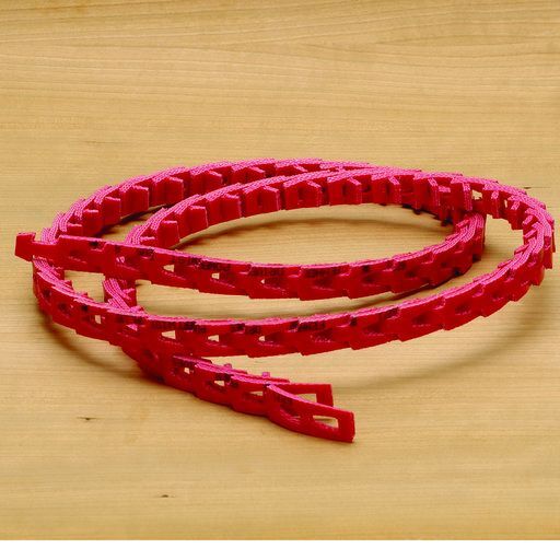

August 16, 20215 yr comment_269640 Just got this ancient Grizzly 16" band saw for fairly cheap with the idea I need to replace just about everything to get it up to speed again. Right now I'm trying to get the wobble out of the machine (seen when running) and the first thing I'm gonna replace are the 2 drive belts. I've heard about a new (to me) type of replacement belt that is supposed to turn more smoothly and is adjustable with links in it. Not sure what they're called but would they be an appropriate replacement part for this saw? Report
August 16, 20215 yr comment_269641 I think what you refer to are the Fenner Link Belts. They really do make a belt drive run more smoothly, but many folks claim they wear out the sheaves (pulleys) quickly. I have no long term experience with them, but I did put one on my contractor saw when I had it and was really surprised at the change...much more smooth. HF sells a knock off that may be less expensive. They are directional so if you pick them make sure you get them on in the right direction. Also, the belt may "stretch" slightly after running a short time as the links set, so recheck the tension. Report
August 16, 20215 yr Popular Post comment_269658 Check here, at Woodcraft- https://www.woodcraft.com/products/4-foot-of-1-2-link-belt?gclid=CjwKCAjwmeiIBhA6EiwA-uaeFd0zN7bSOjZU21Jg7bVmB18HArCL2dtoEJlGdQZPjgf0eeNXB8RPEBoCpv0QAvD_BwE Report
August 18, 20215 yr Author comment_269740 Yep that's exactly what I was looking for. Although I've been told there are lots of other reasons a band saw can be out of balance besides the belt I'm sure the belts need replacing regardless. Thanks for the links. Oh BTW the Horror Freight version goes for $35 so I'll prob go that direction. Report

August 18, 20215 yr comment_269742 1 hour ago, bradleyheathhays said: Yep that's exactly what I was looking for. Although I've been told there are lots of other reasons a band saw can be out of balance besides the belt I'm sure the belts need replacing regardless. Thanks for the links. Oh BTW the Horror Freight version goes for $35 so I'll prob go that direction. I have used them for years on two Delta Table saws, no issues. They do stretch but easy enough to remove few links once in awhile. Report
August 18, 20215 yr Author comment_269748 Oh wow that's the first I've heard about wheels going out of round. Fairly old saw so it's possible. I've got a dial caliper on magnetic base so I'll give the wheels a measure and see if anything turns up. Glad the links are removable on these belts. The one at HF seems long enough I might be able to split it and have enough for both the belts. Report
