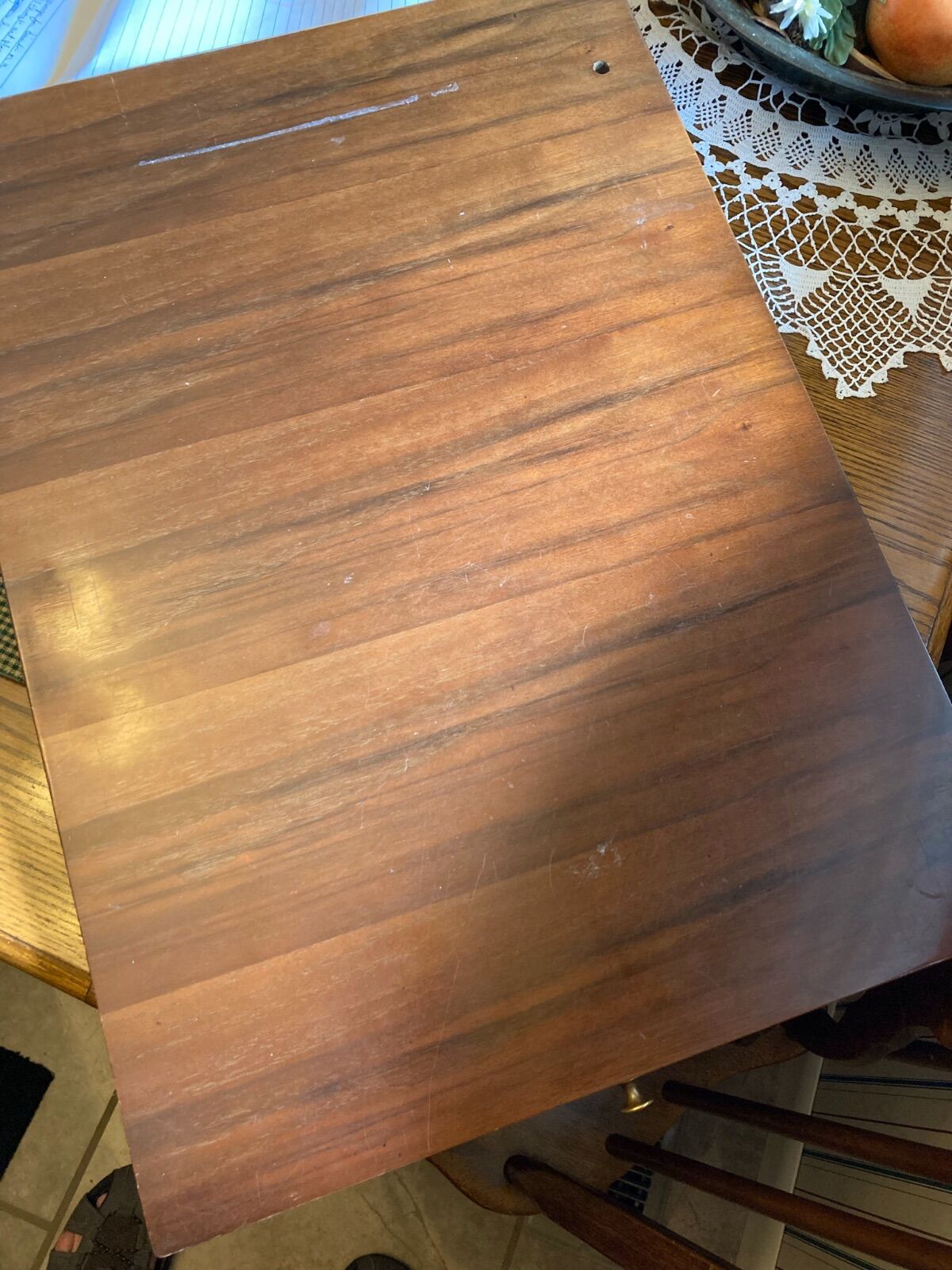

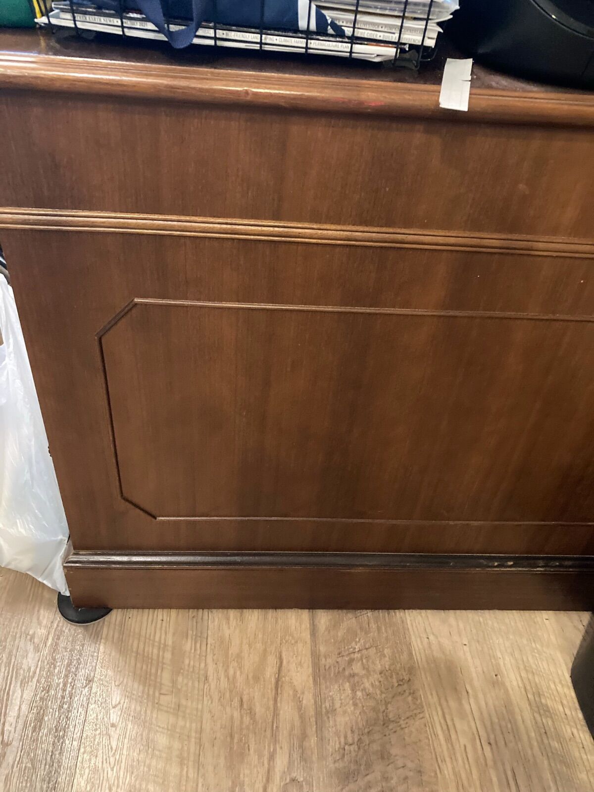

July 29, 20215 yr comment_268881 Take a look at these pictures. I have a client that wants a bookcase built to match his desk but I’m scratching my head at the species type. The smooth straight grain looks like walnut or mahogany but it’s really light for walnut and not red enough for mahogany. What do you folks think? How do I match it. One picture is the end and the other is a writing pullout in the afternoon sun. Report

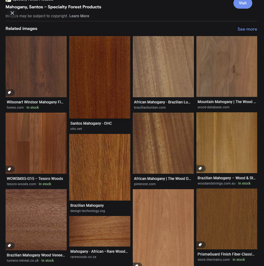

July 29, 20215 yr comment_268884 Not all Mahogany is reddish in color. This came from Google images. Report
July 29, 20215 yr comment_268888 I'm thinking the way Dan is indicating. This piece of furniture was probably built in the fifties in the USA and back then they never heard of Bubinga or Sapele and why would they want to spend extra money above the cost of mahogany which was lots of it for sale in this country. Report
July 29, 20215 yr comment_268891 it's a thin veneer too. you can tell from the repeating grain patterns. personally, i'd suggest to him to let you design and select the wood, since he has no idea what he currently has. never going to match, but you can at least stay in the same color family with stains. not a fan of slip matched veneer, it's like you weren't even trying to make it look pretty (and the factory wasn't, and it shows). get it built, get is shipped, get it sold!!! Report

July 31, 20215 yr comment_268936 I think it would be Mahogany also. It would be tough to find that much straight grain walnut. As to color walnut lightens with age. Mahogany darkens with age but if exposed to direct sunlight the color will fade. Report
