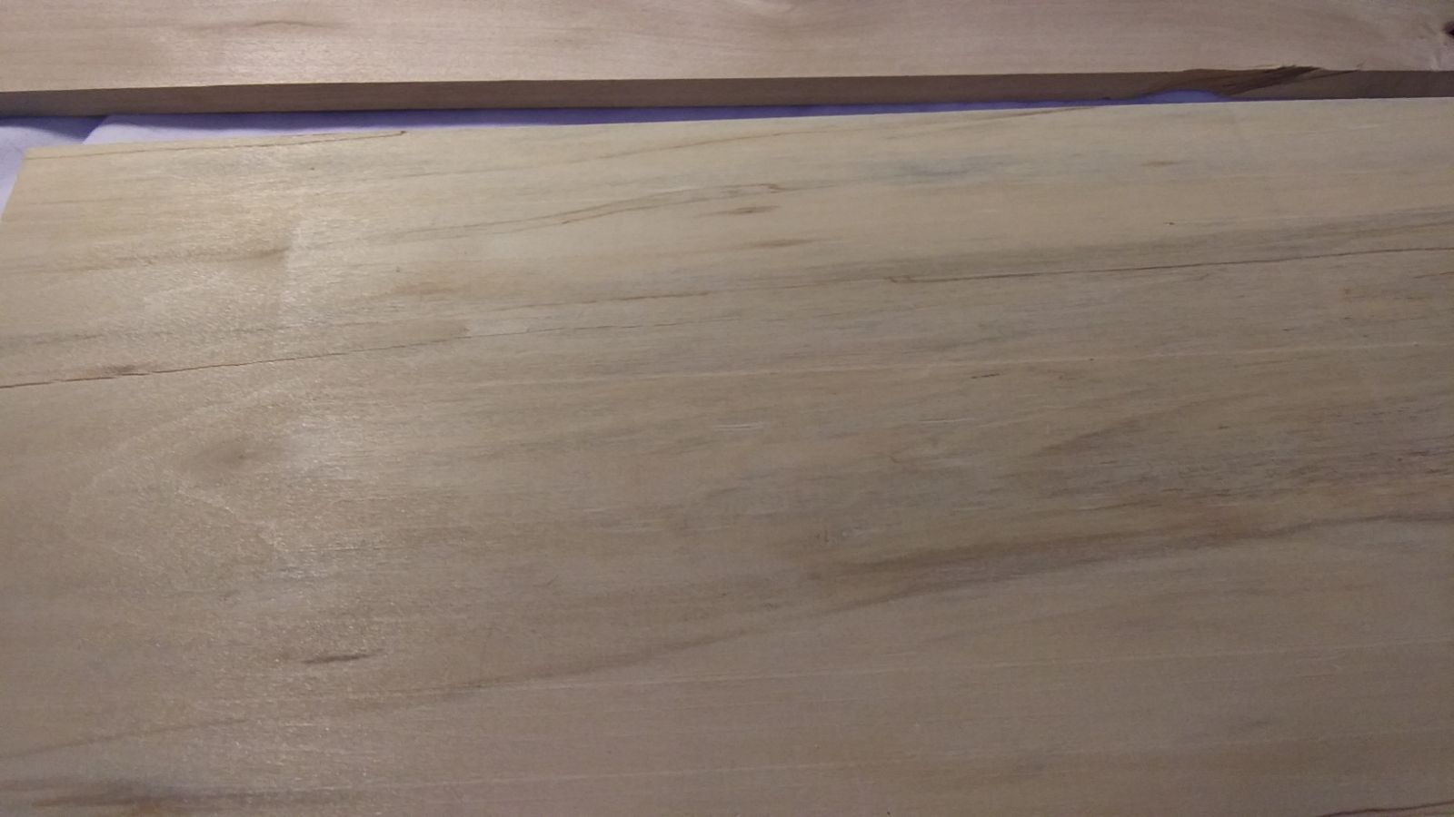

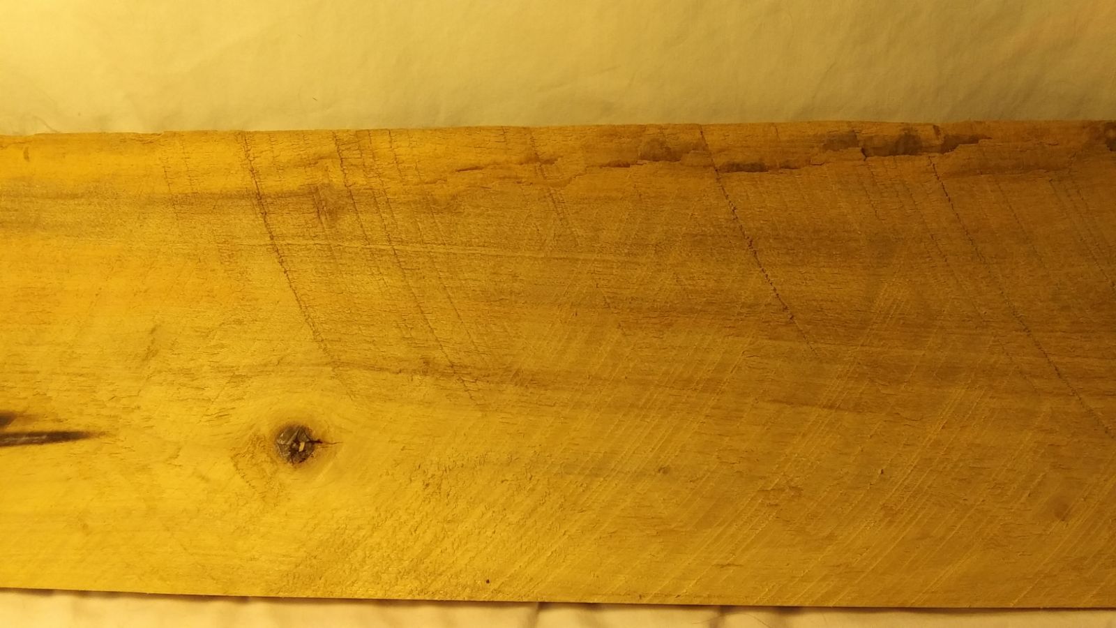

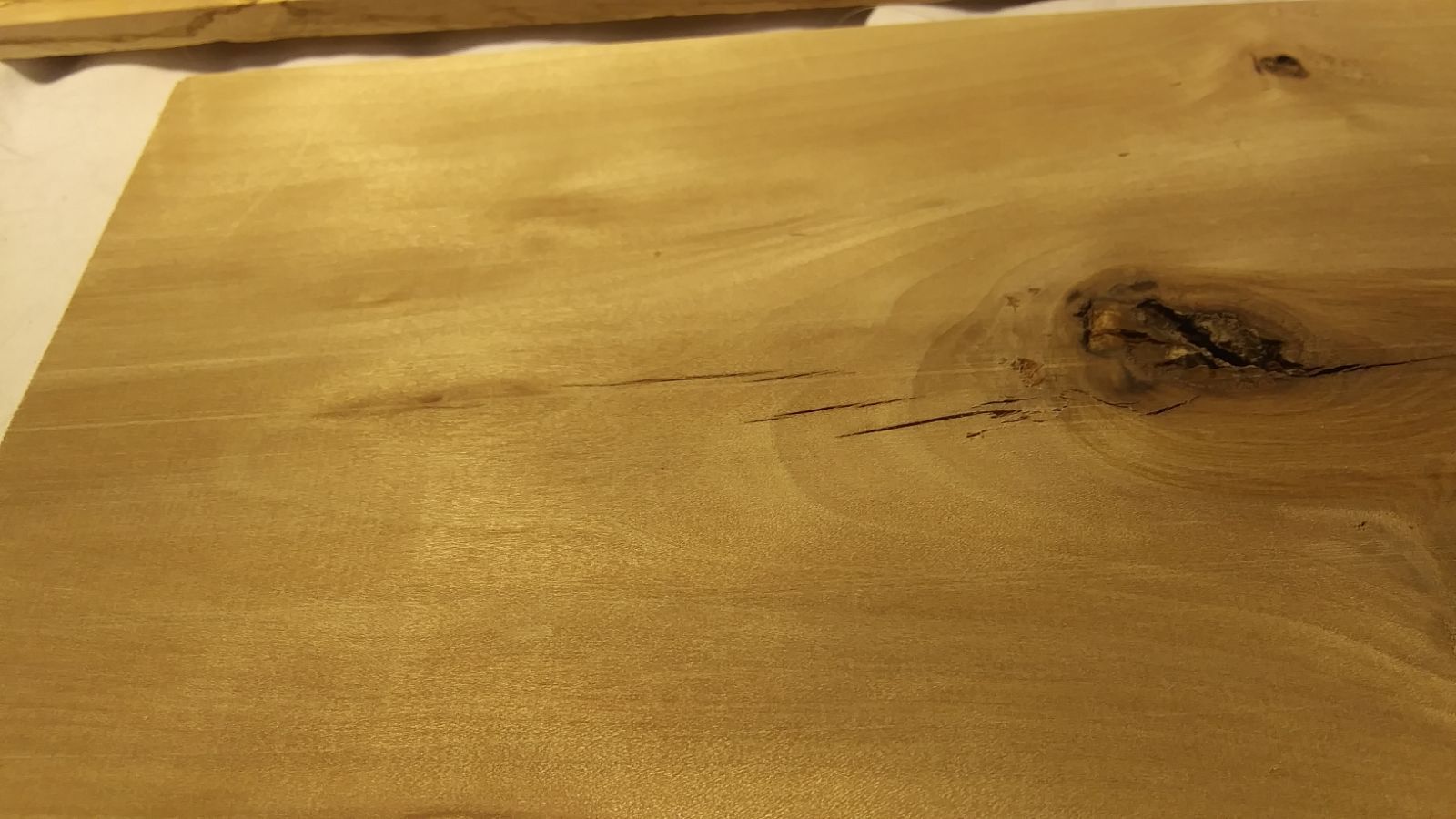

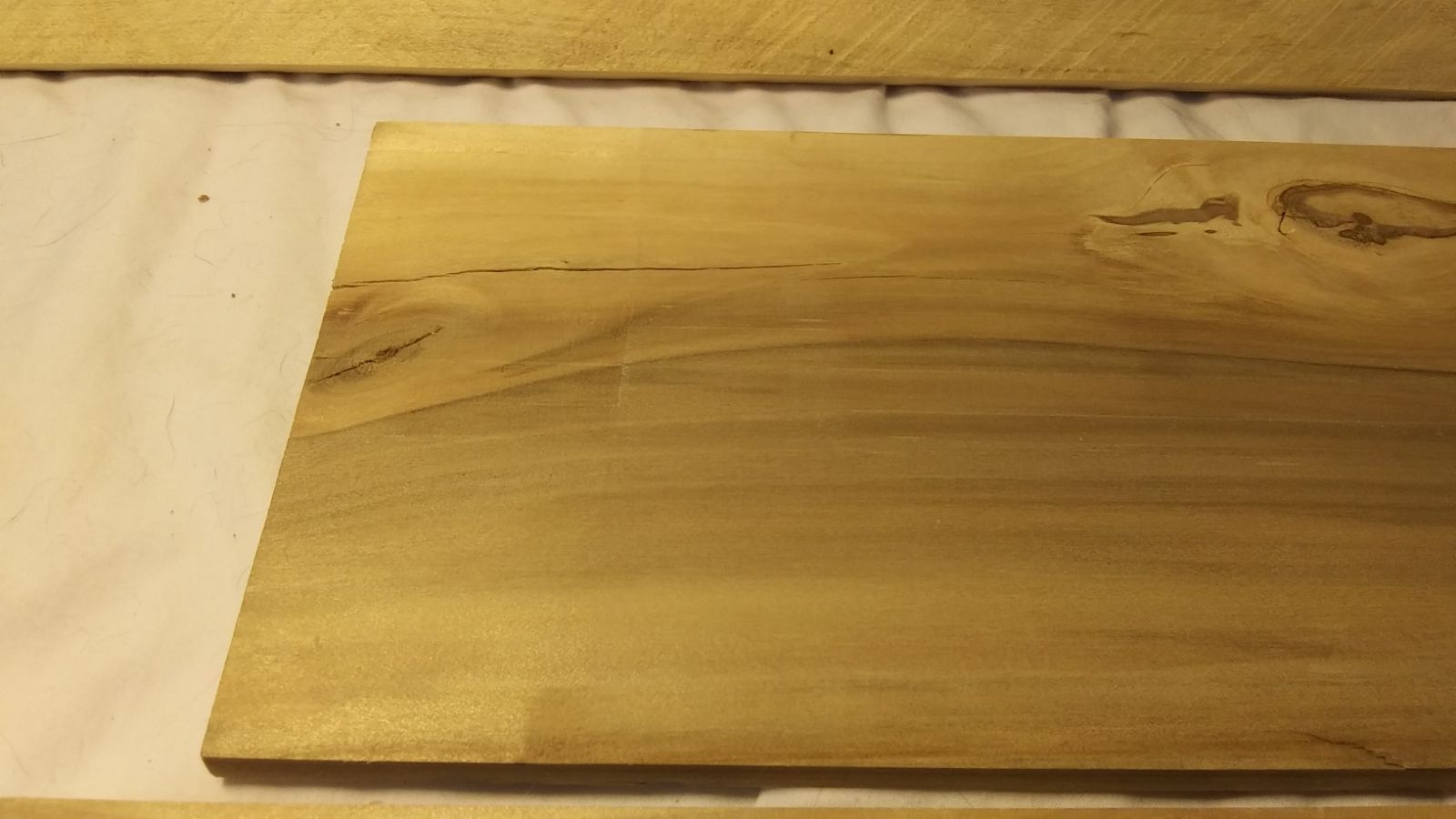

Popular Post Wichman3 Posted July 9, 2021 Author Popular Post Report Posted July 9, 2021 Here are a few pictures. I've got it dialed in ( I think ) and will be planing some more this weekend. The boards are mixed species and are 5/16" thick. This is the rough sawn board that I was sanding smooth: Here is one of the board after running it through the planer: Another board showing the snipe: If you look close you can see the small ridge caused by a nick in the blades: Artie, Gunny, DuckSoup and 4 others 7 Quote
Smallpatch Posted July 10, 2021 Report Posted July 10, 2021 I can help with the snipe somewhat by raising the board up a tad when inserting the board then lifting it again when its coming out. A little practice will help..but you might have to allow for the snipe by making the boards long enough so you you won't have to use that area. Is this machine a 2 or a three blade model? Cal, DuckSoup and Gunny 3 Quote
Popular Post Wichman3 Posted July 11, 2021 Author Popular Post Report Posted July 11, 2021 It's a two blade model. No adjustments, just drop the blades in tighten the screws and away you go. The blades are double sided and cost $25 a set. I already have a spare set. HARO50, DuckSoup, Cal and 3 others 6 Quote
FlGatorwood Posted July 11, 2021 Report Posted July 11, 2021 To reduce the snipe on the tail end of the board, press another the same thickness right behind the board you are plaining. The planer will work as if it is the same board. DuckSoup, Gunny, HARO50 and 1 other 4 Quote
Popular Post Wichman3 Posted July 11, 2021 Author Popular Post Report Posted July 11, 2021 4 minutes ago, FlGatorwood said: To reduce the snipe on the tail end of the board, press another the same thickness right behind the board you are plaining. The planer will work as if it is the same board. I will definitely try that tomorrow. Some of the stock I'm working with is just under 5 inches wide so i can start one on one side and then another on the other side and just keep them going. Gunny, Cal, FlGatorwood and 3 others 6 Quote
