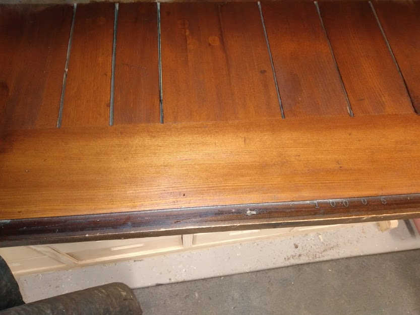

July 12, 20215 yr Author Popular Post comment_268231 The photo above shows my box of step boards (see that topic). I have an area of pine that I need to make darker, but worried about splotching. I did a quick wipe with thinned shellac as a "wash coat" and let it dry while I worked on other pieces. I think it came out without any splotching at all. 60+ year old wood on the inside of a piano. Report
