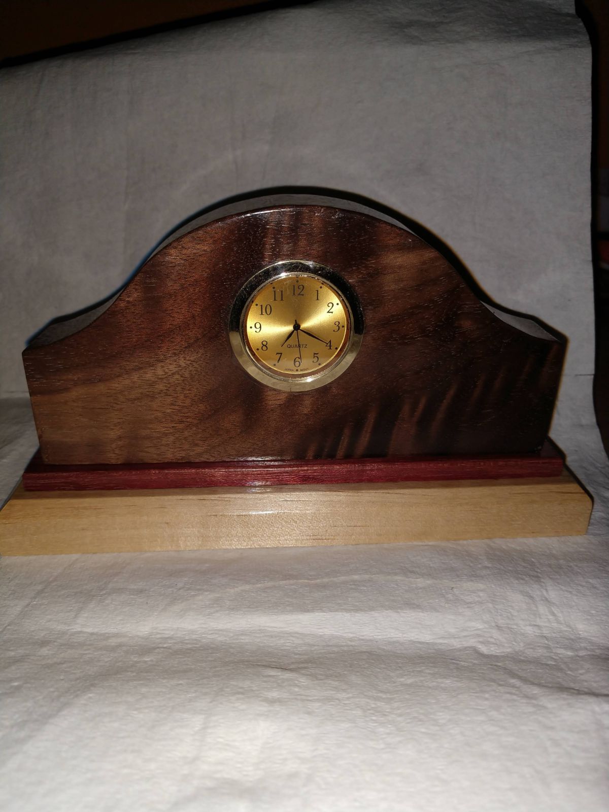

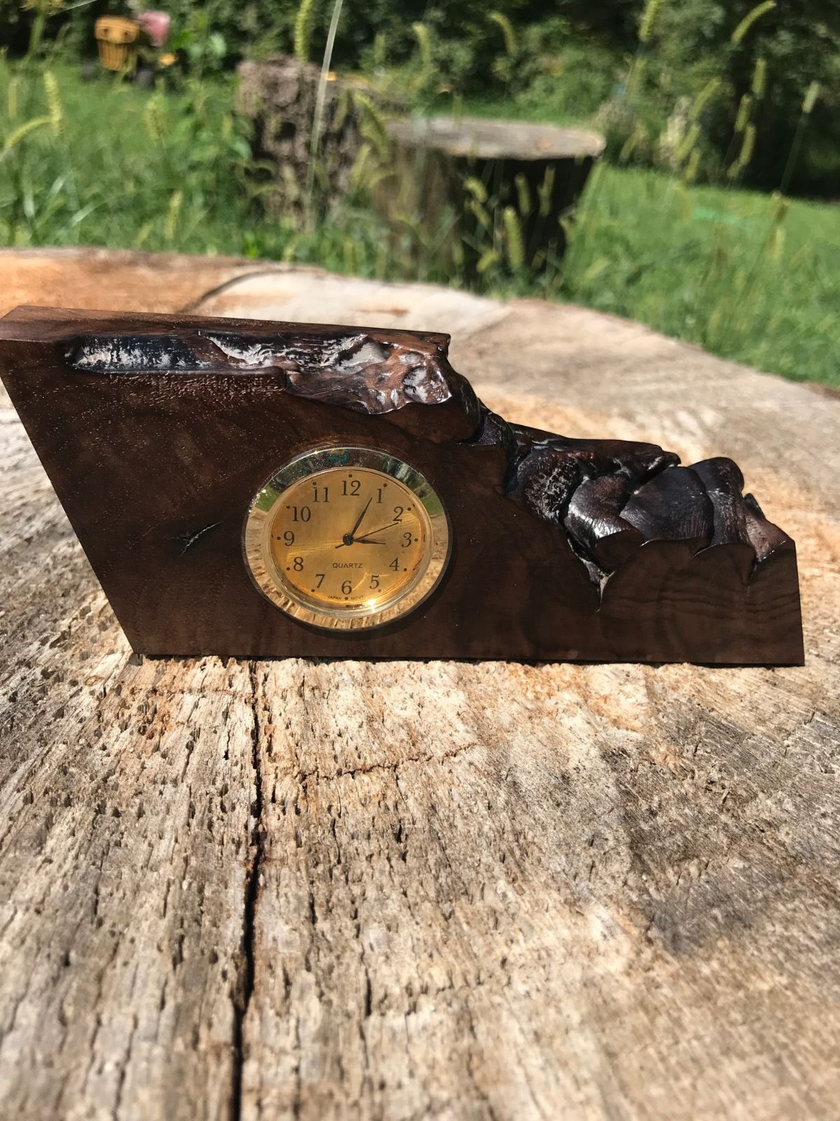

May 29, 20215 yr comment_266347 14 hours ago, AndrewB said: I'm thinking I want to just do a basic cut out for the first clock. I've made some basic ones from scrap wood, Forstner bit & a 2" klockit insert. Edited May 29, 20215 yr by DuckSoup Report
May 29, 20215 yr comment_266364 The insert ones make great presents that are fairly quick to make. You will need a forstner bit to match the size of the clock. The larger ones require monster bits which can get interesting during the boring process. I bought a 4 1/2” bit for one and it took every bit of power my SS had. If I had to do it again I would use a fly cutter style bit and chisel it out. Paul Report

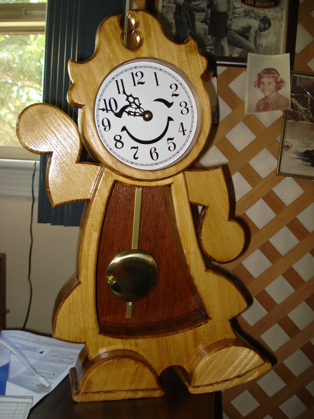

May 29, 20215 yr comment_266371 I've made a quite few clocks that used batteries, springs, & weights. Some have lasted a long time while others did not. I've built grandfather clocks, chiming clocks and cuckoo clocks that were battery clocks. The biggest failure I've had was in battery chiming clocks, I think that there is a reed contact that initiates the chimes. After about a year or so, it fails. I don't know the reason, but I suspect that the contacts no longer hit or are carboned over. (old school thinking) They are so cheap, (many less than $10) that quality isn't built in. Mechanical grandfather clocks require maintenance and lubrication every few years and they are not consistently accurate, requiring adjustments. I've used kits from Clock Kit and Emperor. I don't have a favorite. A year ago I replace a mechanical mechanism in a grandfather clock with an electronic replacement. The mechanical requires periodic cleaning and lubrication, Due to a condition in my hands, I can no longer do this properly. The electronic mechanism is doing fine and sound very good after 3 years. Report
