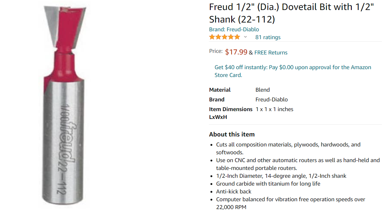

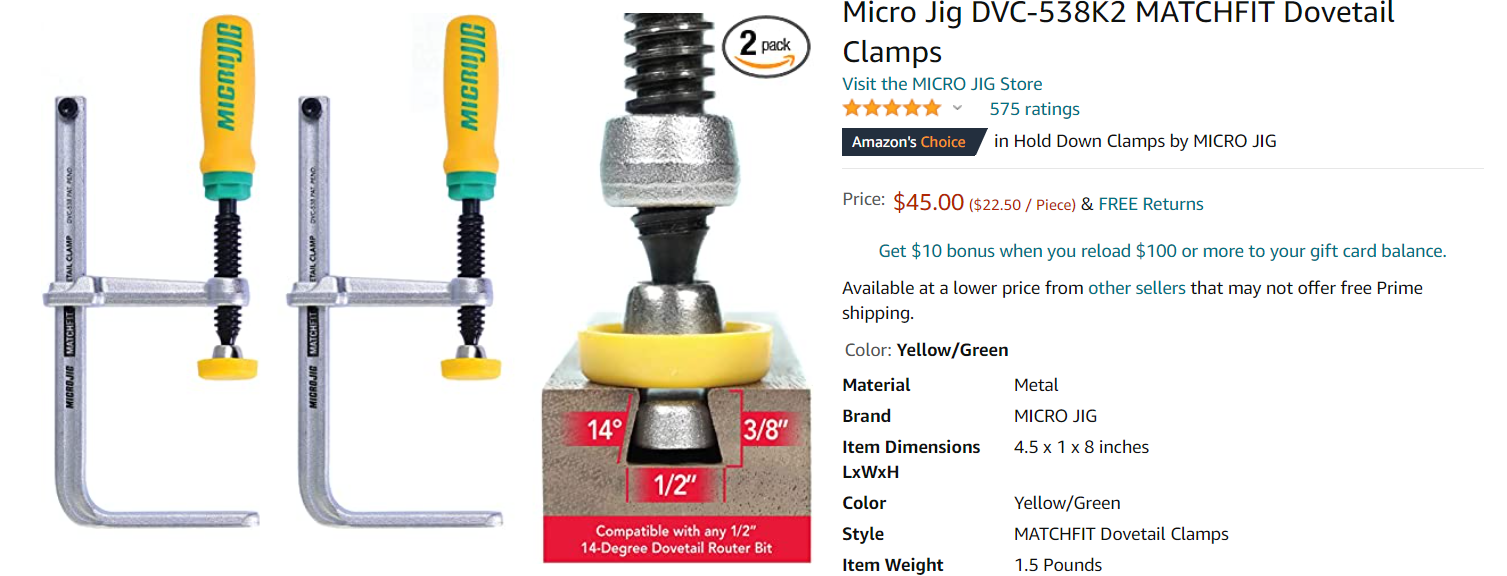

I purchased my clamps in 2018.  I made notes of my set-up to help me with future set-ups.   I used a 1/4" sq bottom bit cutting 5/16" deep and then cut the 14-degree slot with a 1/2" shank bit 3/8" deep.  Danl

I used a Jesada bit for my DT (anyone remember them?) cuts, though I have a couple of Freud in the same same...maybe I'll try one of them the next time.
