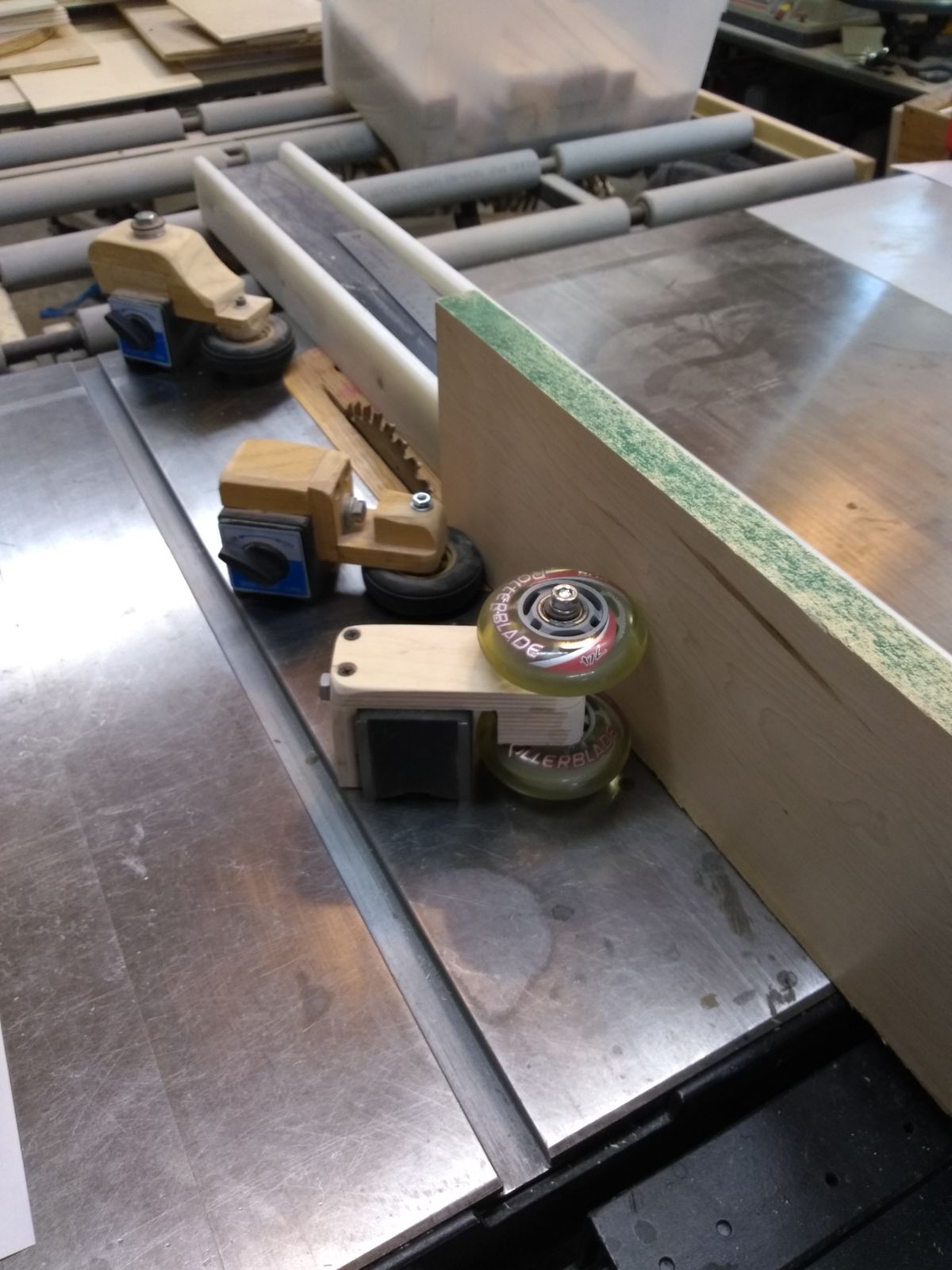

March 29, 20215 yr Popular Post comment_261993 I have worn these model airplane tires and wheels out and this is why I found a deal on 8 inline skate wheels. Softest I could find for this. This makes it much easier keeping the wood against the fence. I can still use the wood jigs I originally made for these wheels since they are the same size as the old ones. Report
March 29, 20215 yr Author Popular Post comment_262008 I've been using the 2 model airplane wheels for over 20 years and have been looking for more tires like what I already have but never found any. These came off the things hanging up in the shop and have been too tight for the price of new. The magnets came from Grizzly. I use one magnet when I'm repeat sawing same length pieces on the table saw and using the magnet as an edge to push each piece up to. Works better than anything else I've ever tried. Edited March 29, 20215 yr by Smallpatch Report

March 30, 20215 yr Author comment_262079 I show this use of magnets since I have lived here. Probably in lots of my pictures. Report
March 31, 20215 yr Author comment_262131 Gerald the same magnets I have used forever are 11.95 At Grizzly #2228 I think thats the number. Report
