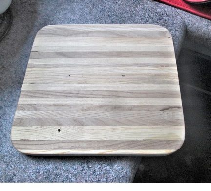

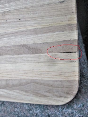

Both ends were a bit...off.   Then clamped up between the bench dogs...80 grit belt on the sander   herd of Cats took offense, and the panel skipped right over a dog, and did the splits on the floor....Fine....made things a bit easier...places that were too thick...ripped down a bit..glue joint was redone...ripped most of the Pine edges off...too thick, a big knot, and a hole..
beltsander and this old plane....soon had both "halves" about ready...flat, and jointed..

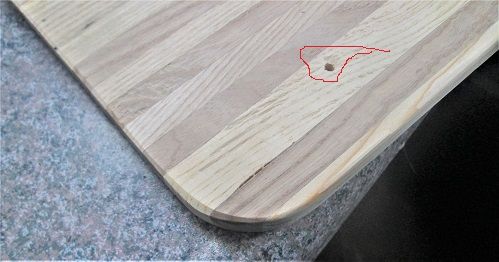

Board has been rounded at the corners, sanded and planed smooth,,,,edges were rounded over....awaiting a jar of Mineral Oil....after lunch. ( Crab Salad..)

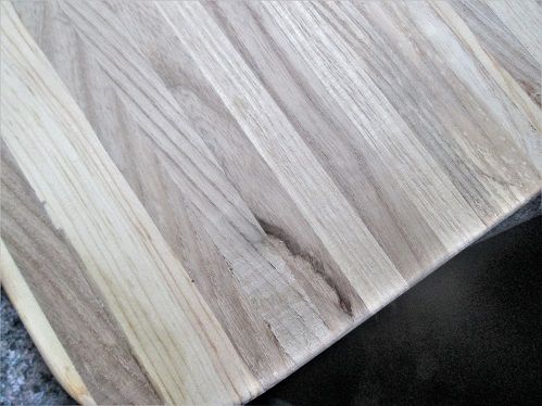

It do have a few spots of fancy grain...:ChinScratch:
And not so fancy stuff...:rolleyes:
hanger hole?   or...drain hole?:WonderScratch:

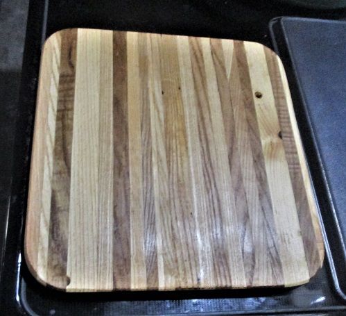

First coat is soaking in...
Brushed on, then wiped down...this is the topside, and..:ChinScratch:
This is the underside....I think.:WonderScratch:

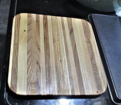

Will see how this looks tomorrow....plenty left in the $2 bottle.....have an older cutting board, as well....may give it a bit of sprucing up, too?
Not much of any pattern going on, just what seemed to look good, at the time...
