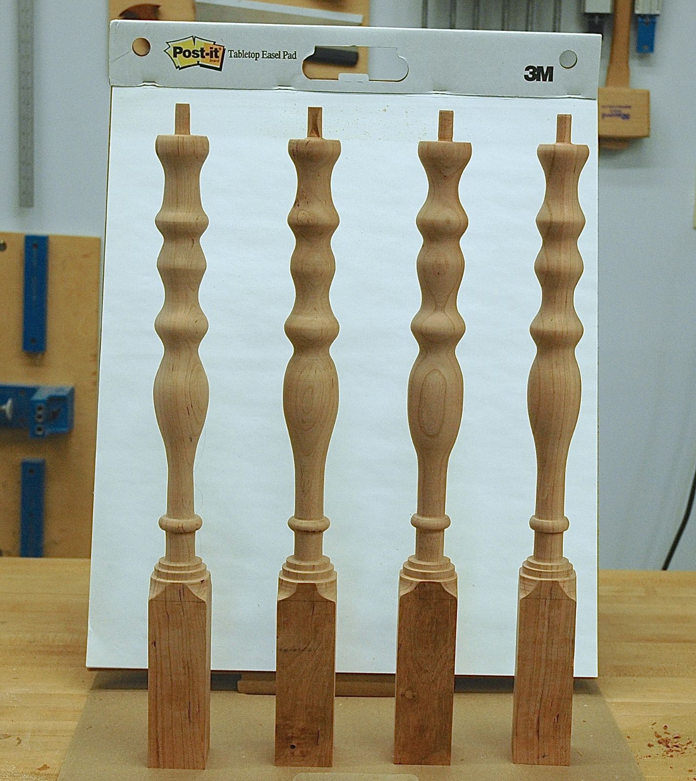

I have these 4 legs for a William and Mary table that I just turned (yes, I know they aren't identical) and i have a slight problem. The bottom of the legs (where the tenon is) didn't get parted exactly the same...so the legs are different lengths. The difference is slight, the longest one is 1/16" longer than the shortest one; measured to the bottom of the leg (not the tenon). The other 2 are somewhere between those extremes. I have a plan to even them out that goes like this: I'll saw enough off the top (the squared section) to make them the same length. Easily done with my miter gauge stop resting on the bottom, then shaving off the needed amount. Is there a problem I'm not seeing fdoing it this way? Is there an easier approach?

Fred if I were building a table I would wait till after its all together then set it up on something flat like the table saw and can check that way and trim which ever is too long. Lots of times it might be some other leg that needs adjusting by grinding a little off the bottom. This was a regular thing to do at a big furniture store I use to work at. And hardly any was ever perfectly level.

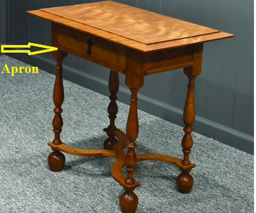

Putting the stop at the end of the turned portion and cutting the top of the leg is a great idea.  Go for it.
The difference will then show up at the apron and your design has plenty of room between the apron and the beginning of the turning so it will not be noticed.

That was kinda my train of thought as well. Thanks.
I agree with Smallpatch. Build it and then adjust the legs if needed. The floor is likely to have variations in it greater than 1/16”. You also will no doubt have variances in the feet when you turn them. You can try the feet on various legs to see if that will even it out before you glue them on.

But the part of the legs that are out aren't going to touch the floor. If you look at the picture above that Dan posted, you can see the turned portion in question is between the stretcher and table top. The feet I turned are off a little as well, and the suggestion of putting it on the floor and then trimming will work for those once the table is assembled.

My concern isn't that it won't set flat on the floor, I can fix that part later. The legs fit between the stretchers (which are a little complicated by themselves) and the table top. Now, if they are unequal lengths, that part of the construction won't be square. That's my concern. After the feet on on, I can certainly even them out on a flat surface. It's possible that the 1/16" wouldn't make a difference between the stretchers and the top but I just don't want to deal with any more problems than I have too. I went ahead and shortened them with the miter gauge, it worked quite well. I'm not able to do that with the feet, since they are completely round and I have no way to hold them steady with the gauge. Besides, like Dan'l said, it may rock on the real floor no matter how even I get things.
