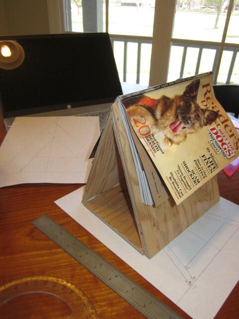

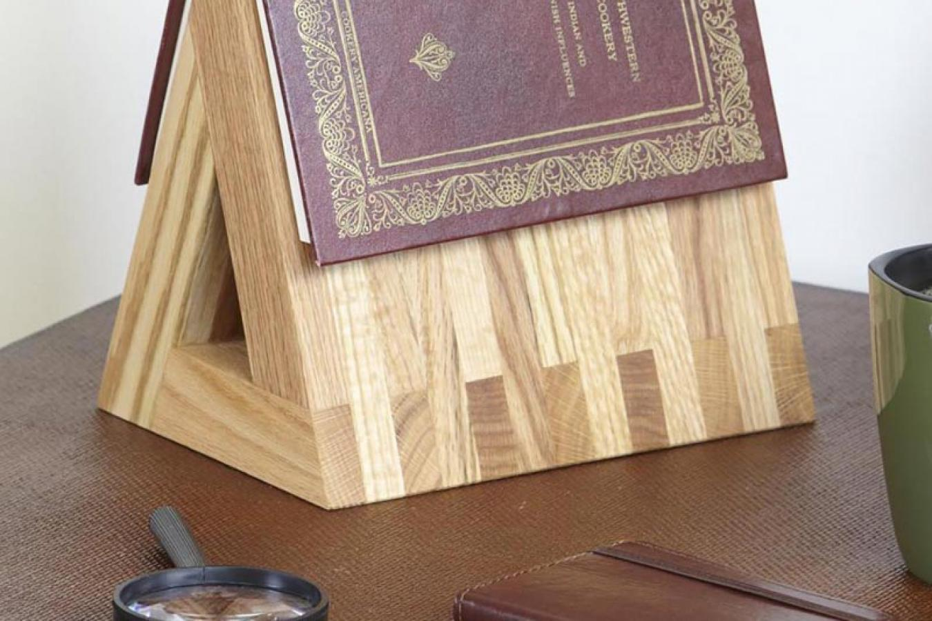

Got a request today from eldest daughter to make 3 of these for her kids that are always reading.   Now I need to figure out dimensions and angles
https://www.woodmagazine.com/project-plans/gifts-decorations/office-accessories/book-standtablet-holder-downloadable-plan?fbclid=IwAR3dwZYyuhfpUQuSixR2WxJo_ukM1HVvfRBRcqhEq6eK8XAMJpeEbzCKA8k

After much discussion and input, 30 degrees, 45 degrees, we settled on a Goldilocks 40 degrees.   Made a mockup of scrap plywood and looks good.   Used a tenon jig to hold the sides vertically and set the table saw angle to 20 degrees.  The sides will be solid so I can avoid having to cut 36 pieces of stock, gluing them together and keeping the joints tight.  After much time with a protractor and ruler, I found it much easier just to cut some scrap pieces and tape them together.
