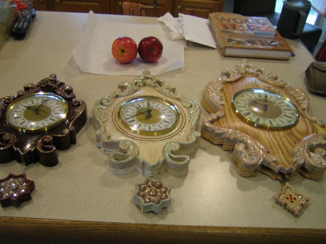

Here is a good example or using the same pattern only making it bigger each time for the next clock...The first one of these I made was the small dark clock then next I wanted it a little larger then the next bigger yet..and I still have that same picture I I want to make the same one only different for the forth time...

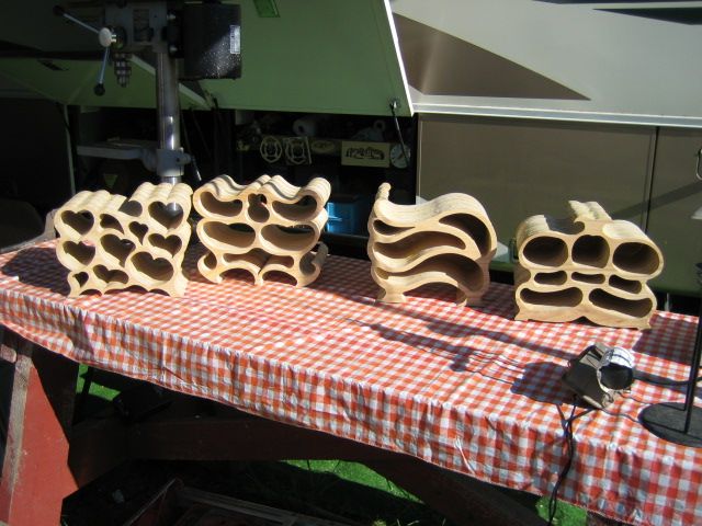

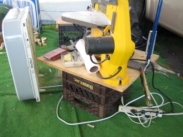

The first picture was taken in Colo. Use to we would spend 3 months during the summer at an RV park and I would take  my scroll saw, band saw, small table saw and all the stuff it would take to do wood working while enjoying the cool summer days up high in the mountains. Only this time I forgot to take the box fan which I use all the time I am sawing so a box fan was 20 dollars at a Walmart and the filter was almost half that much but that fan is important.
Thats a Gandy milk carton for a table for the saw and another milk carton with a piece of plywood was my seat for sawing.. That year I also took enough hardwood already sized for the 4 jewelry boxes I made that first year in Colo.
  I have made the scroll saw a part of almost all the things I have built since I have retired 21 years ago and I hardly ever build anything with flat wood for part of the finished project. Building things with flat wood and having to please the customers I finally shucked when I retired. I told my wife now I get to do things my way and I will say much more pleasant than all my working life...
