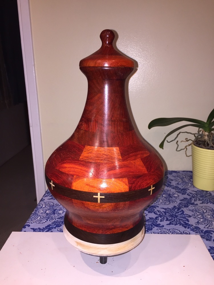

February 6, 20215 yr Popular Post comment_257304 I have only done one and that was for my mother a few years ago. This one comes with a very funny story that my mother would have appreciated. We went to pick up her ashes and they needed to transfer her ashes into the urn I turned. Due to the way I had turned it on the lathe I used a live center at one end and to make that happen I drilled a 3/8” hole in what would be the bottom. Plan was to plug it with a dowel afterward but we sort of got in a hurry and I forgot the dowel. So it’s a very somber moment, the guy comes out to a sitting room and takes the urn while we all wait for him to return. He returns after about 10 minutes carrying the urn, and leaving a small trail of ashes as he walks. He was mortified but my older sister saved the day by remarking “ This is so mom and dad. This is something only Paul and dad would do.” My dad was a turner also. We all laughed until we cried and the guy at the crematorium thought we were nuts. They put an address sticker over the hole, swept up mom and put her back in the urn and we left. We all laugh about it to this day. Paul Edited February 6, 20215 yr by Masonsailor Report
