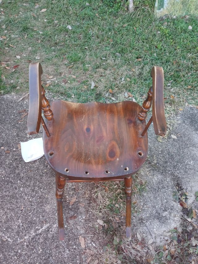

A neighbor brought this chair to me about the time Hurricane Sally came in September.  Finally, got to it.  This is what I received.  At least, all the pieces are there.

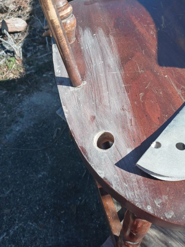

The upright posts had dowels that were broken.  And, this chair has lots of stories.  Will repair from the seat pan up.
What a booger bear to get apart.  Took awhile.  Now, we can get some progression on.

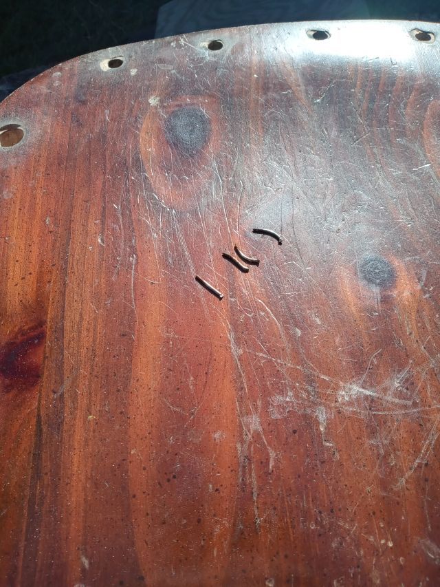

Doesn't look too bad.  Will sand out the mortises and tenons.  This poor chair has seen a tough life.
The nails have been removed, but one slat did break.  Not a problem for Titebond III.

Mortises are sanded out sufficiently.  Just removed the glue.
Sanding with 180 grit, this appears to be a poly coating.  Will test before trying to put on a varnish.

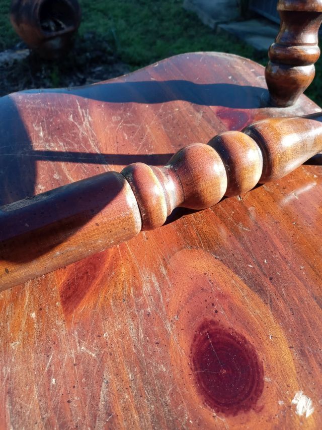

Obviously, the rounds are not correctly sanded.  It is obvious that this is a production job with rotational sanding, leaving the sanding marks around the spindle.  Will try to sand with the grain and make this correct.  Going to take some time with hand sanding.
Looking at the seat pan, it appears to be pine.  I do believe the seat pan is pine.  However, the rounds are all some form of cheap or low grade oak.  And, this other spindle indicates that the production is still a sanding while the spindle rotated on the lathe.  No hand sanding or sanding with the grain.  Ugh!

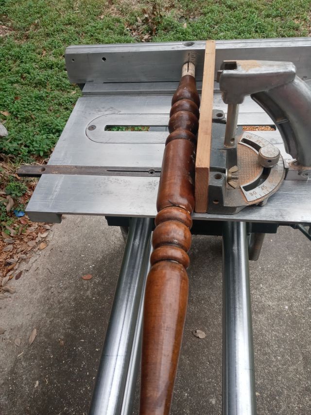

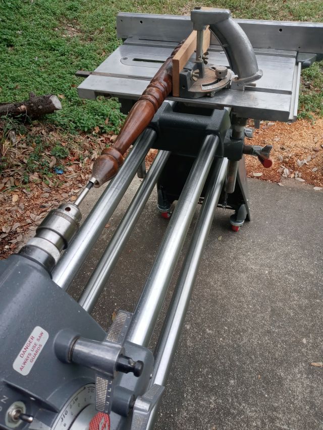

Setting up the boring of the old dowels was a bit of a challenge.  I thought of using some clamps, but just used my hand to clamp it to the mitre and had our oldest granddaughter pushing the bit while I held the spindle.
Looks pretty good.  Had grandson use his geometry to align the markings to guide the drill bit.

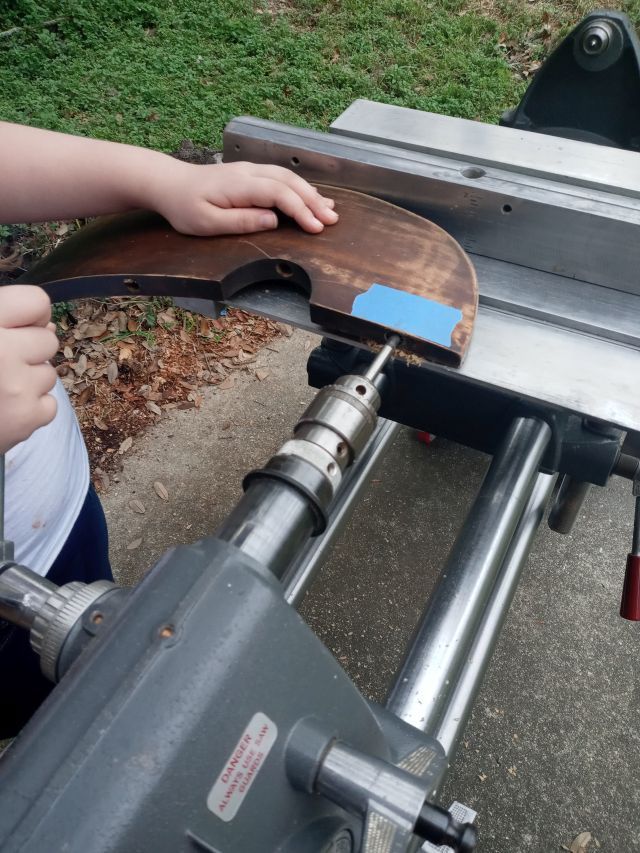

Granddaughter holding after drilling the hole.  Tape on the head board (not the correct nomenclature) was the guide as to the angle of the bore.

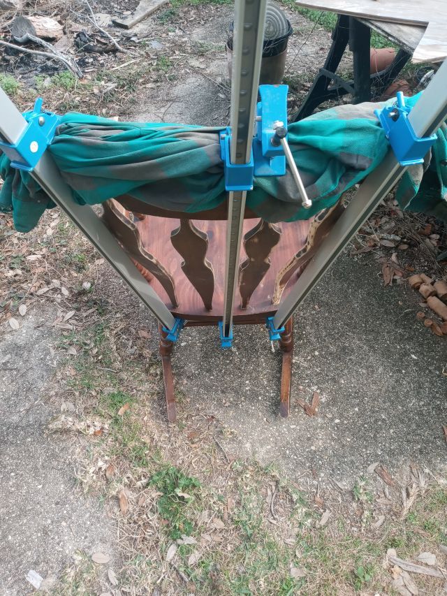

Clamped with dependable HF clamps.  I love these because they rarely flex.  Almost as straight as pipe clamps, unlike bar clamps.
The 3 clamps pulled the back away from the arms.  So, 1 clamp on the front brought the back into the correct spot.  Screwed the arms to the post.  More sanding and then will start my weakest procedure--finishing.  Will be ready by the weekend.  Going to get cold after Wednesday.  So, will try matching the stain and will try to see if shellac or poly.  Last picture coming.
