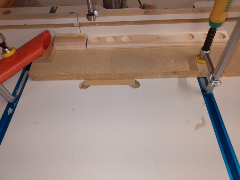

Inspired by Artie, I'm in the process of making 4 Kissmas trees from the current Woodcraft Magazine.  One for each of my three girls' families and one for us.  So they'll be set up for next Xmas season.  The earliest I'll get together with any of the kids is New Year's day.  One set probably won't see until late summer.
I had some unused select pine that someone gave to me when he quit a project, so that's what went into my project.  I ripped into the 1 1/8" strips, then planed down to 1/2".   30 of them a bit over 36" long worked out.
Drilled the 1/4" holes, using a newly-made drill press stop.  Wish I had gone up a 32nd or so as it took some "persuasion" to get them thru 30 pieces.   But got the threaded rods cut to rough length and in.
Laid out to "zig-zag" the cuts.  This reduces waste and optimizes material so I could get all four from my pieces.
Built a big siding cross-cut table (again using some leftover stuff) to use with my MatchFit clamps and it worked great.
I don't know what the angle is, but only the top and bottom width.  So marked them on the stock and lined up to the edge of the cut-off table.
Did some sanding and took apart, numbering each piece 1-30.  Set up to drill the recesses for the kisses.  Likewise, used a spacer.  Figured out which levels took 2 holes, which 4 and which 6.
I think I will work hard to keep each "set" together thru drilling, final sanding, finishing, and assembly.
