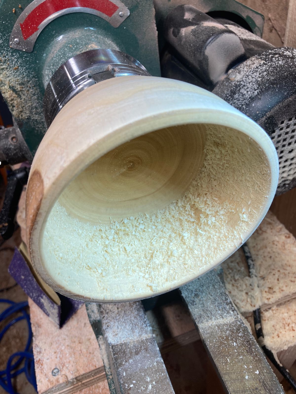

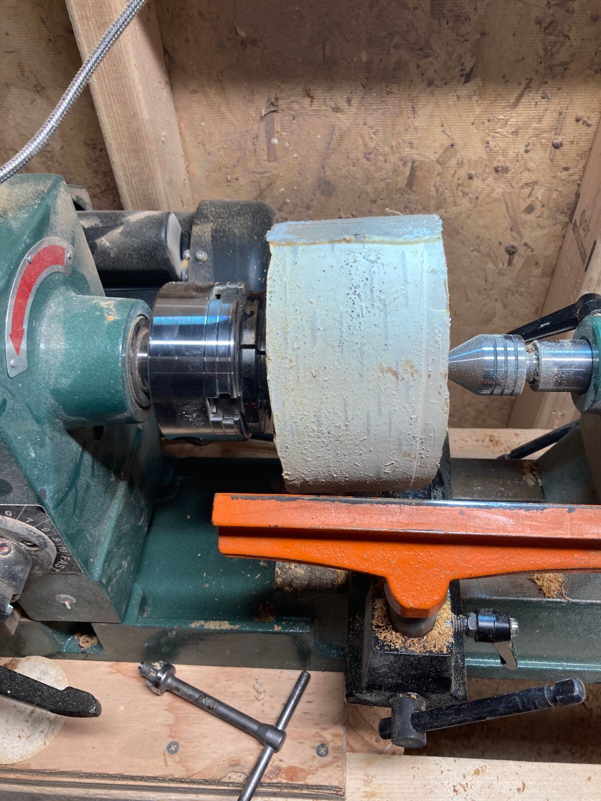

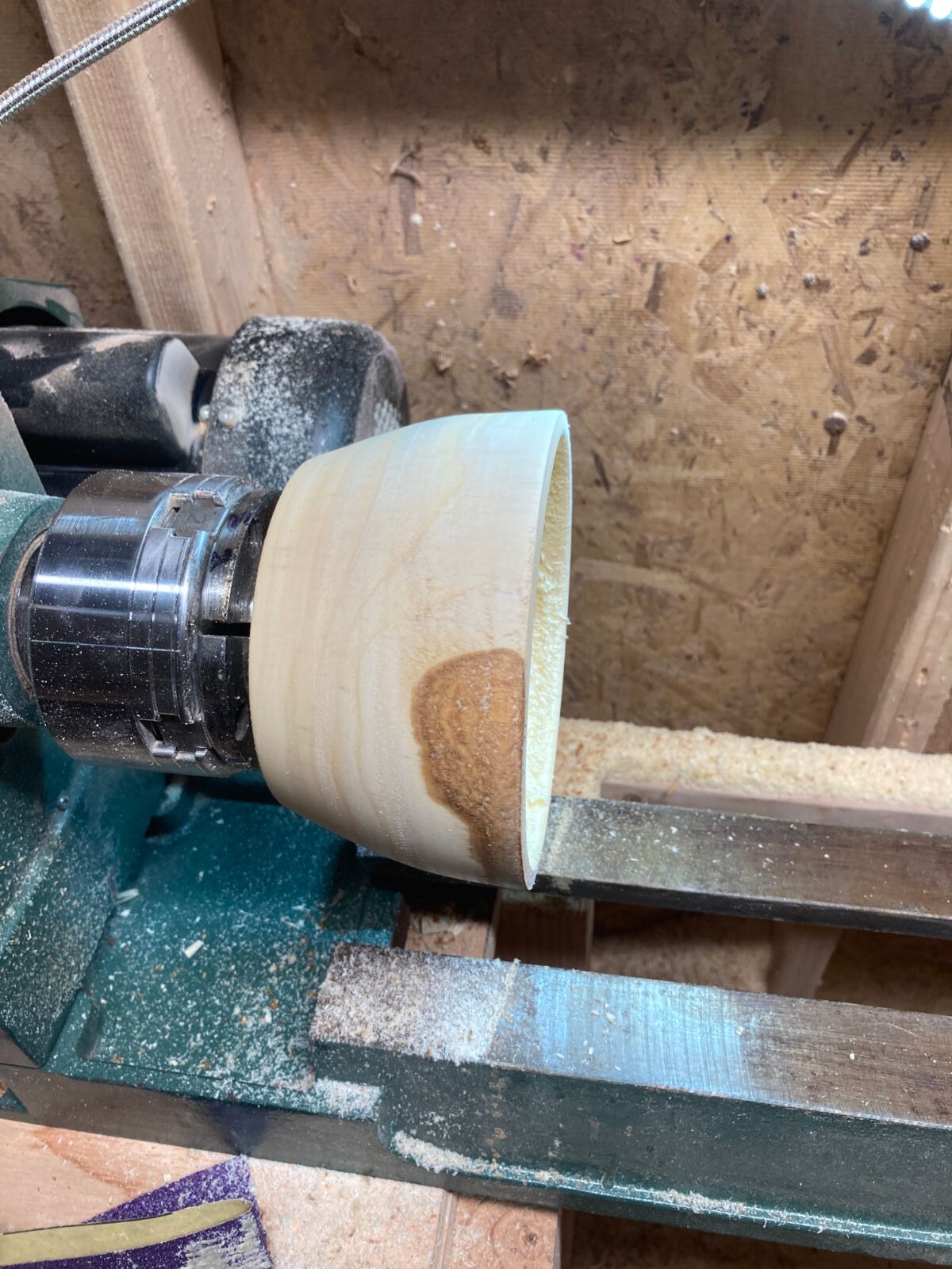

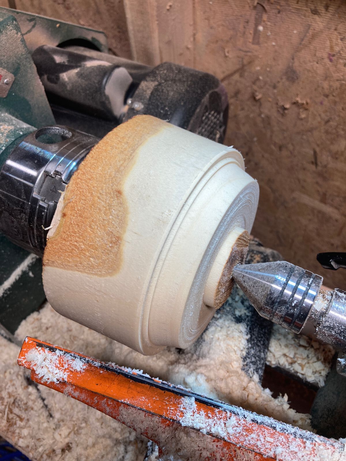

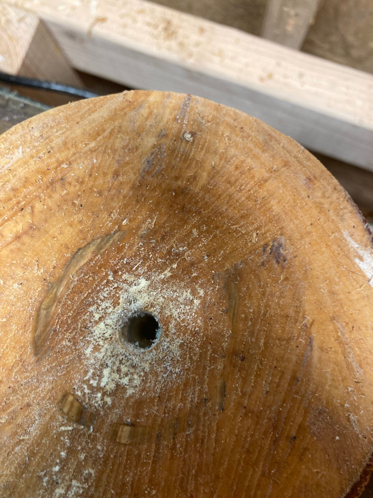

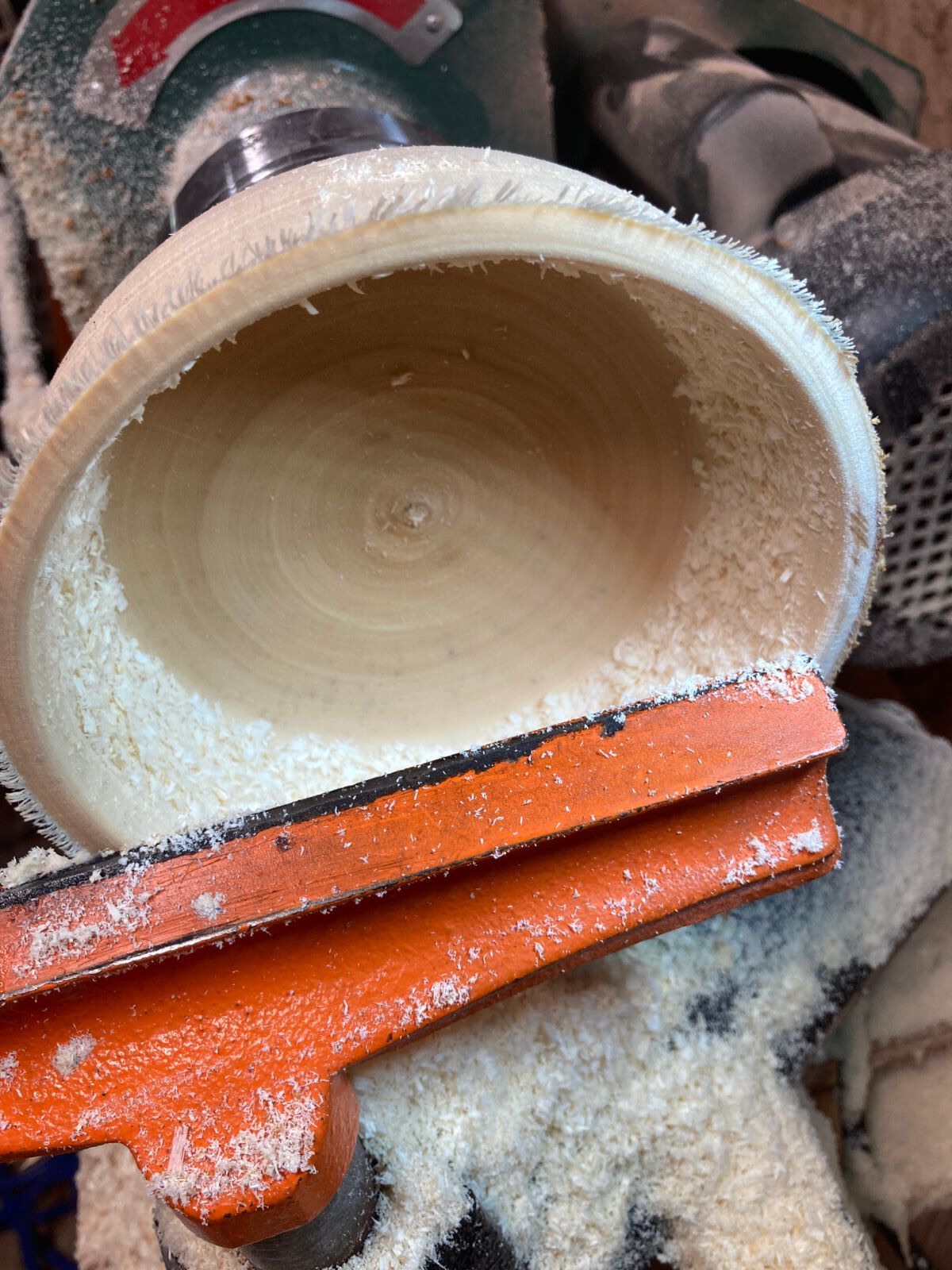

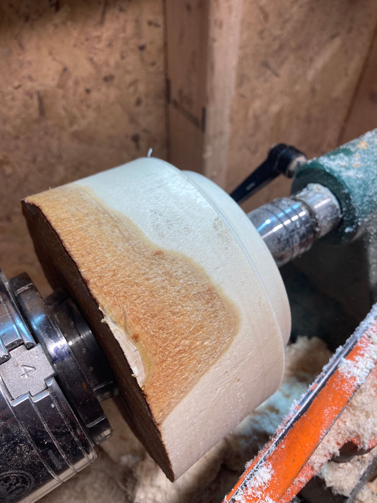

December 16, 20205 yr Popular Post comment_251372 So I decided to go small with this. With one of my neighbors handing me 5 birch blanks for about 5 bucks each I was stacked about it. I sealed them up and today finally while waiting on my new band saw to get here I decided why not I may as well go for it. I drilled out a hole in the one of the birch blank pieces and mounted the wood worm into the chuck and went for it. For my first time turning green wood I did not sand the bowl fully on the outside or inside as of yet not sure if I should just let it dry before sanding or not. But for the first go at it was interesting and I think so far successful. Interestingly enough the wood worm worked quite well.k A little bit more confidence in the wood worm screw now at least. I'm also glad that I didn't have the birch wood piece blow up in my face and it wasn't rotten. Report
