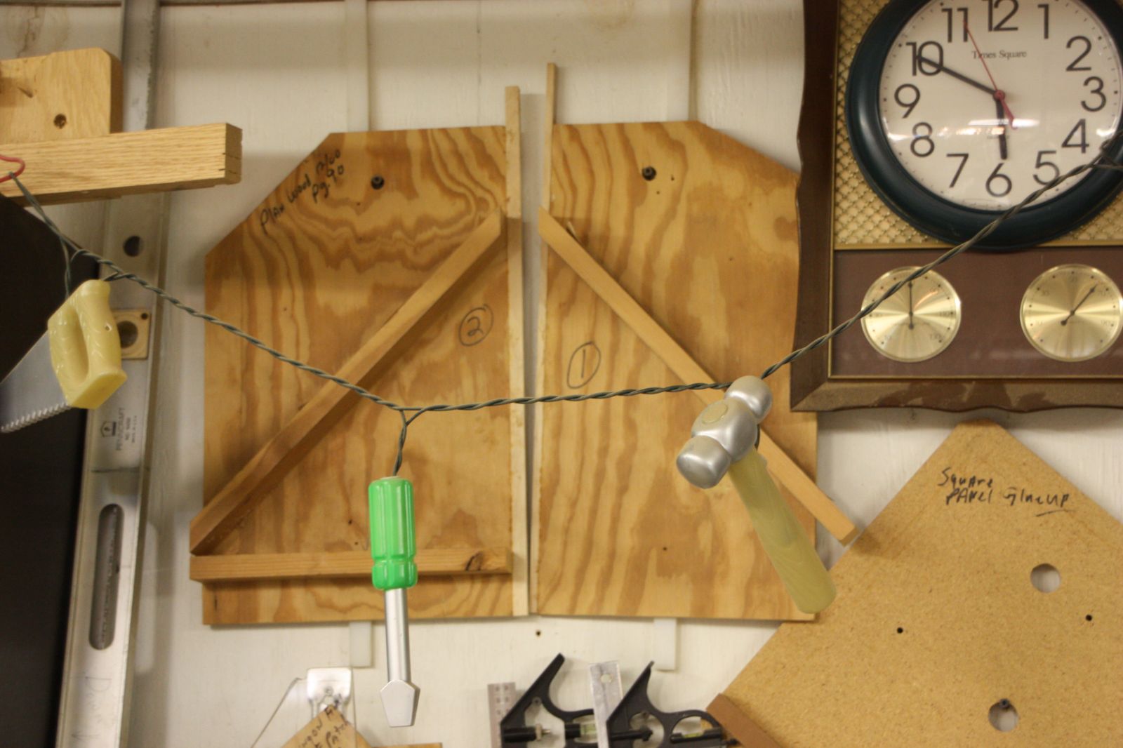

I used to have same problem.  Made this jig so no setting of angles.  You cut side A, the other side B.  Assemble all the A's to B's.  Bam, always equals 900
I have one of those but mine is a two piece , Left and Right.Got jigs hanging all over two walls and one of the guys in turning club said he loves to come to my shop and see all the jigs.1341428874_TS45degreesled.JPG.eaab75e8f48bb0d9d8cbe39fea6e1a77.JPG

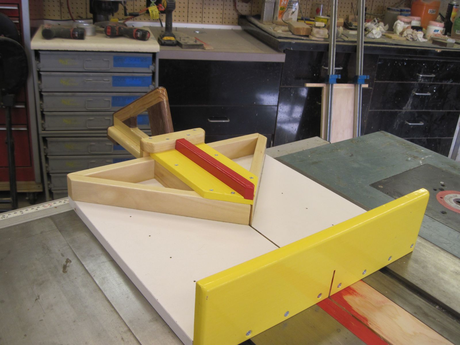

My jig is similar to Gunny's with the addition of a lexan shield.
