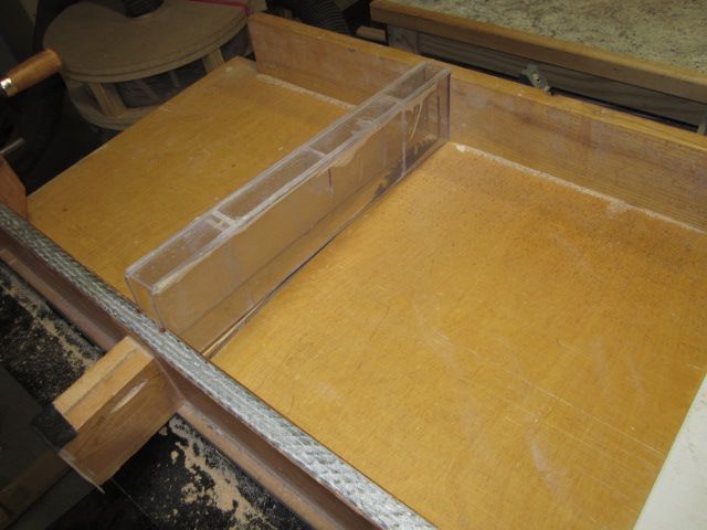

I have a well-used sliding crosscut table.   I use it all the time.   I'm wondering to rehab or re-make.  The major issue is the kerf is wide enough that it's hard to use it as a guide as to where the cut will be.   And I have some Matchfit clamps that (might?) be useful to add in there.  Though probably 99% of cuts are at 90 degrees.  It's a Kelly Mehler design with a nice Lexan guard that slides up and down and holds the piece when needed.  The fences are 1" thick patternmaker's plywood and the base is 1/2" baltic birch

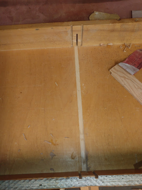

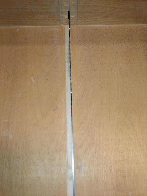

Well, looking for something to do yesterday, I expanded the slot with a dado blade, cut an insert from the baltic birch that the sled base is made from, glued it in, and today re-did the slot.   I think it's going to work fine.
Insert in
kerf cut
