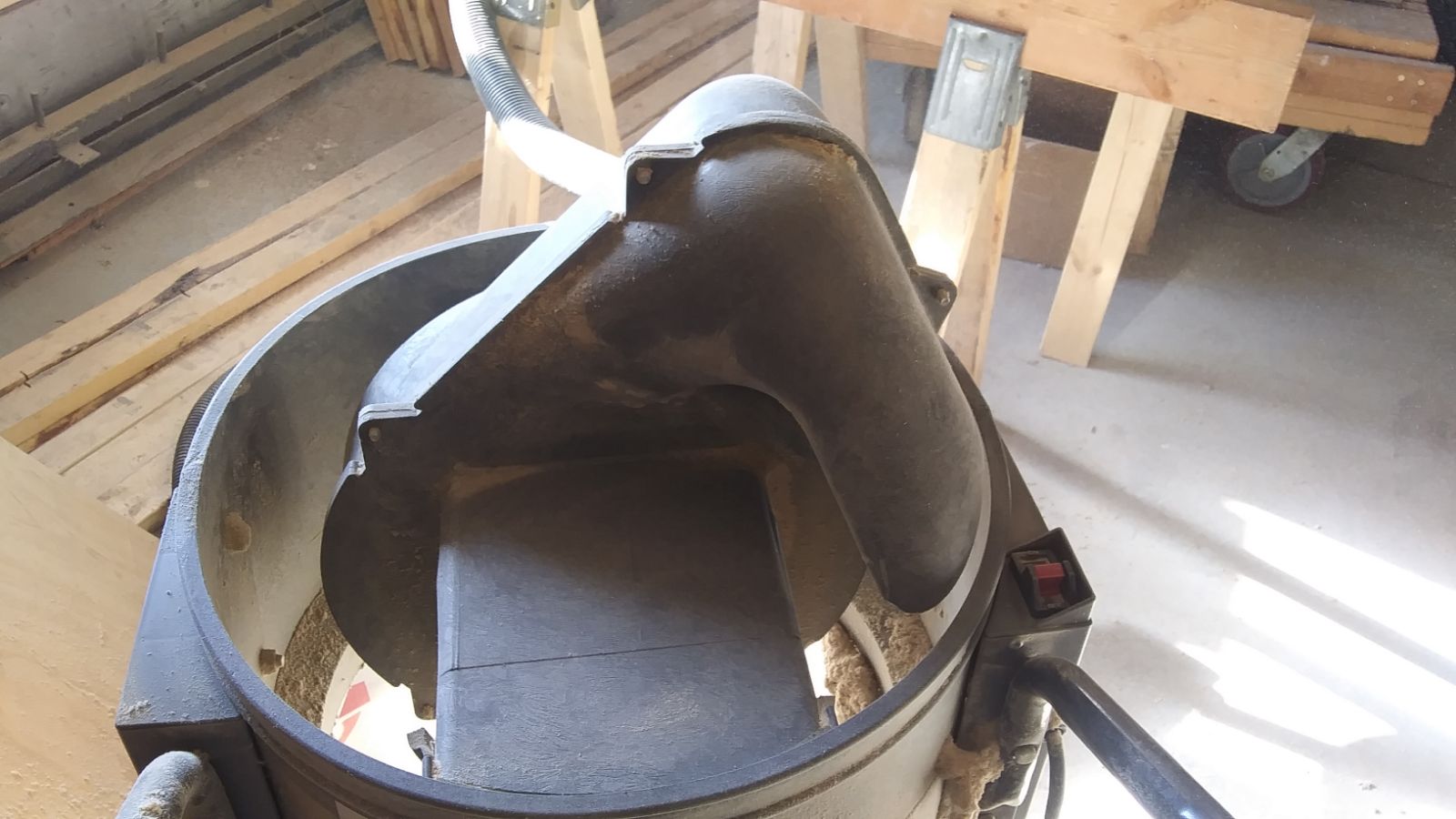

December 6, 20205 yr Popular Post comment_250091 38 minutes ago, Artie said: Yes. I guess the older models had a 4 inch port behind the Shopsmith emblem on the front,nbut the new ones don’t. You should probably empty the bag. The bags only need to be replaced if they get torn. The top felt bag is the bigger issue. It gets packed with sawdust and the airflow suffers. You can fluff the bag to knock off most of the "cake" and then use a small brush (I use a $ store 1 inch brush) to clean the housing inside. I use one of these at work, I'll take a picture Monday and post. Report

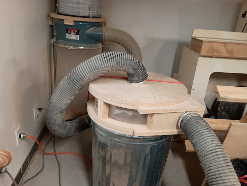

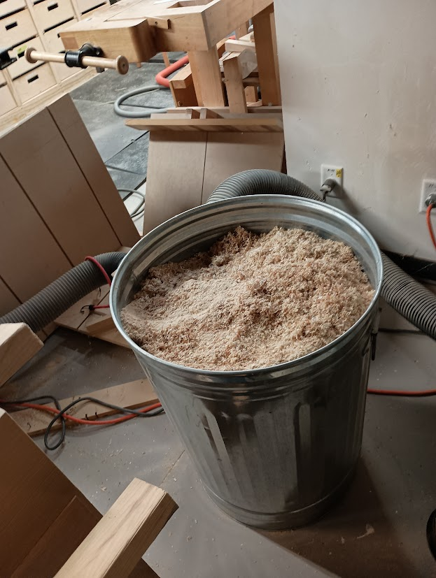

June 6, 20251 yr comment_357261 I have a (Jet) dust collector that had cloth bags above and below. I heard the same thing about not cleaning them. But the bottom bag was a pain to take off and get back on. A few years ago, I got a Wynn filter for the top and it came with a clear plastic bottom bag. I like it much better. I had to make a "donut" as a transition from the filter to the unit, but it was not a problem. A significant advantage was that I made a Thien pre-separator for a 30 gal garbage can. I empty that about every 6-8 weeks, depending on what I'm doing and I still don't have more than a few inches in the plastic bottom bag. Report
