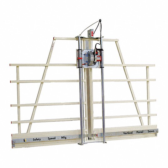

This is what we use for cutting table tops at the furniture bank.   Initially, I thought it unnecessary.  But it does a good job.   But probably too much for a garage woodworker.  Us old f*rts have a hard time moving those 100 lb sheets around

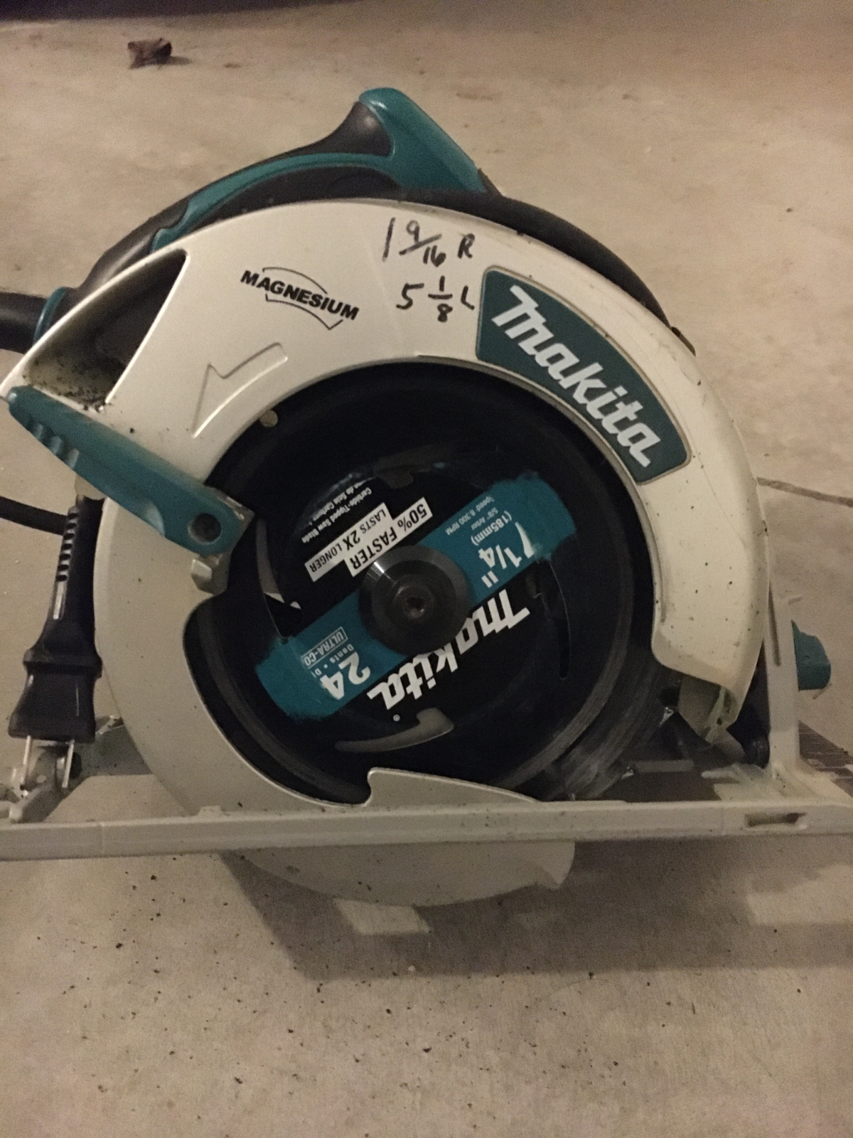

If you buy more than one sheet, you can use the factory edge from one as the guide to cut the other, with appropriate spacers.
Also, I've found that you need a circular saw with a good thick shoe plate.  If it's just 1/8" flat metal, it can slide under your straightedge.
I was never so smart that I wrote those dimensions on the saw.
Can you believe that?
