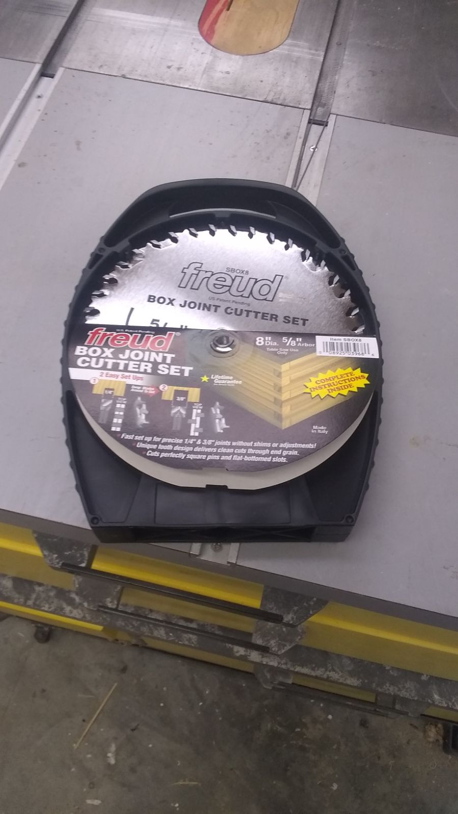

Ordered this one this evening.

Hey Gunny, please be prompt about giving this set a whirl and posting up the results!
Arrived today and installed this evening.  Tested of course and was pleased with results.  Have to work on the jig.  Thinking I would like a adapter plate for regular jig that I just slap on the front quick when needed.  Have to work on the engineering portion of that idea tomorrow.
