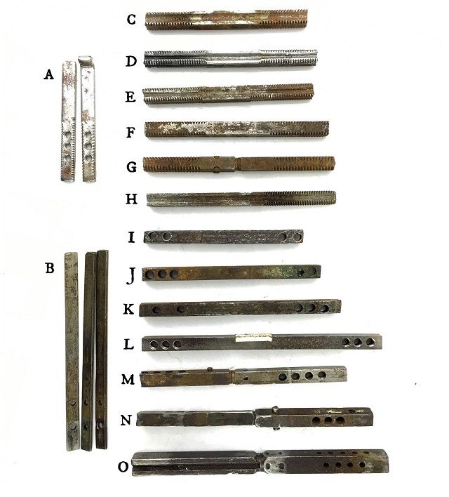

Neighbor gave this to me
My neighbor brings me this and tells me he is SURE that I will know what it is.  NOPE!  Not a clue.
No markings anywhere, used a magnifying glass to verify.  Looks exactly like he brought it to me.  Threads are 8 x 1.25  center screws in and out.  Honestly have no clue what kind of tool it is.
Vintage door knob spindle.  Never saw one quite like it but here you go.
Thanks!  Now have no idea what I might use it for but at least I know what it's purpose was originally.
I have experience with some old doors and knobs like this but the spindles were always solid like some of the specimens.  Can't figure the purpose of the two pieces threaded together.
Yeah that had me stumped.  Thought it might be a special tool for something, or a set up block.  Only reason I can figure it might be adjustable is if it fit commercial doors or something.  No real idea on where it came from.
Edited by Gunny
The knobs are threaded and screwed onto the spindle and locked into place with a set screw.  The the thinner the door the further the knob was screwed on.
If I recall correctly, the screw parts go into the knobs and the square fits into the lock.  There was a screw that you tightened onto the spindle.  It's been a few days.
Now, can you use the threaded part to make threads inside soft metal or wood.  Otherwise, it is basically worthy of recycling.
Dang, Dan posted my thoughts.  Way to go, Dan.
Edited by FlGatorwood
Think I will tell neighbor it is a part to an Apollo capsule.  Let him chew on that for a bit.  :throbbinghead:
Threaded in the middle, to adjust for thicker doors....
Doors in old buildings were often built by the owner, with no "standard" thicknesses. This particular spindle would allow for any variation.
John
How far the knobs were threaded on compensated for door thickness.  The center screw wouldn't add much adjustment because both pieces still have to be in the latch hole for the knobs to work.

Well isn't that interesting.  Learned something today, time for a drink.  :D
Amazing what one can find on YouTube.  Sure wish it was there when I was young.  Of course tearing stuff apart to see how it works has its own merits.
That's so true, both points. But there's folks on utube doing things I wouldn't do, like cutting apart expensive tools (someone did that to a Festool track saw) to show the construction, etc. I'm quite happy to leave such stuff to others.
Yeah my boss finds me doing that to parts we replace all the time.  Now with an apprentice I can say I am just showing him...  :ChinScratch:
