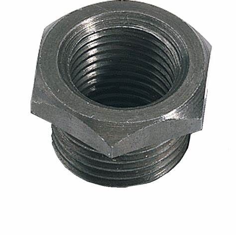

November 8, 20206 yr Author comment_247440 Morse arbor is correct. This is convenient when drilling a lot of holes in wood, just remove the bit and insert a short dowel in the thread side and tap the plug until it pops out. They do make an adapter to fit hole saws with the larger threads. Report
