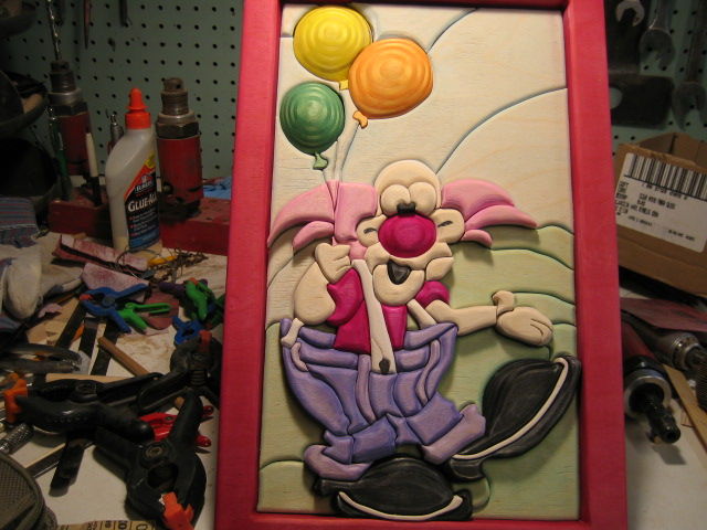

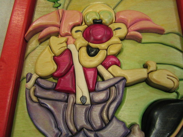

October 26, 20206 yr Popular Post comment_246408 Following the lines is not all the important. They will all fit back together like they should. Then when you spray a little clear on the subject some of the colors will change anyway. Report
October 26, 20206 yr Author comment_246409 Or you can keep it flat sheen with spraying satin if anyone can still get clear flat lacquer.. And Sherwin Williams might still stock the flattening agent one can add to any clear lacquer. Edited October 26, 20206 yr by Smallpatch Report
October 26, 20206 yr Author Popular Post comment_246410 Once you cut out all the pieces put it all back in the frame then decide which pieces should be lowered... Then marking all the pieces on the back side take the pieces to be lowered to the band saw and it is important on cutting away the top sides of the pieces and throw them away...This way all the pieces will still fit each other like they should. You now have a good start making the clown come to life. Now some of the clown needs to be lowered maybe even lower than what you did with the band saw...kinda like the three balloons for I thought they needed to be three different heights than the surroundings???? Edited October 26, 20206 yr by Smallpatch Report
October 26, 20206 yr Popular Post comment_246414 12 minutes ago, Artie said: Yeah Al, He kinda sets a high bar. Did I mention I was not much for heights anymore? Report
October 26, 20206 yr Author Popular Post comment_246419 Hey guys the first time I made something like this turned out to be crap. The only thing I made in a long time was the sea shells that actually had me smiling.......and it started with a piece of paper being printed on a cheap printer and I had the printer make the size I wanted it to make then the scroll saw did the rest....There was nothing wa-la about grinding the shape on a piece of wood that the scroll saw did the shaping...I was just following a line with the saw.......all these different shapes were done with me holding the piece of wood against sand paper or carbide that had been sharpened to do the cutting... Another piece of the picture I was working on came from the air brush connected to an air compressor....and I will say it does take a little from my very small brain for it does tell me when and how much to keep the little button on the air brush pressed in and when to let go and rest my little finger...The color was water based paint so any amount of thinning was not that important for if it is mixed thick it don't take as much spraying as if it was thinned too much which might take ten times longer to get the same darkness from each color. And I compare my using rotary tools to do my carving for I don't have that much time left so I compare using carving knives to cut away wood equal to me going back to riding horses for my transportation. Maw taught me better than that! "Good artist copy; great artist steal,"-----Picasso Report
