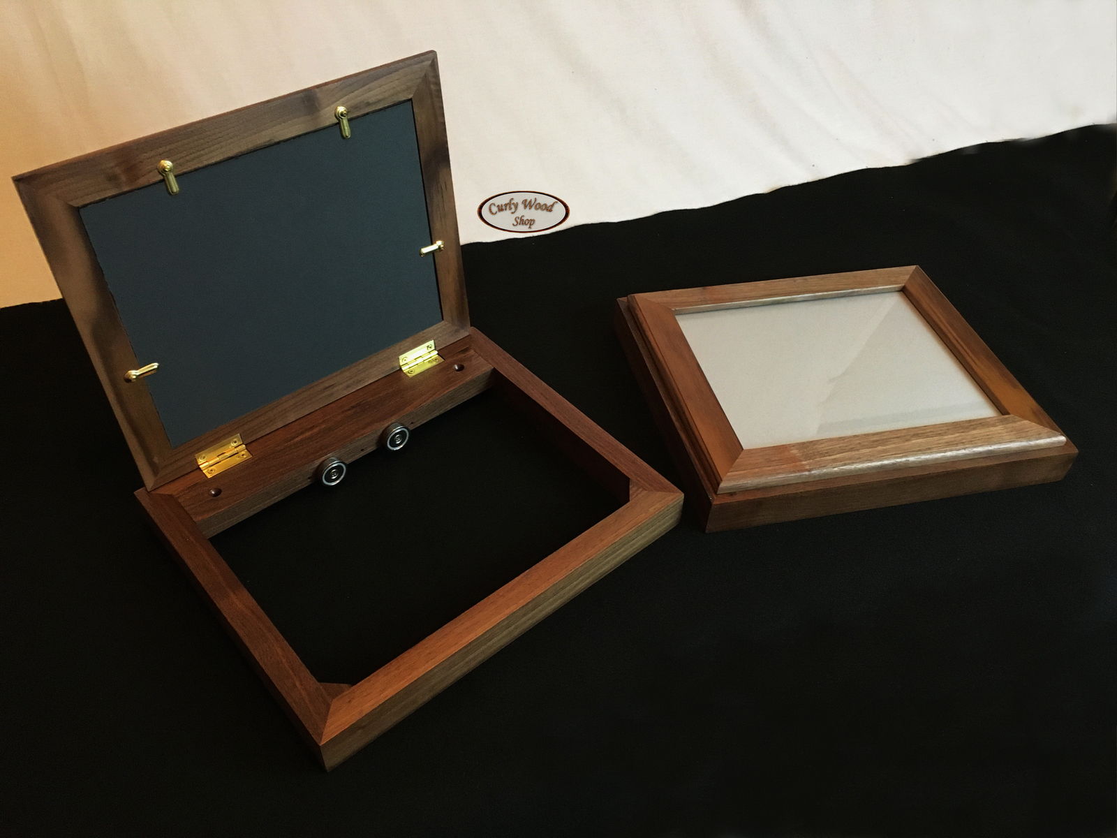

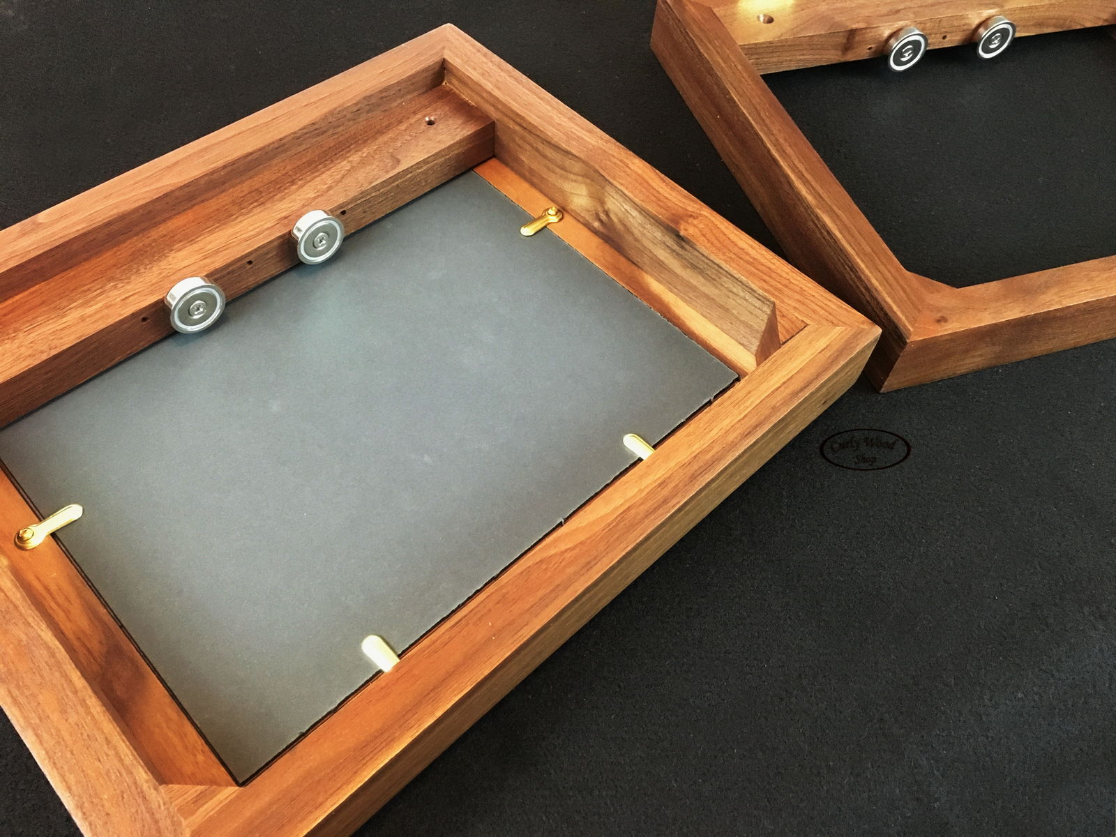

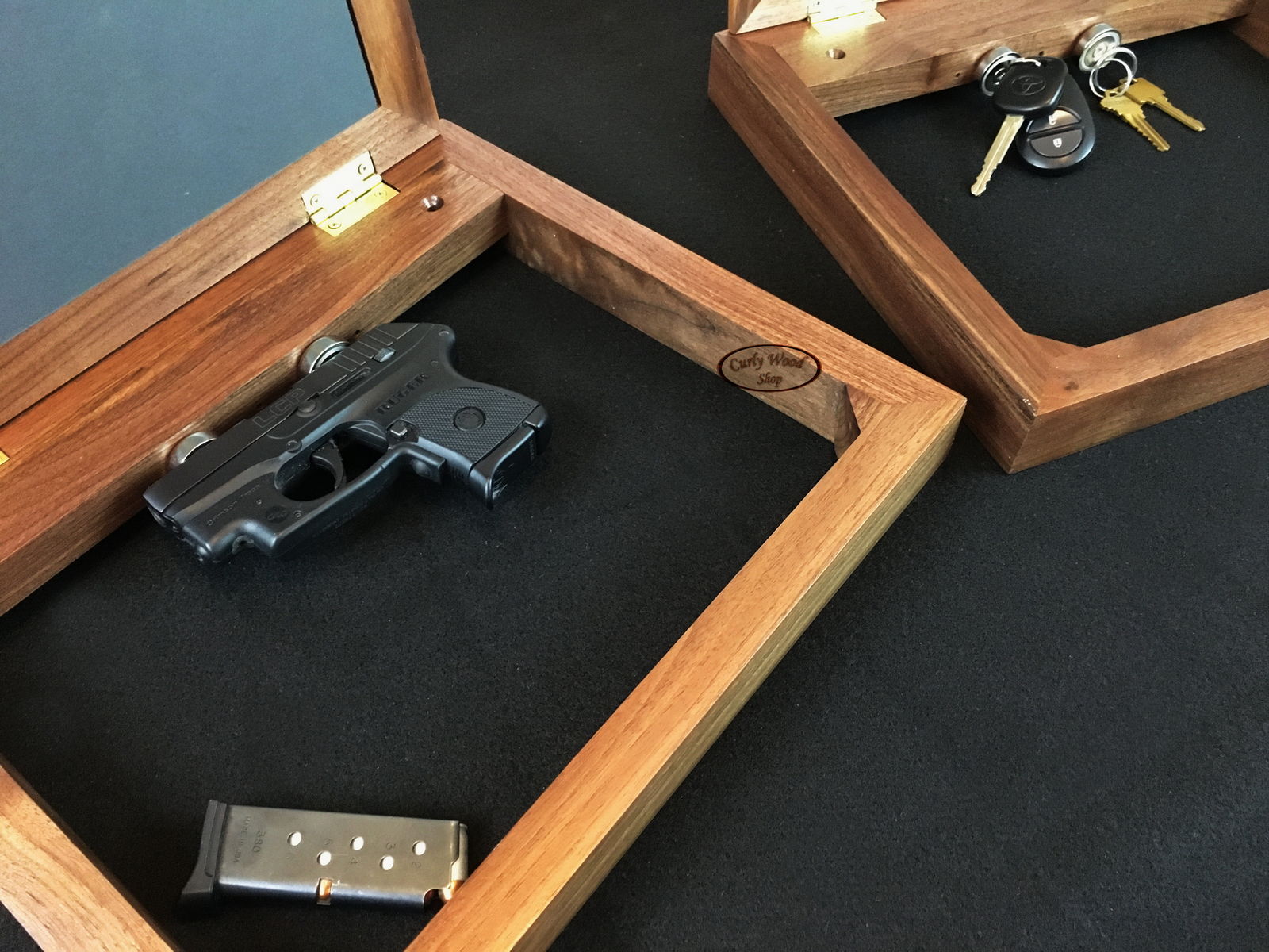

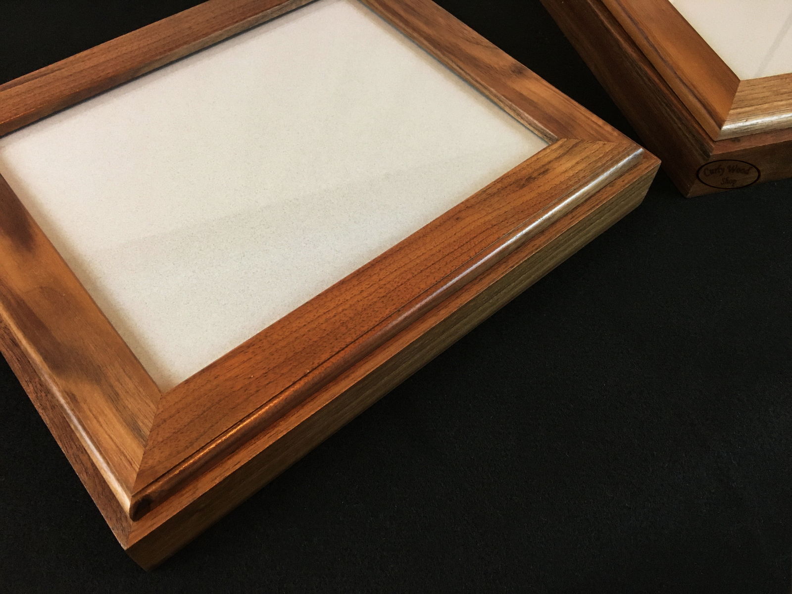

September 24, 20206 yr Popular Post comment_243337 I built two of these for a friend and just finished them today. They're about 10" x 13" x 2" and made of Walnut, finished in Nitrocellulose lacquer. The frame holds an 8x10 photo. David Report
September 24, 20206 yr Author comment_243341 31 minutes ago, lew said: Sweet! I really like that magnet idea Thanks! Those magnets are rated for 60 lbs. holding capacity - each! Pretty stout. David Report
September 24, 20206 yr comment_243344 Very INTERESTING. Am I correct that the hinge does not show? I have seen this type thing that pulls down to reveal the box but I think that type has to be screwed to the wall. Which brings up the question of how to mount this as I would not want the frame to fall when I grab the firearm? Report
September 24, 20206 yr Author comment_243351 At a normal picture hanging height you'd be hard pressed to see the hinge barrel, Gerald. I'd say less than half of it sticks out the top, couldn't avoid it and still have the picture frame open to a full 90°. For mounting you can see the two countersunk holes on the cross member where the magnets are located and they'll screw it directly to the wall, preferably hitting one stud. Whatever weapon is stuck to those magnets is going to require a pretty good pull to break loose so the mounting needs to be firm. David Report
