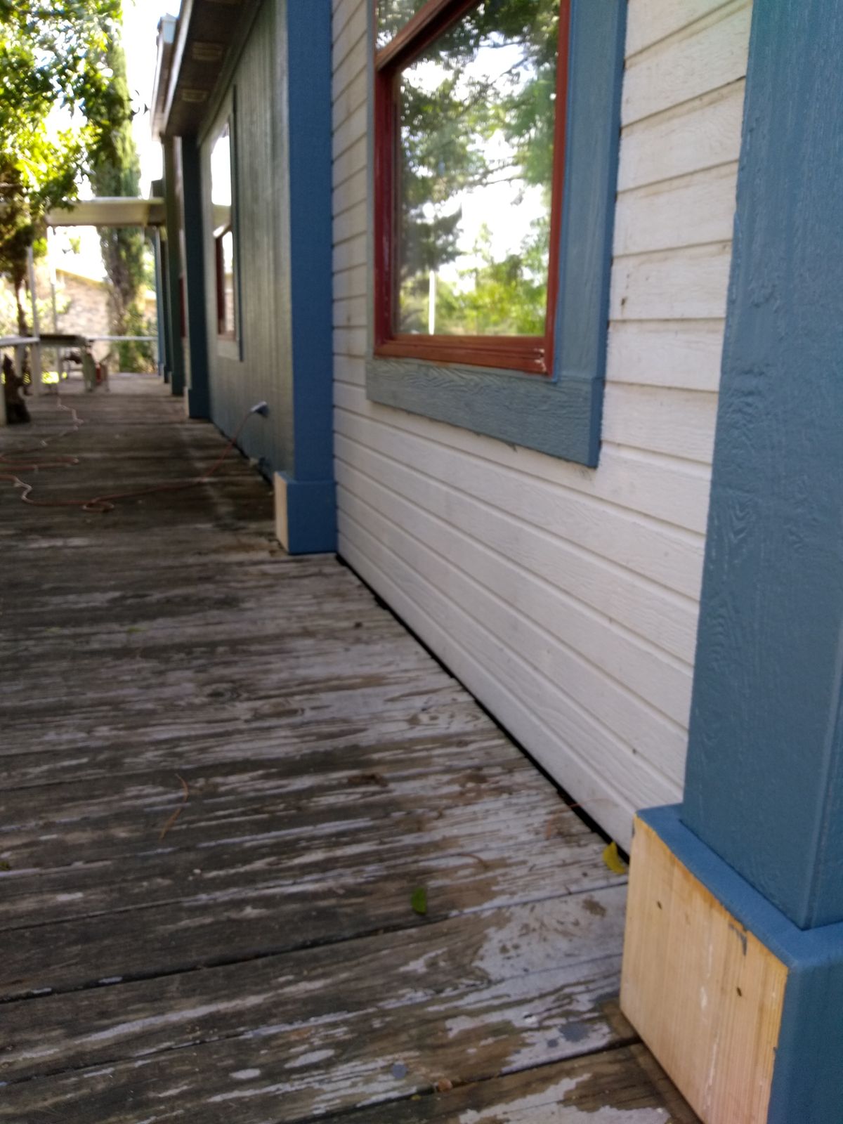

September 24, 20206 yr Popular Post comment_243399 And right now I am working on a different type of decay. I made a taller base for each column this morning and will use quarter round to cover the gaps. This is 21 years worth of wear and tear with no repair for that length of time. Wife said I want the house to look good if you die!!!! /And the person who invented paper wall board and water base outdoor floor paint should have his ba--- cut off. But now I knew some of what I was getting in to so yep it was all my fault. I put oil base out door type porch and floor paint on two decks and I ran out of paint and was fixin to go get more when brother in law said hey I got a full 5 gallons can of water base out door floor paint and you can have it free....but I don't like water base anything for outdoors....but they have made it better now.... oh sure!!!! the other two decks the oil base never flaked off anywhere . It final wore off from foot traffic. All three decks are about 3 foot off the ground. She did paint all the outside walls some times ago but I was busy and didn't help on my part of the repairs... Edited September 24, 20206 yr by Smallpatch adding more thoughts Report
September 24, 20206 yr Popular Post comment_243400 This one deck in the picture is the only deck I used water base out door floor paint...It was a big mistake. And it only took about a year for the paint to start peeling of in places and that was about the last time I took brother in laws advise for I realized just because he lived in California was not a good reason I should listen to him anymore!!!! Report

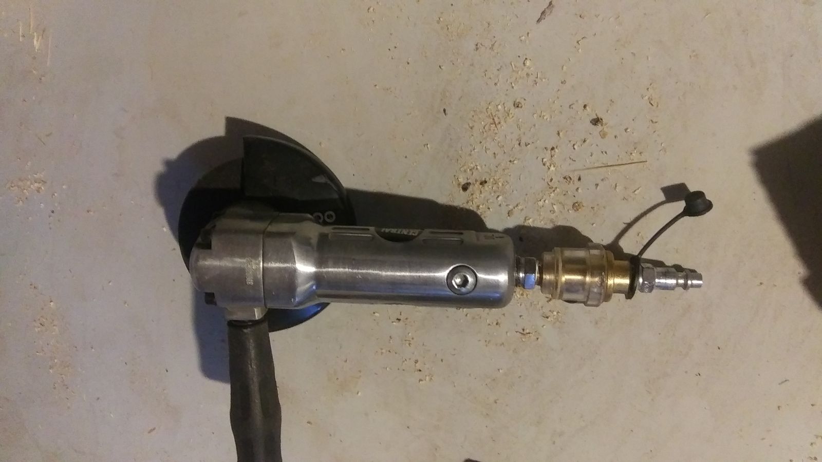

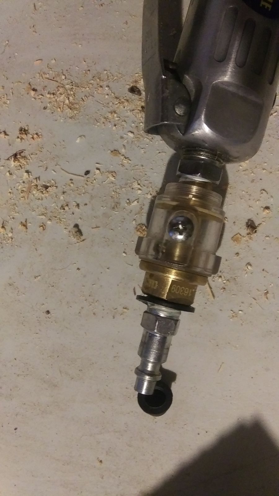

September 26, 20206 yr Popular Post comment_243541 The inline oiler I'm referring to is a small devise meant to be installed on the tool itself. You use one per tool, they're not very expensive. Here's mine: Report
September 26, 20206 yr comment_243571 Sorry I forgot about the small jobers screwed in to the back of a tool. Mechanics have a hard time getting the impacts in and around the motors of cars now adays so they were never bought by anyone in the garages I sold tools to...those guys were always screaming for smaller tools for me to sell. Edited September 26, 20206 yr by Smallpatch Report
