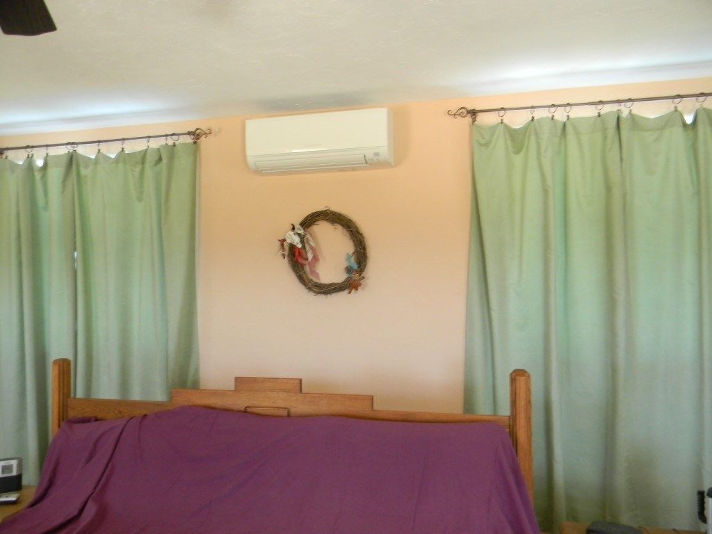

September 8, 20206 yr comment_241747 Jesse, a mini split for my shop runs about $700 for the unit. But, it provides heat, also. Since the only part of the unit that is located inside is the fan and electronics, dust can't accumulate on the coils. Here's a typical installation. Report

September 8, 20206 yr comment_241750 Thats good to know Gene. If I ever have a need to move I might go that way....Never seen one like that but the last time we were shopping was around 22 years ago.. How big can you go with units like that.. Report

September 8, 20206 yr comment_241771 4 hours ago, Smallpatch said: Thats good to know Gene. If I ever have a need to move I might go that way....Never seen one like that but the last time we were shopping was around 22 years ago.. How big can you go with units like that.. Not sure, Jesse. The largest ones I've seen have been 42000 BTU units, with 5 indoor wall units. Report
