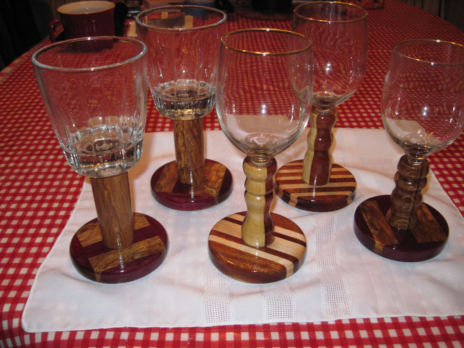

September 1, 20206 yr comment_240846 Okay, WOW!!! This is not a good idea with the way you have this set up. Your pen mandrel rides into a live center. On that mandrel you have a LARGE chunk of wood. Then we have the knurled nut that is working really hard to hold this together. This blank is one I would have p0ut in a chuck and turned, not a pen mandrel. Think small, not a vase. So lets look at how this can be done safely and without all this catching stuff. First get the mandrel I suggested on another post. This puts pressure where it is needed and eliminates the knurled nut and provides much better support for the pen mandrel. You are making a goblet. Base can be anywhere from 2 3/4 inches to 4 inches. I use 3 1/4 generally. Stem can start with 1 1/2 inches square. You don't need all that extra wood you glued up made into sawdust. What you want is a good yield of your wood, and less time on the lathe cutting and wasted wood. Take a 3 inch square board, this is the base. Now cut to length a piece 1 1/2 - 2 inches square. Drill holes in center of both. Put glue on the bottom of the stem and then press them together on the mandrel. Now you have a goblet 1/2 cut down to size without all that extra work. No big chunk of wood putting all that pressure on the mandrel. Look closely at the pictures below. Observe the orientation of the wood. You don't have to use different species / colors just focus on the shape. These are some of the 1st ones I made using this method. Stick with simple, fancy comes later. Report
