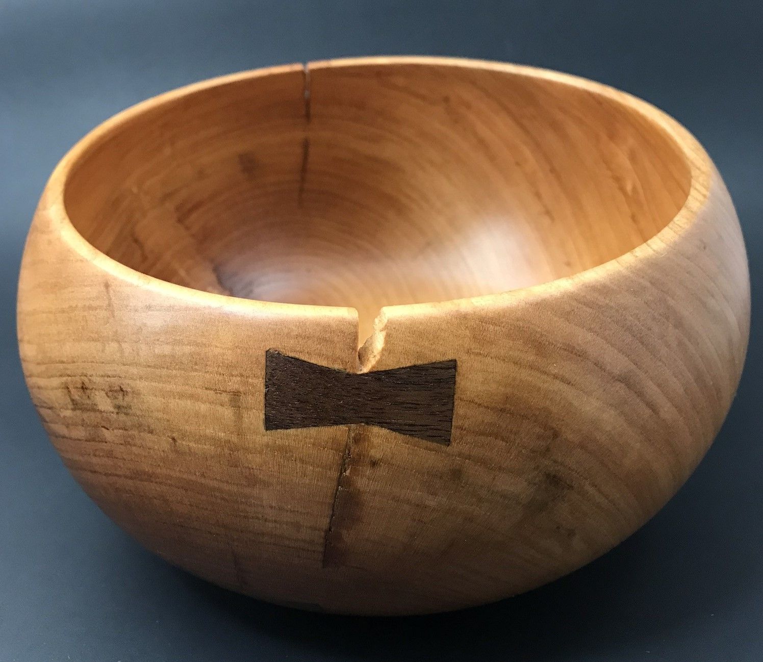

August 28, 20206 yr Popular Post comment_240568 For all experienced turners this is nothing new, but proper drying is a skill that must be mastered in green wood turning. When I started out, I finished turned all my bowls. The result, lots of unwanted warping and cracking. While this can be desirable in some cases, most people prefer a round and crack free bowl. The first solution was to rough turn my blanks and then place them in fresh shavings. While this method worked well, I soon ran out of room and it just took too long for them to dry. Below is the box I made to hold the blanks and shavings. One day I was driving through my neighborhood on Elmendorf AFB, and ran across this old military cooler. Right away I knew this was going to make a great homemade kiln. So I loaded it up in my truck, which was not easy because this thing was heavy. I drilled a few holes on the top, put in a 100 watt light bulb, and a small fan. This kiln reduced the drying time to just under a week in most cases. Sadly, I had to leave this behind on my last move, but I am in the process of either making a new kiln, or I might try putting my rough turned bowls in the attic. I have heard other turners do this method successfully. Report

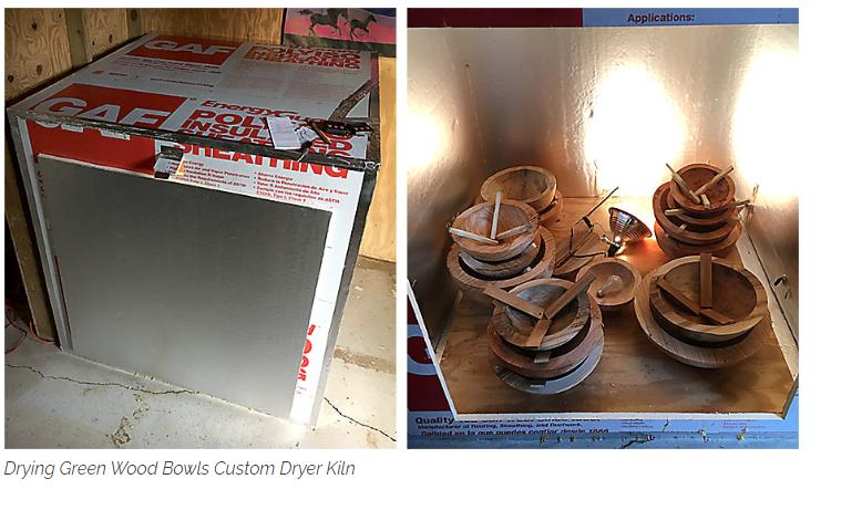

February 16, 20242 yr comment_329971 I'm resurrecting an old thread. I'm too impatient so I microwave dry. It is fine for what I do, but if you are making $500 bowls, you probably won't go that route. I also built a drying box (kiln). I made mine out of two sheets of foam house sheathing. I just duct taped it together. I will likely use the drying box more, and the microwave less. Kent Weakly at www.turnawoodbowl.com has an article on Drying Green Wood Bowls – 6 Methods For Success. In it, he talks about the drying box. Here's a pic from the article: You can't see them here, but he cut vents top and bottom to facilitate airflow. Report
February 16, 20242 yr comment_329976 Thanks for bumping this up! Built a small drying box from a cardboard box. A 12volt computer fan running off of 5volts and a 60watt light bulb for heat. Soak for 3 days then dry until weight stabilizes. Report
