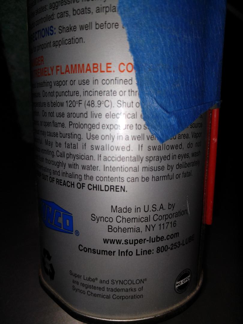

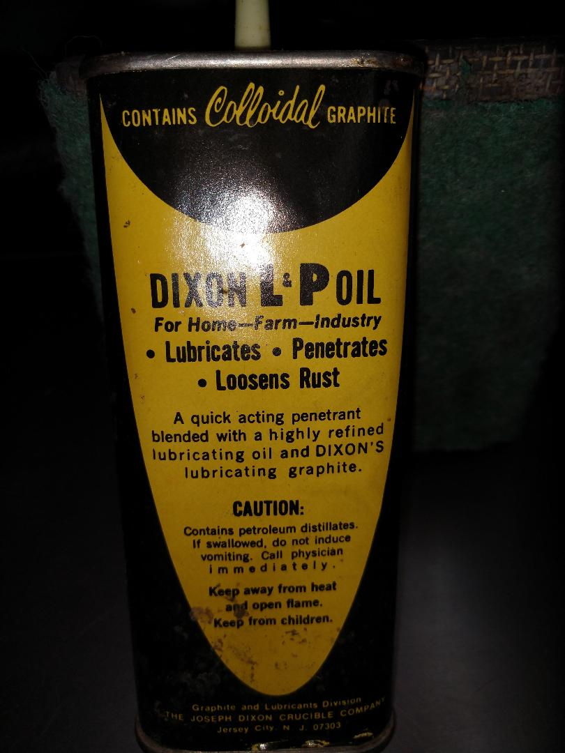

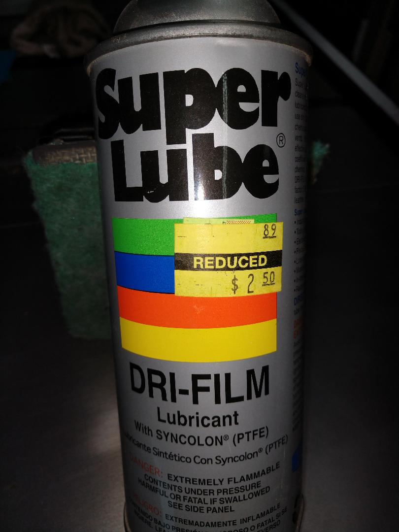

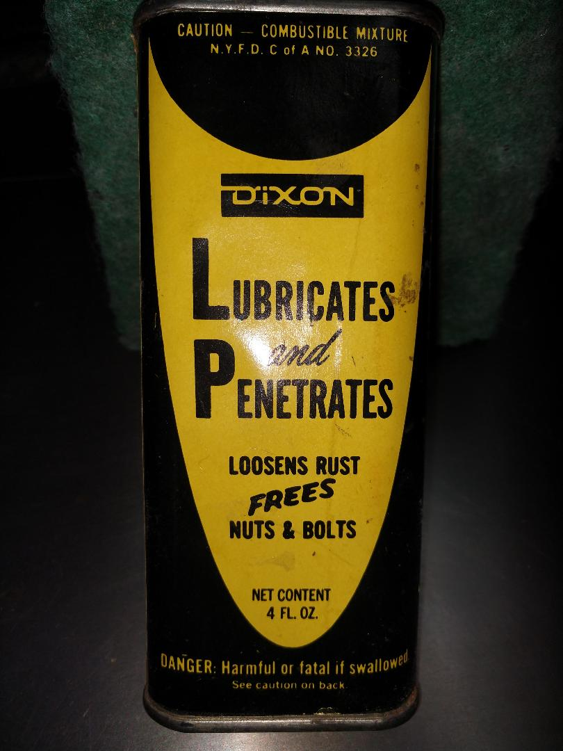

August 25, 20206 yr comment_240277 Looking for advice on dewaxing & re coating a table saw top. I recently just dewaxed my table top. Why? It was getting gummy. Used (in order) mineral spirits, straight household ammonia, Rust Free. I think/feel that it is now 99% wax free. Does anyone have a suggestion of another chemical that would have made it easier? Now I want to treat the table top to make it relatively slippery. I ordered a can of Slipit for woodworking--no silicone. But as I await the delivery, I went through my chemical stash & found the following: Super Dry Lube, Dixon's Lubricates & Penetrates. According to CS for Super Dry Lube it does NOT contain silicone but does have PTFE (teflon) that dries to a whiteish coating. Reading the Dixon can doesn't contain any info as to its contents. And AFAIK Dixon's chemical business is no longer. So any thoughts on the above chemicals or procedures? Report
