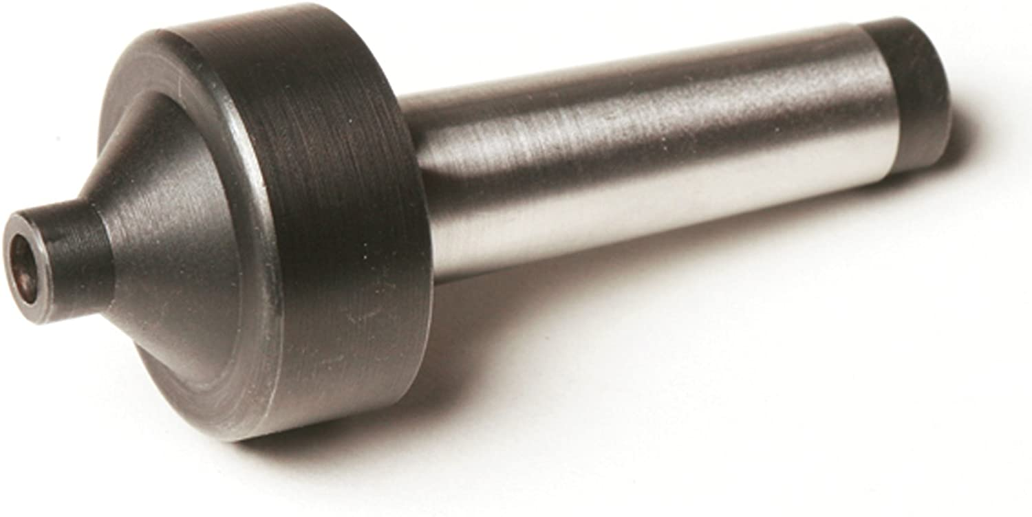

Look into one of these.  Saves your pen mandrel from bowing and gets you a better turn on the pens because it sits against the bushings not the end of the mandrel shaft.
Pen mandrel
I've got one of those, and I really like it.

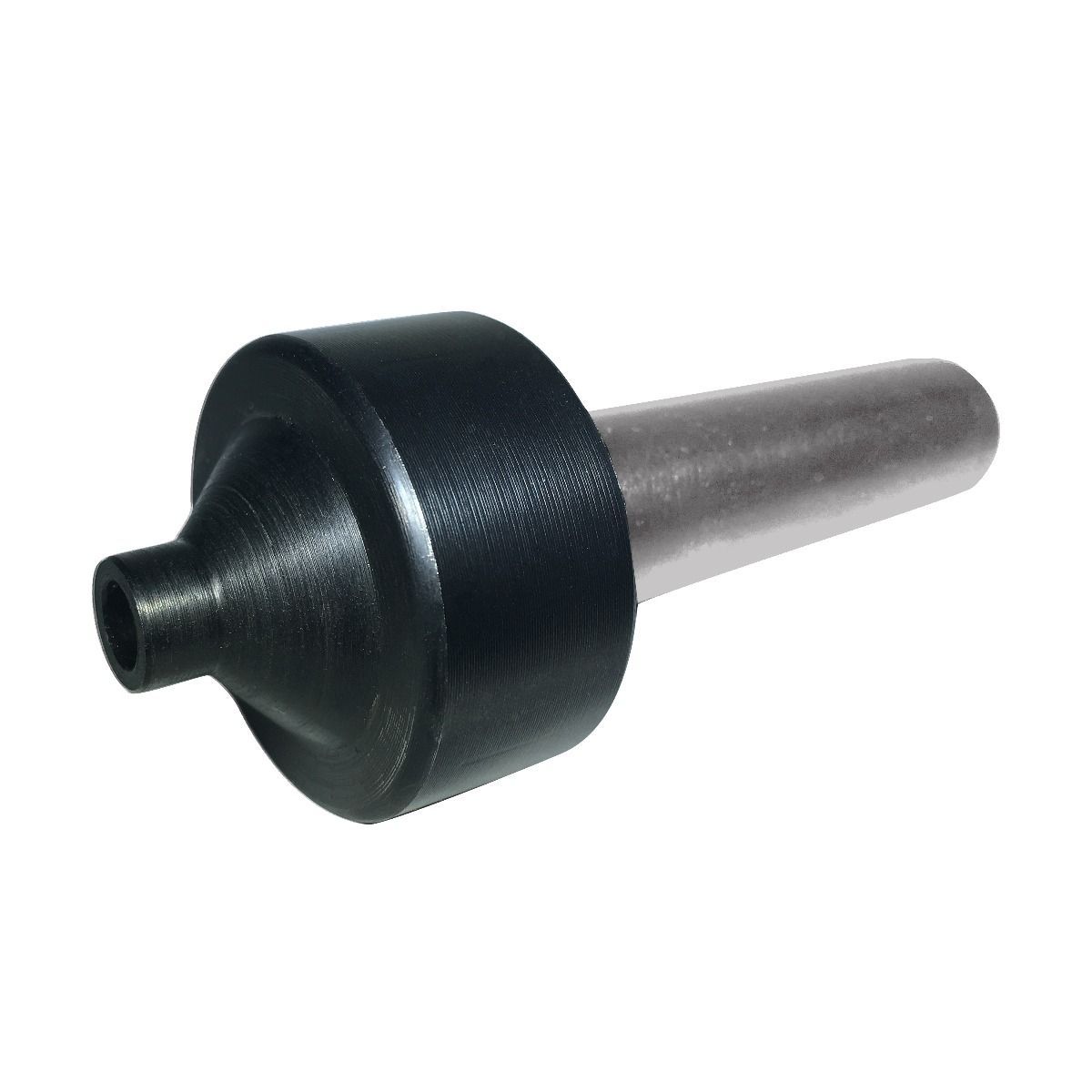

Pen mandrel
Yea I need to get one.
Would a regular live center do as well?

It does but the support this offers saves a pen mandrel from bowing over time.
Thanks, Gunny.  Will be putting this on my wish list.

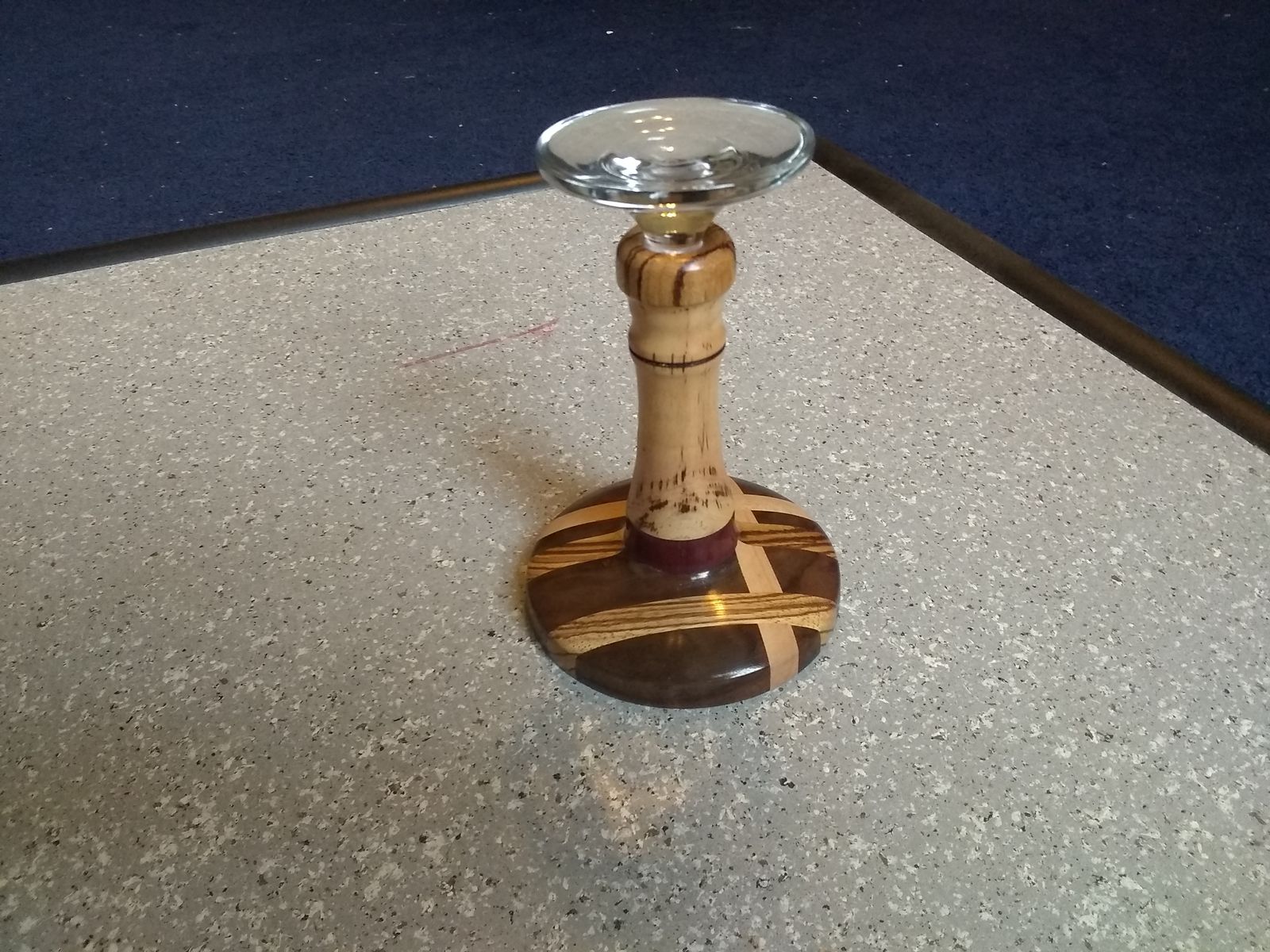

Pen mandrels have more uses then just making pens.  I use them to turn my goblets, small handles, all kinds of uses verse chucking it up the conventional way.  I keep it on my smaller JET lathe and have the RIKON set up with a chuck and live center.
Now thats an interesting thought on using them to turn goblets thats a pretty darn good idea.  I just ordered this https://www.rockler.com/nova-pen-mandrel-saver-2-morse-taper
so we shall see how that improves everything.  Maybe that odd noise the wood makes when carving will go away with that tailstock chuck.  Either way  I may have to try that to turn a goblet at some point.  How ever I'm not sure how you would cover up or conceal the hole that is drilled out through the middle and I was thinking last night that I could use it to turn candle stick holders and actually make them squared instead of lopsided and wobbly.
I take wine glasses and cut them stems.  Now I need a hole for the stem to go into the wooden base.  Having turned the base on a pen mandrel shaft I have a perfectly centered and squared off hole in the base.  Just drill down to correct size for stem and use epoxy to attach.  Now the bottom of the wine glasses can be used again as candlestick base.  Same idea.   For the bottom of the base I make a dowel and plug the hole.
