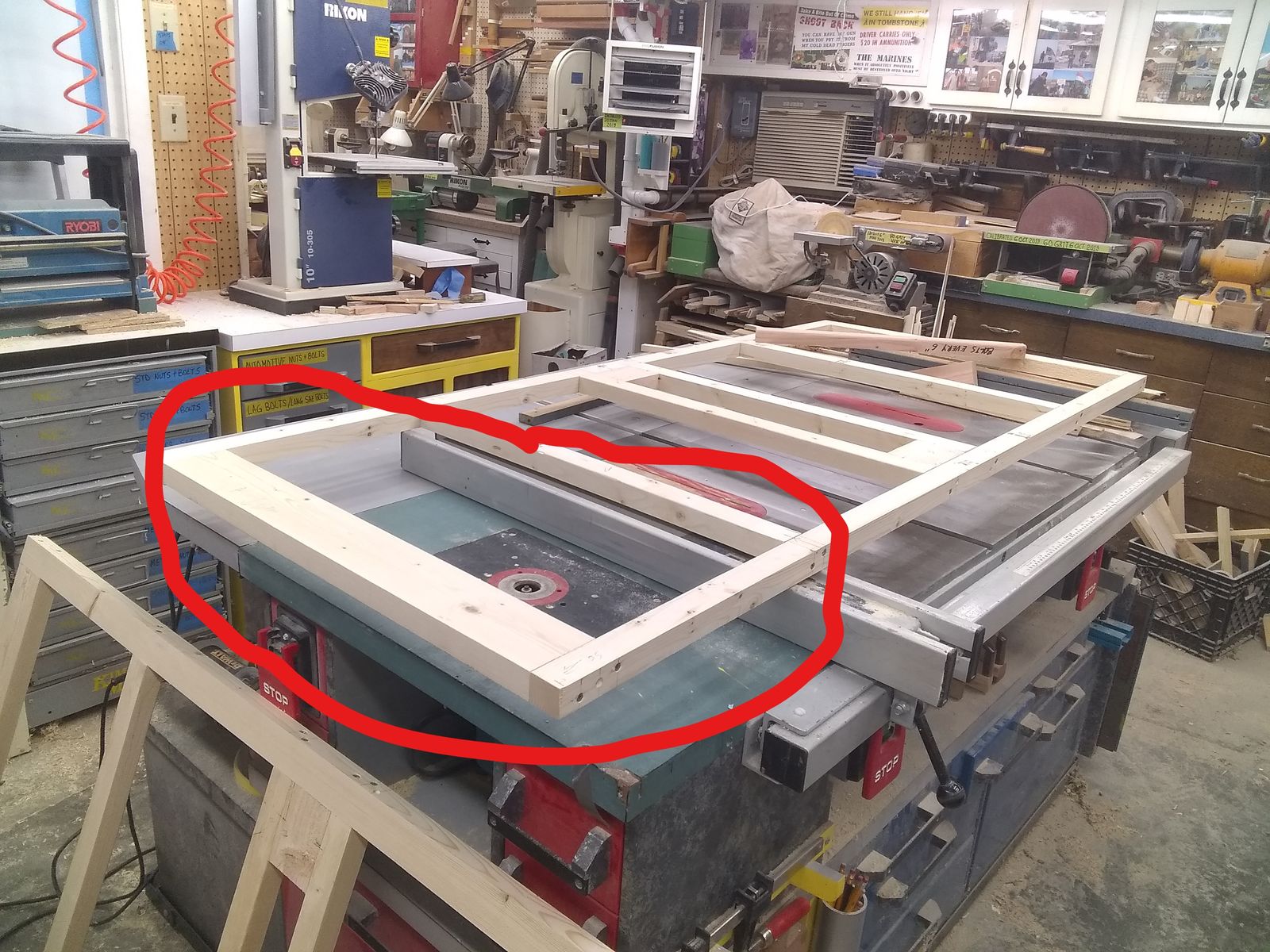

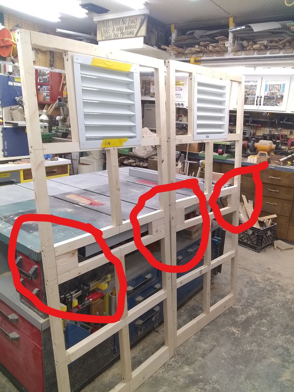

August 24, 20206 yr comment_240102 Others will have different approach but here is something to chew on. I made two doors for a exterior closet on my deck. They are non standard height at 6 ft even and 31 inches wide. These are hollow core but with much more bracing than a typical store bought hollow core door. Those only have wood frame along outside edge and cardboard filler to keep the thin layers of plywood from collapsing. Below is a picture of both door frames. Notice the circled areas. These are where a door knob can be mounted. I made sure it didn't matter which door I used or which side those areas would have support for the handles. The rest is framed up and screwed together. Once this was done I glued a 1/8 sheet of plywood to front. Then flipped over and put insulate panels inside the hollow portions and glued the back on. Not a solid core door but much better than a hollow core and custom fit. You could route a channel inside the frame as circled below and insert a 3/4 plywood panel. Once I assembled this part I glued 1/4 inch pieces to the sides covering the screws and the edge of the plywood sealing it against weather. Once done I primed with oil base primer then painted. Did both inside and outside. Report

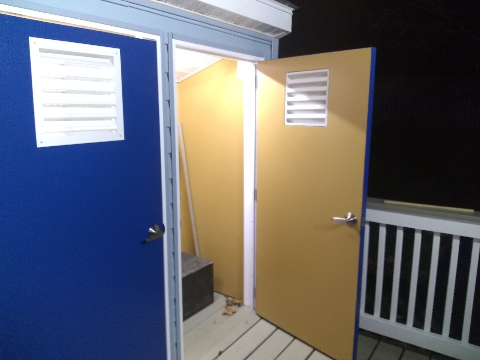

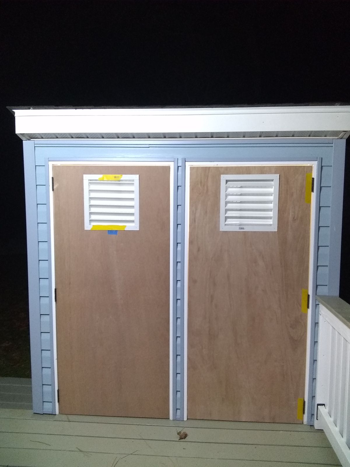

August 25, 20206 yr comment_240166 1 minute ago, ehbowen said: My biggest concern with that is making sure that the door is sized properly before the aluminum skin is added Do a complete dry fit. To include hinges installed and door handle with deadbolt if you are using one. Once you are happy with the dry fit take to get a skin made. Then all you have to do is drill out the holes for the handle and deadbolt. This is picture of dry fit to check level, and fit to frame. Once this was correct I added handles then on to finishing. Report

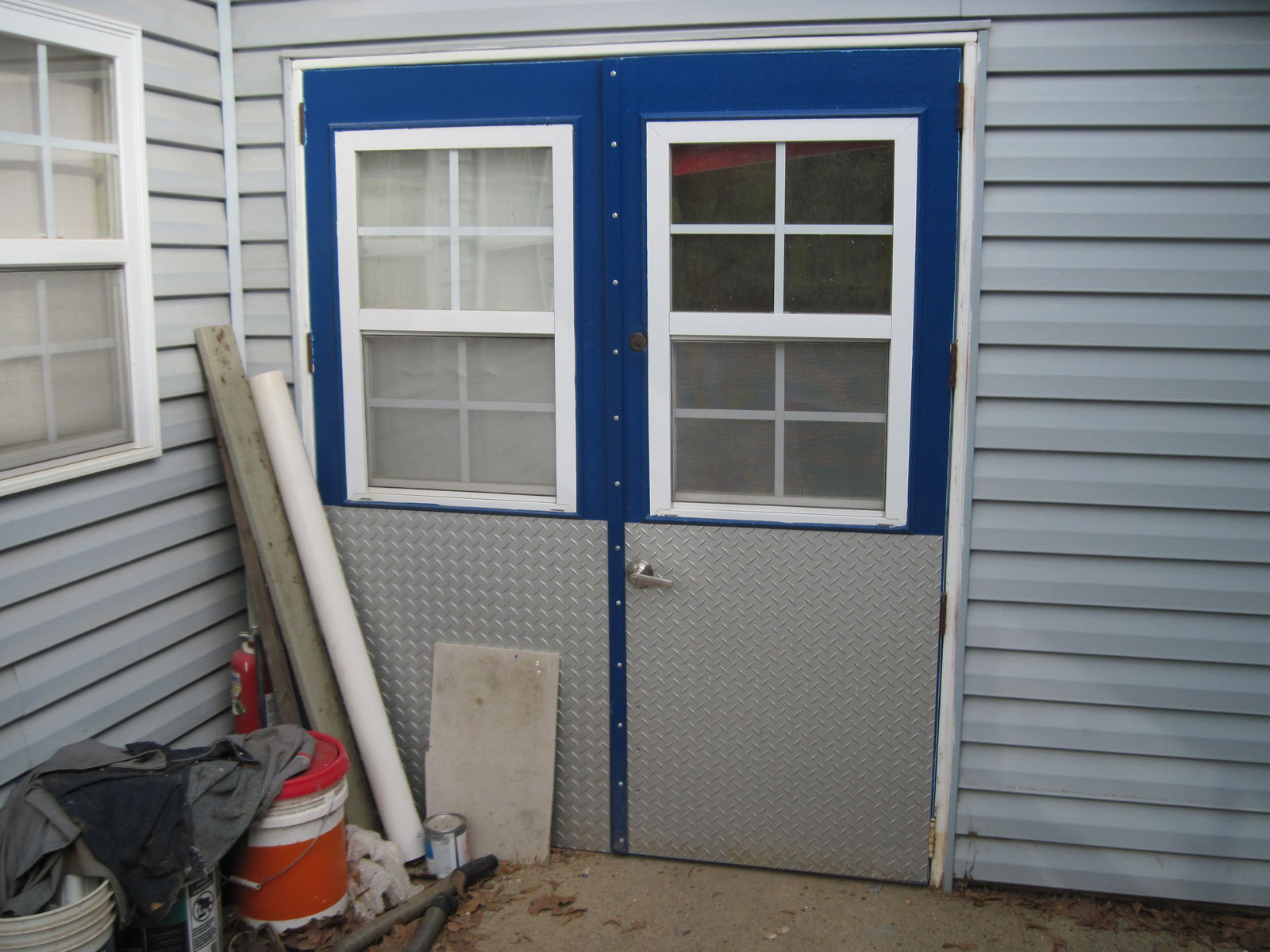

August 25, 20206 yr Popular Post comment_240172 Another option is to put a thin skin of Diamond plate on either all or part of the doors. These doors are 24 years old and also custom size. Windows are stock from the borg, with a similar frame as the closet doors. Pressure treated lumber at the bottom. Had them off to install the diamond plate and paint them. Minor damage from wear and tear. Put the diamond plate on to protect against things getting bumped into them that can impale the 1/8 thick skin. Also added the cut offs as kick plates on inside. Lots of options. I came across the diamond plate while helping a friend move. Not hard to cut and a carbide blade and a circular saw. Just mark the blade as never to be used for anything but to cut metal. Edited August 25, 20206 yr by Gunny Report

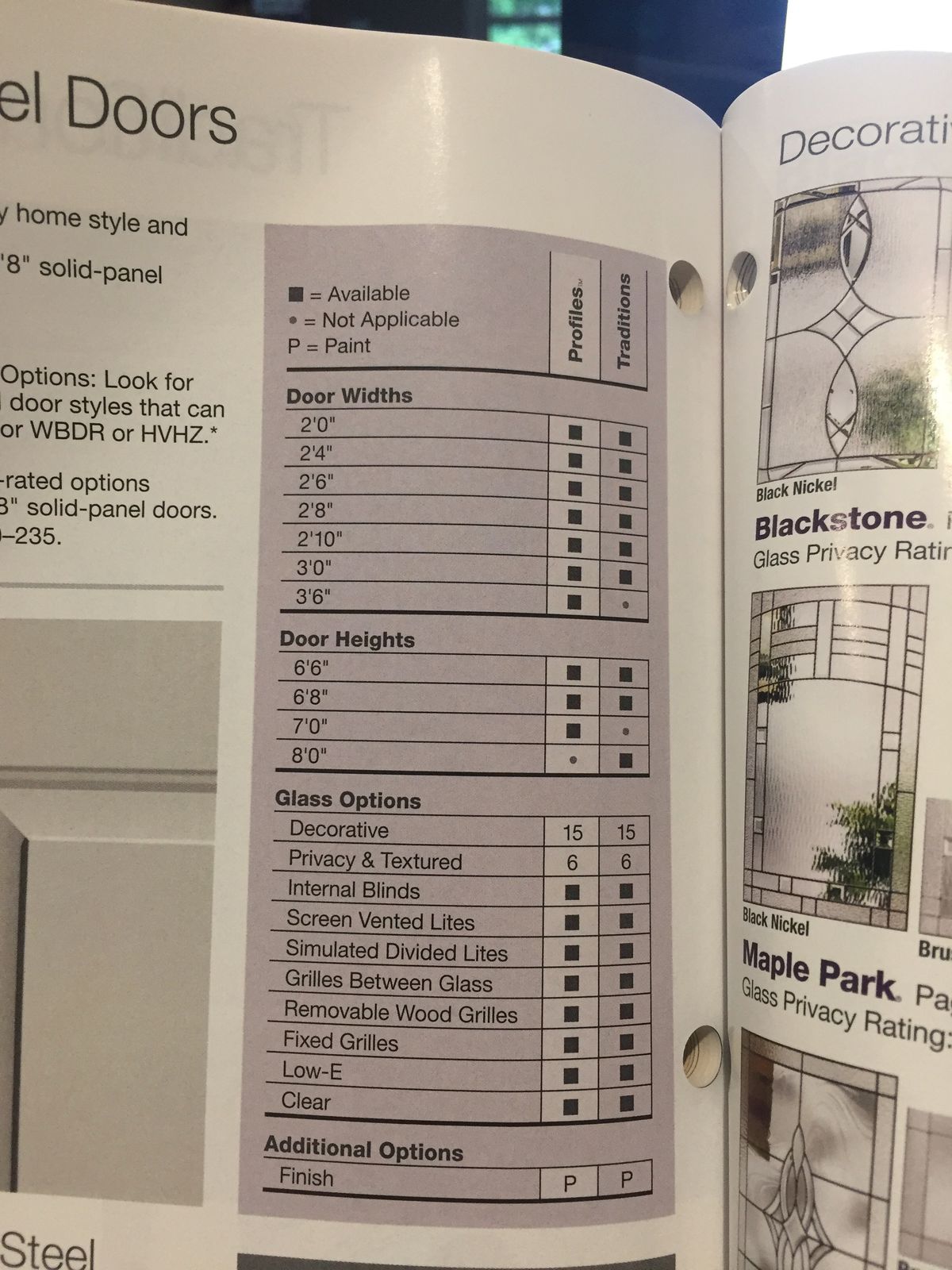

August 25, 20206 yr comment_240196 I am a little confused Eric. Both doors are standard size. This is from the current Therma Tru catalog, steel door section: Report

August 26, 20206 yr Author comment_240320 17 hours ago, Cal said: I am a little confused Eric. Both doors are standard size. This is from the current Therma Tru catalog, steel door section: 'Fraid I didn't see that catalog when I was searching for door replacements after Hurricane Harvey. Might consider it, but I still think I'd prefer to do it myself now just for the practice. Report
