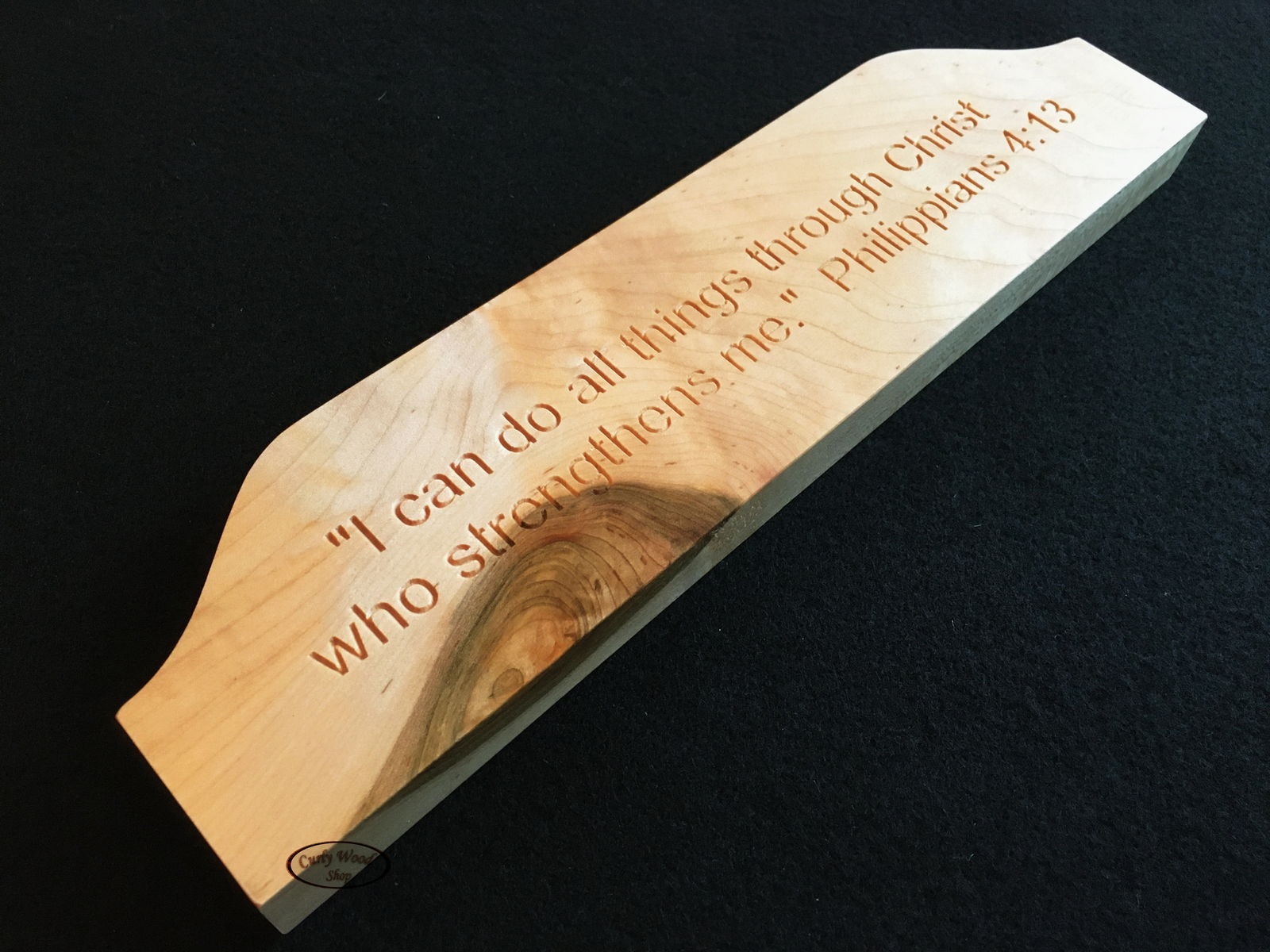

Popular Post difalkner Posted August 15, 2020 Popular Post Report Posted August 15, 2020 This is for an administrative assistant in a local school and I have been wanting to use some of my veneers so this looked like a good project for that. Madrone Burl on Maple, 12" x 3" by 7/8" thick, finished in Nitrocellulose lacquer. I didn't try to fill the pores - one coat of sealer, one coat of semi-gloss. Front and outside profile designed in CorelDraw, exported to Fusion 360, engraved with 0.25" 60° Amana bit, profile cut with 0.25" Whiteside compression bit. Back designed in Carveco and engraved with the same 60° bit. Cut veneer to fit oversize Maple blank - Glued veneer with TB I and pressed in my veneer press - On the CNC - Madrone Burl veneer on Maple - I am very pleased at how clean this came out! This was one pass on the CNC. Back side - Enjoy! David FlGatorwood, John Moody, p_toad and 4 others 7 Quote
Gunny Posted August 15, 2020 Report Posted August 15, 2020 Amazing piece of work. FlGatorwood, Larry Buskirk, difalkner and 1 other 4 Quote
Artie Posted August 15, 2020 Report Posted August 15, 2020 Anyone ever mention that you do nice work? Looks awesome! Gunny, Cal, difalkner and 1 other 4 Quote
