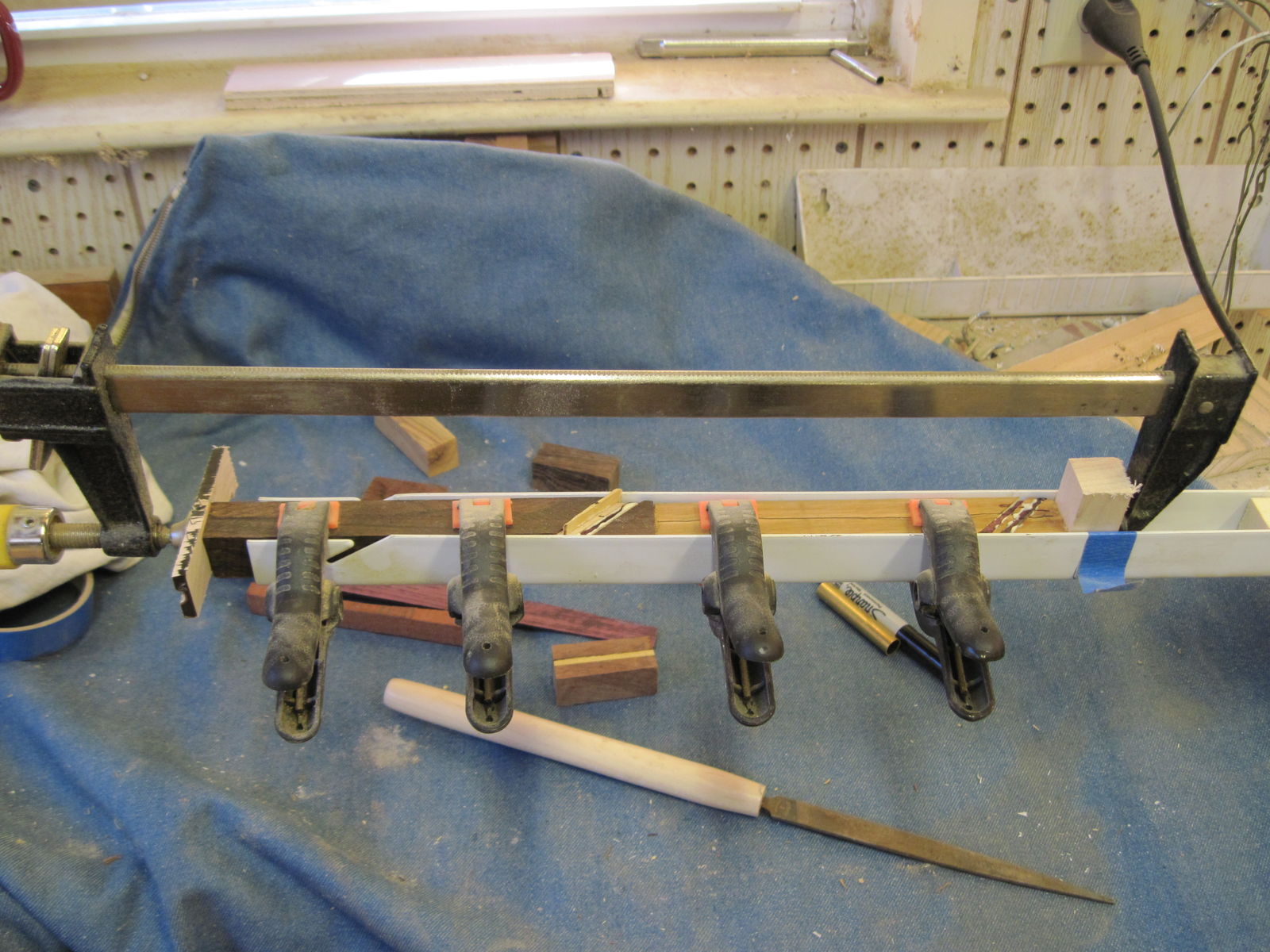

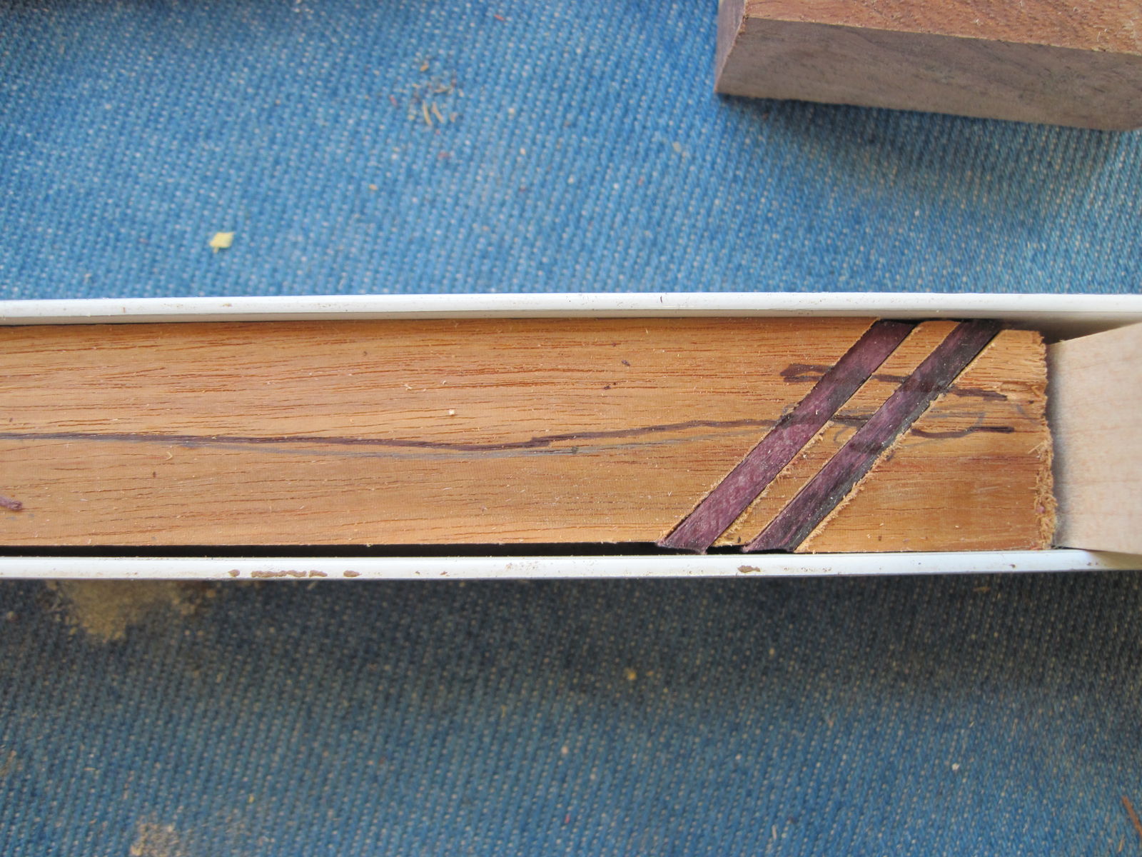

This cheap jig will save you alot of trouble doing laminates.  Doesn't matter if you just stack and glue them or cut angles and glue.  Works for both methods.  Used a piece of 3/4 shelf bracket about 18 inches long and a clamp.  No need to use heavy duty clamp HF is up to this task.  I generally use wood glue and let sit for a few days then cut them to size, drill hole and glue brass sleeve in them.  Pays to do several at one time, at least this 1st part and have this out of the way.
Finished gluing close up
Heres the video footage I recorded earlier making it
