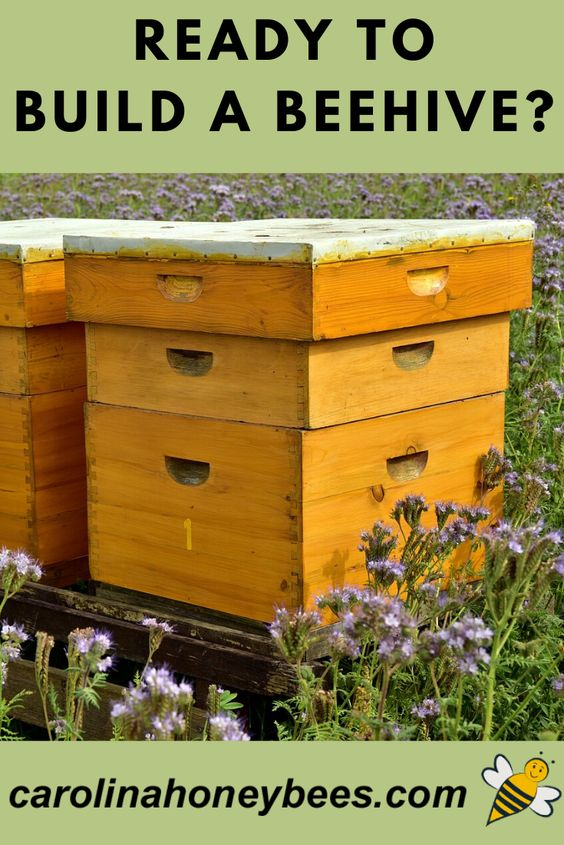

August 5, 20206 yr Author comment_237886 The other option I considered is a cut out similar to what's on a bee hive. Report
