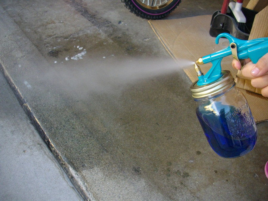

Or a critter, uses a mason jar and is great for small to medium projects.  Clean up is simple.  You can keep the finish in the mason jar and use tomorrow for next coat.  Lots of options.
A sign carving friend use the Critter exclusively. I think he has a couple or three. And, several jars. He says they're great for most finishing products. He has problems with water based stuff, though.
I have two, one for oil based finish.  The second one is specifically set for paint so I do not have to thin it.  Takes some time but worth it to not have to reset each time.  For most projects I do this works fine and is easy clean up.  Have 12 mason jars in stock, cause ya can always use an extra.  :D
I use the critter for all oil base. Tried other sprayers and the cleanup was a real bummer. Found the critter and that problem was solved
