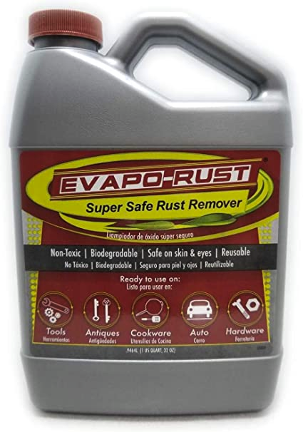

July 3, 20206 yr Popular Post comment_234104 Evapo-Rust gets good reviews. Finding the right containers to minimize the amount needed might be a challenge. Report

July 3, 20206 yr Popular Post comment_234182 a gallon of evaporust is about 30 at HF. When i was using it on some saw blades, i picked up one of those long, shallow, under-bed plastic boxes (and lid) at wobblymart. the evaporust i poured back in the bottle to re-use. Report
July 3, 20206 yr comment_234184 26 minutes ago, p_toad said: the evaporust i poured back in the bottle to re-use. Did it work well for you? Report
