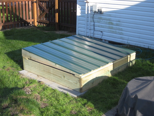

Paint would be good, Helmsman spar varnish would not be.  Nor would Thompson's water seal for the long run.  Metal roofing would be great -- I used this on a sandbox cover.  You might be able to buy some damaged stuff at the home center and use the undamaged section.
