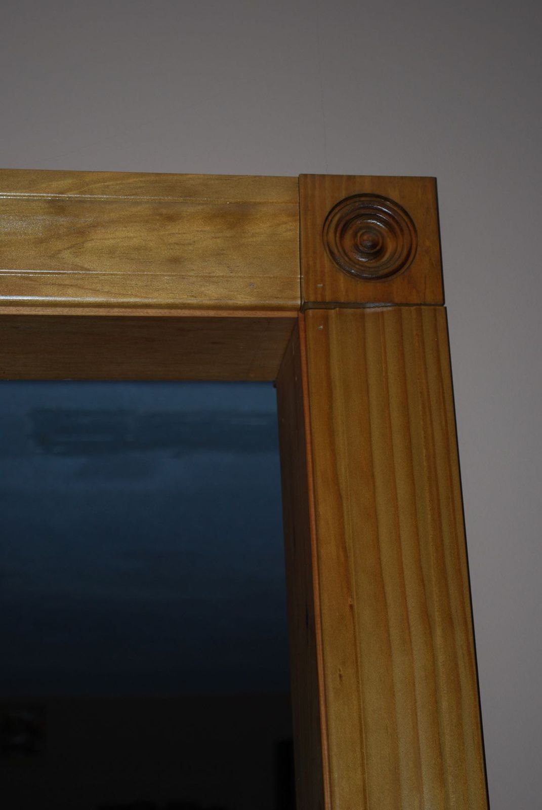

I never cared for the 45° corners.  I prefer this look and find it easier to do.

I have used this method in my kitchen:TwoThumbsUp:
I agree with the 90 degree joint.  I have seen 45 degree mitres and they often don't look good.  I have also seen it done on exterior parts of the windows and doors allowing rain water access to the stiles.
Every interior door in our house was done that way.
I have been commissioned to recreate some of those corners on the lathe over the years.  Somehow they go missing.
