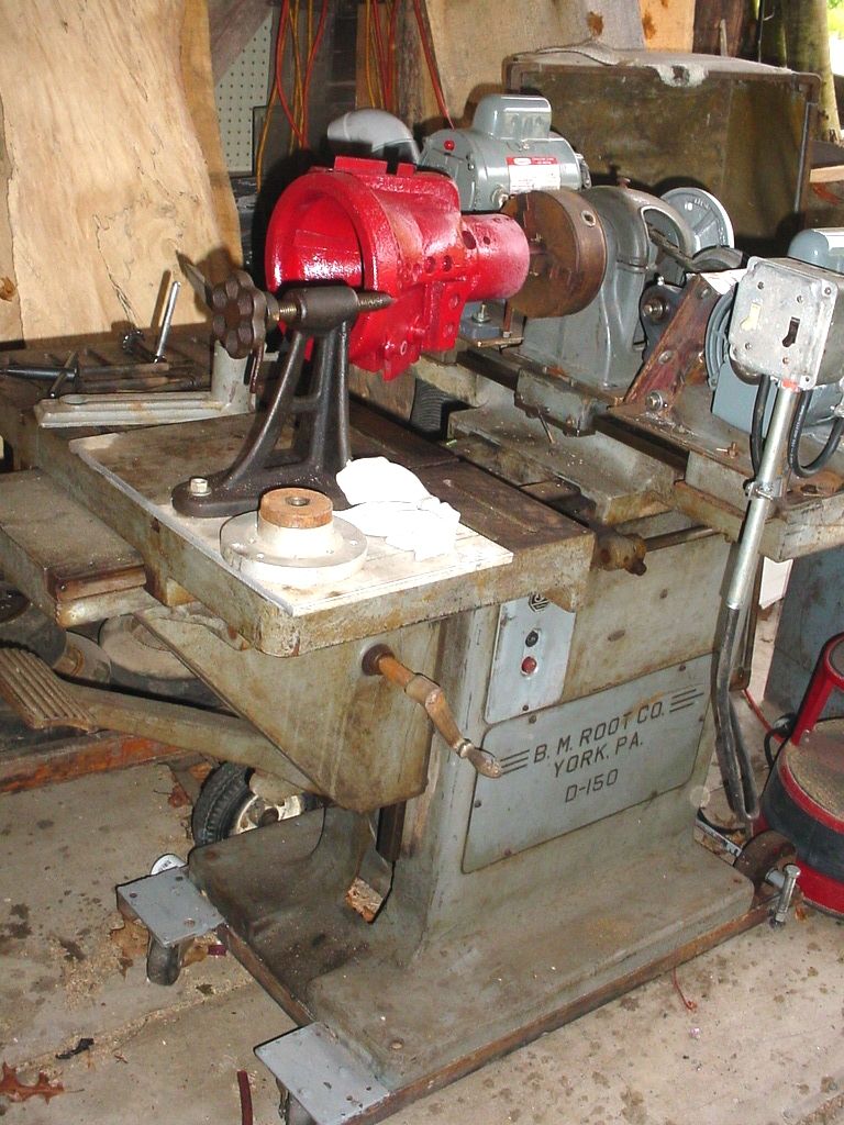

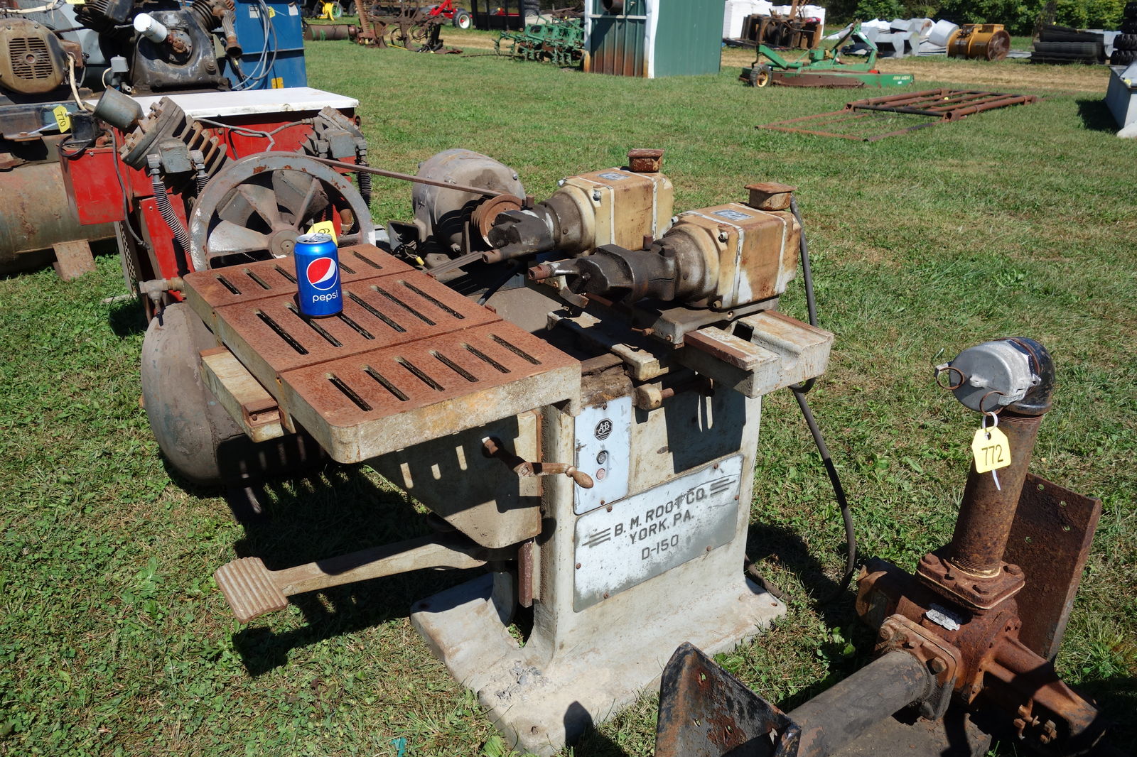

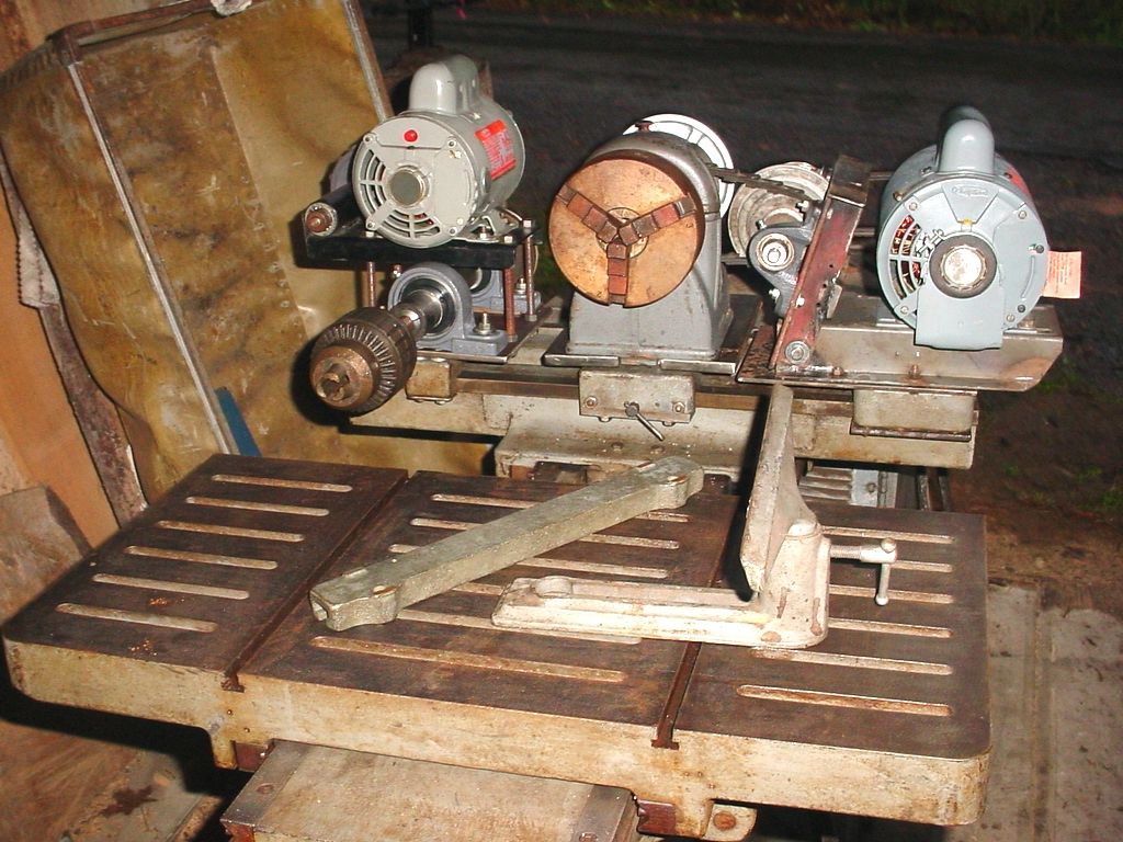

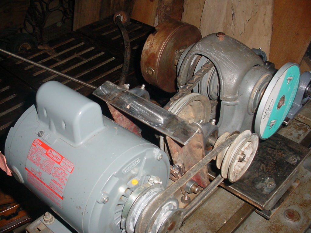

I was at an auction one day and seen this machine in the first picture.
I said to my self now what can I build out of this.
I took everything apart and cleaned it up the best I could.

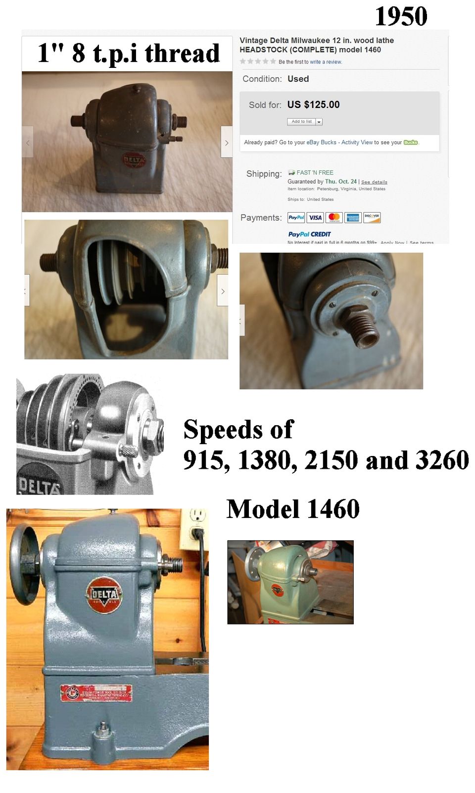

Then I bought a Delta 12" wood lathe headstock and mounted it.

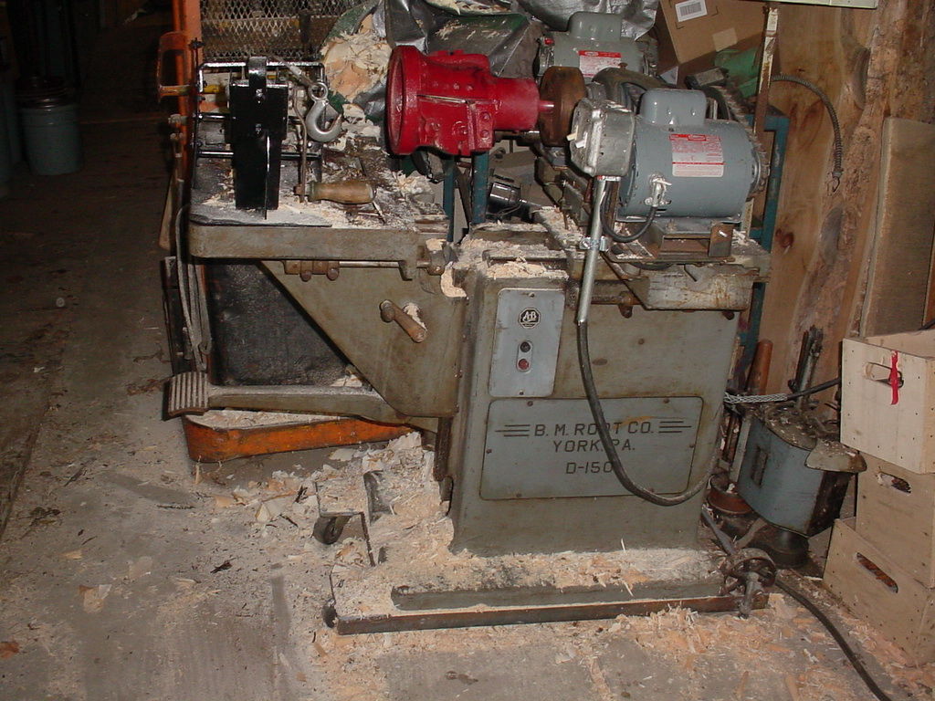

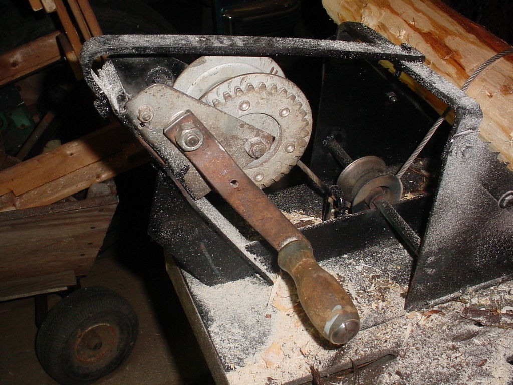

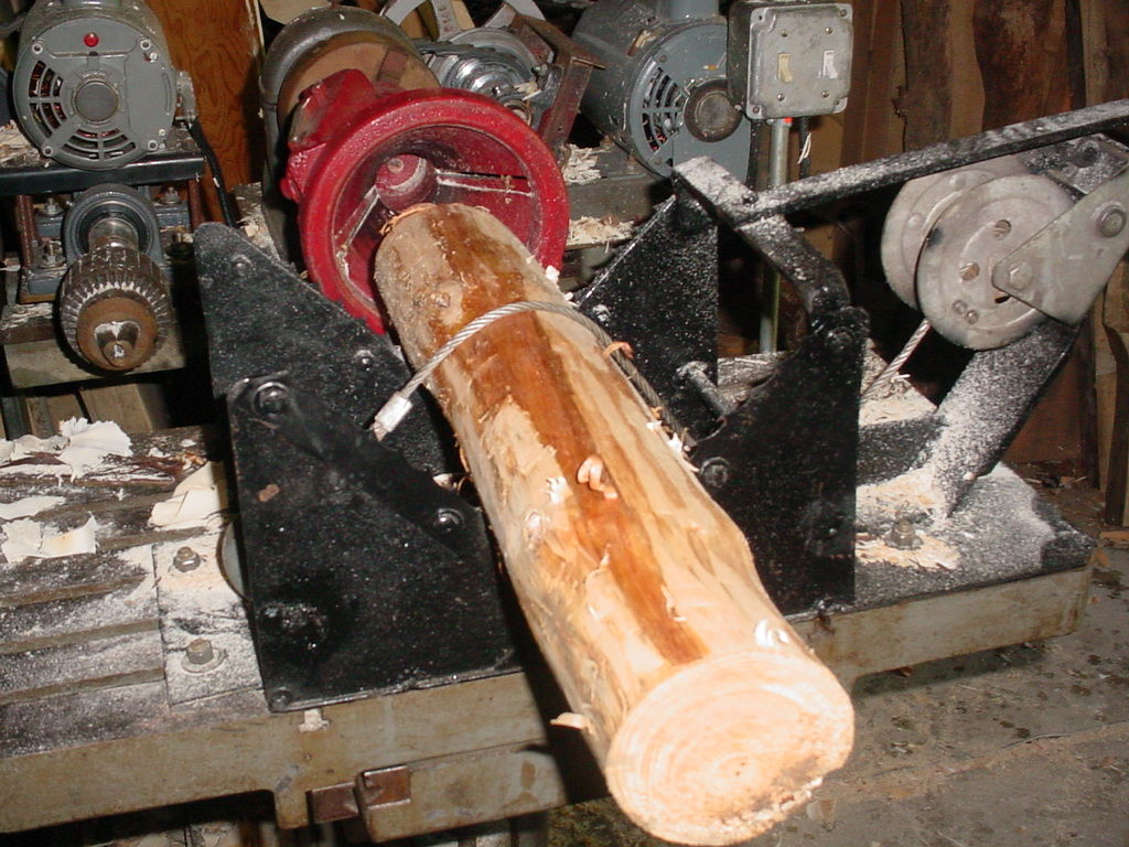

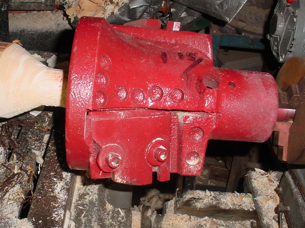

I put a huge tenon bit in the lathe chuck...

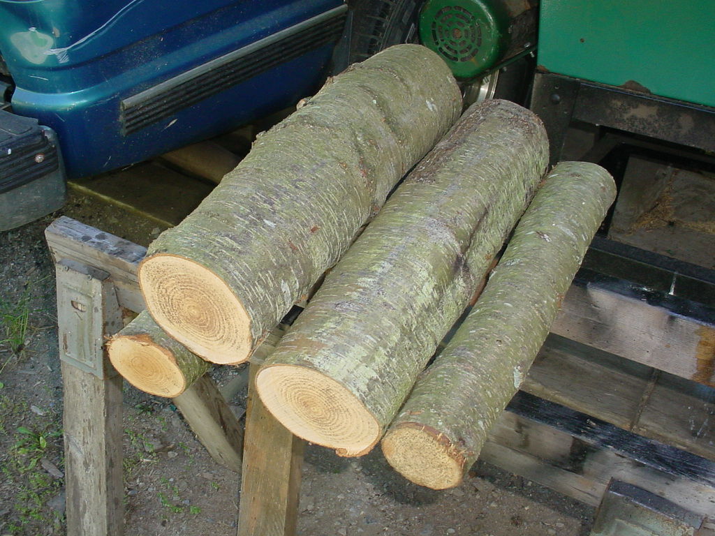

Then I made a Carrier for the log.
Tenon bit weights 45lbs.

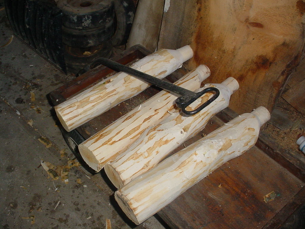

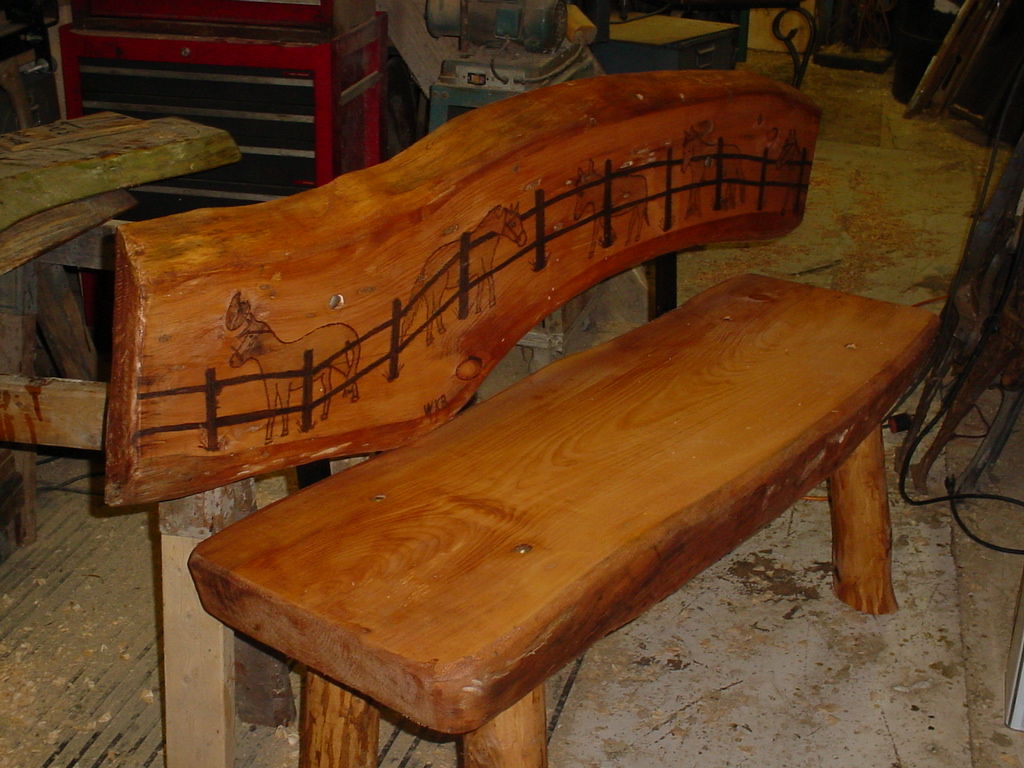

Finished product.
Ditto. Does the job, alright.
York PA is 3 weeks from here. :OldManSmiley:
Varnish day tomorrow....

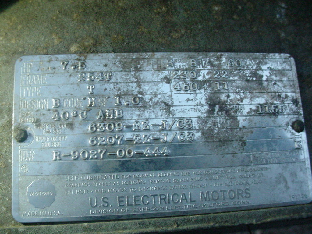

This tenon bit I'm using came off a machine that had a 6 1/2hp  1156 RPM 3 phase motor. The bit was hooked directly on the motor shaft. I would not want to be the operator of that machine.

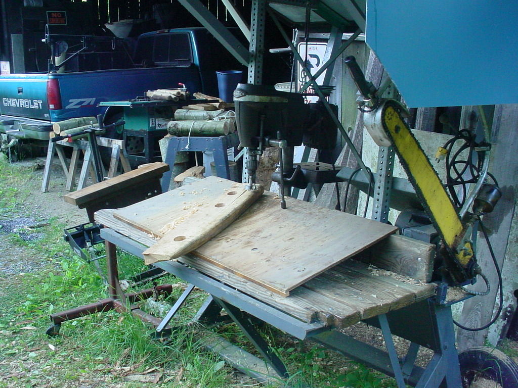

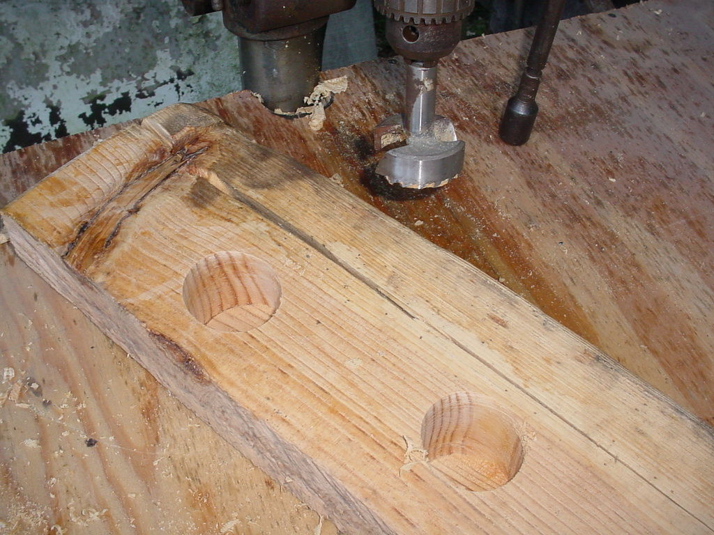

I just finished up making a 15 deg. drill table for drilling 2" forest bit holes in my bench bases. Works great. Table lifts off so i can use my slab saw. Press stays attached.
Cool Idea!
