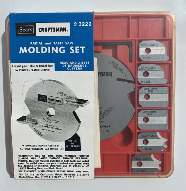

June 8, 20206 yr comment_231494 This Sears table saw set I also have a few different styles but I never used them in the 60 years or so since I bought them. I have seen many for sale at garage sales and auctions but I don't think any one ever told me they used them after they bought them and the answer was always it scared me to death just thinking about it....I thought I needed to try them a few times but no.....never had the courage.... I figured there would be lots of tear out and I never could afford to buy more wood to try.. Report
