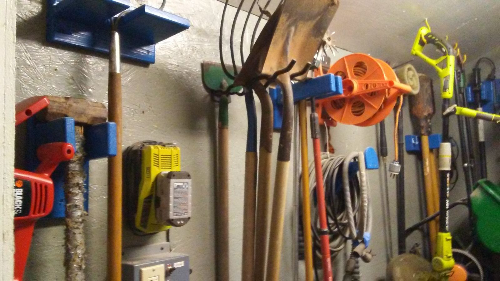

June 3, 20206 yr comment_231039 I have four chargers for my DC powered tools. I started with Sears 12V batteries, that didn't last long. Now I have 3 diffrent brands, due to receiving gifts and now a 40 volt mower battery. My work area is very small and limited. I've moved things around and now have the batteries/chargers kind of organized. How do you store you DC equipment? Report

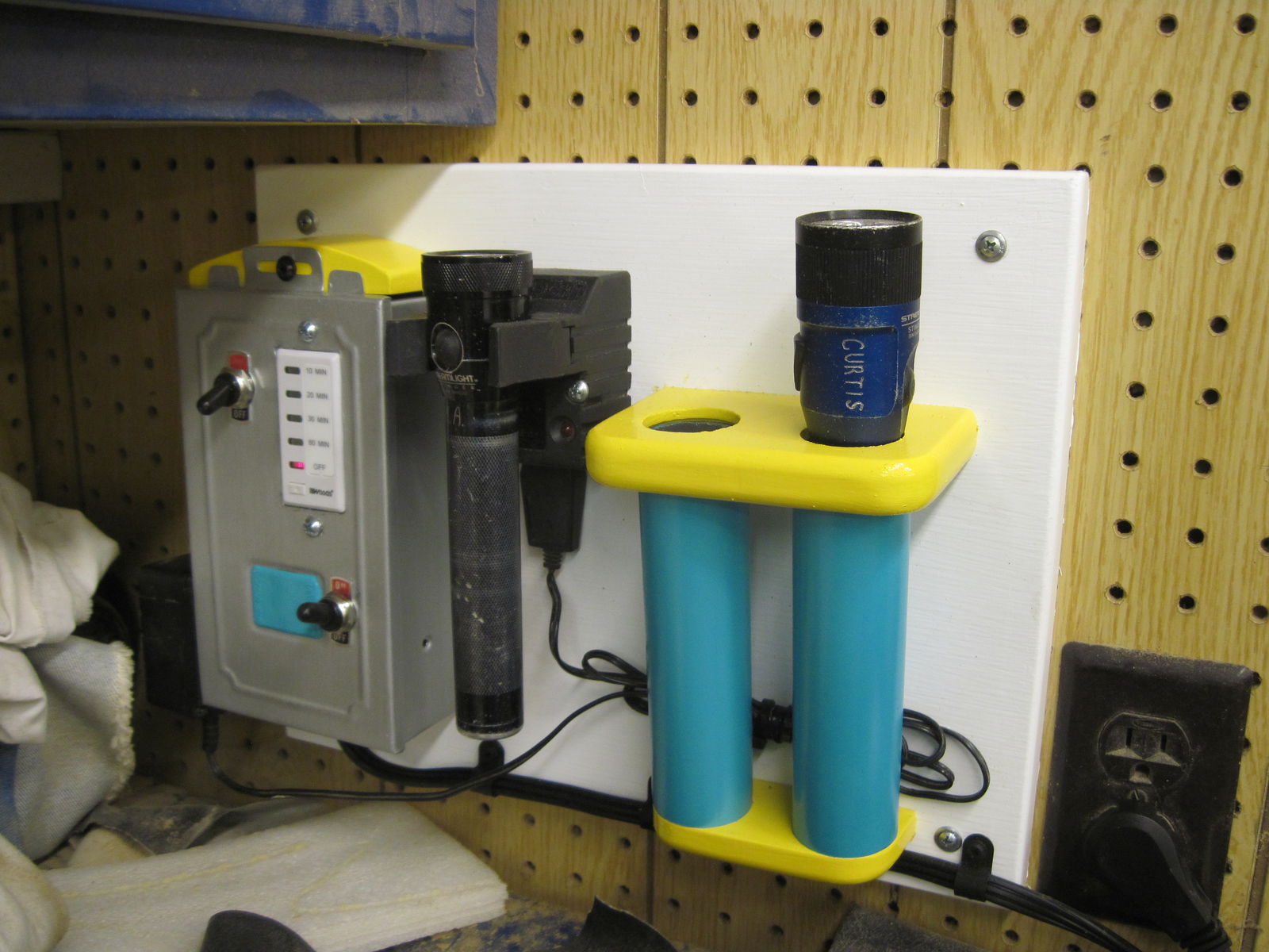

June 3, 20206 yr Popular Post comment_231048 I have three of these, two in shop and one in back building. They are powered through a timer and a switch to each charger. Set the timer 2-8 hours and flip switch for that charger. Once the timer is off, no more power to unit, no topping off wsting a charge cycle. Edited June 3, 20206 yr by Gunny Report
June 3, 20206 yr Author comment_231058 Gunny, I guess that answers one of my questions about leaving a battery on the charger 24/7. But it also bring up another question. If you fully charge a battery, it does no harm to leave it in place? If it slow discharges over a period, does it auto charge back to fully charged? Report
June 3, 20206 yr comment_231062 24 minutes ago, Ron Altier said: If you fully charge a battery, it does no harm to leave it in place? Great debate on this. If left plugged into a regular outlet many chargers "top off" this is a small static charge to keep at max level. Problem is that also counts against the expected charge life of the battery. Leaving a battery plugged in to a charger is a potential fire hazard. Sure the risk may be low but why take it at all. Best to take battery out once done, or if left overnight the next day. I use this method of killing the power to the charger to eliminate this top off feature. Generally I pull batteries from the charger before calling it a night just to be sure. If you get a timer make sure it has 2-8 hours of time on it. Many only have 5 min to 1 hour. For some batteries this is not enough time. How well does this work? I have same set up at work for my Streamlight flashlight. Have gotten 10 years out of those batteries before having to change them out. Having more than one so you don't constantly charge and use same one is also helpful. Report
