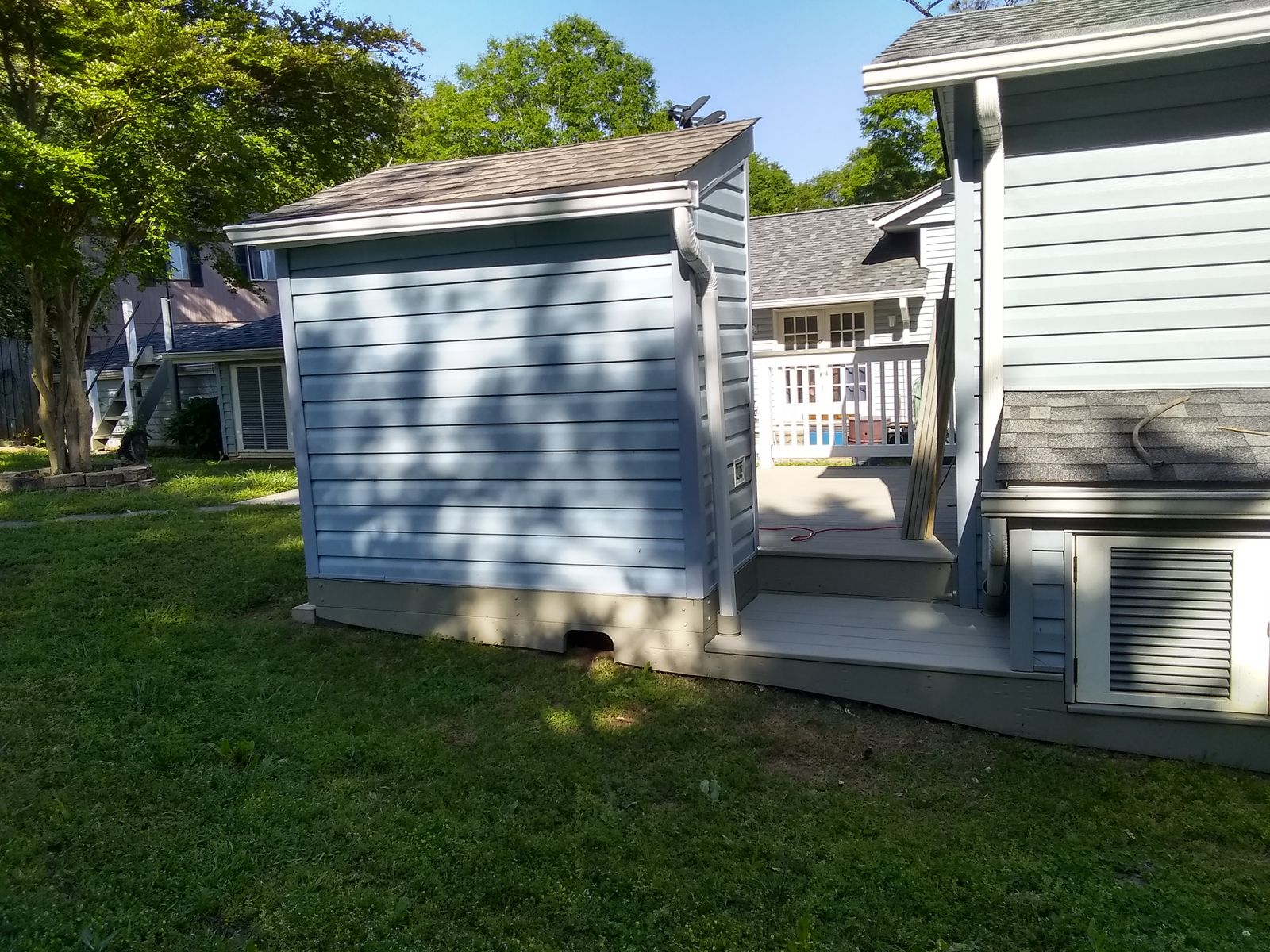

While I finished the deck itself last summer I left this landing and the gutter for the closet off till better weather.  So for past two weeks I have slowly been getting it assembled.  Had to add to my 3 inch drain pipe to come across to the extra location.

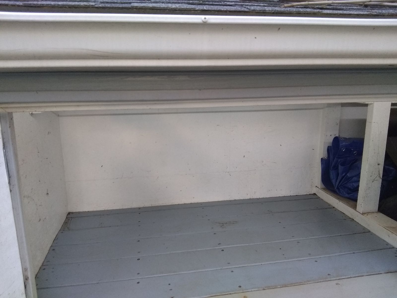

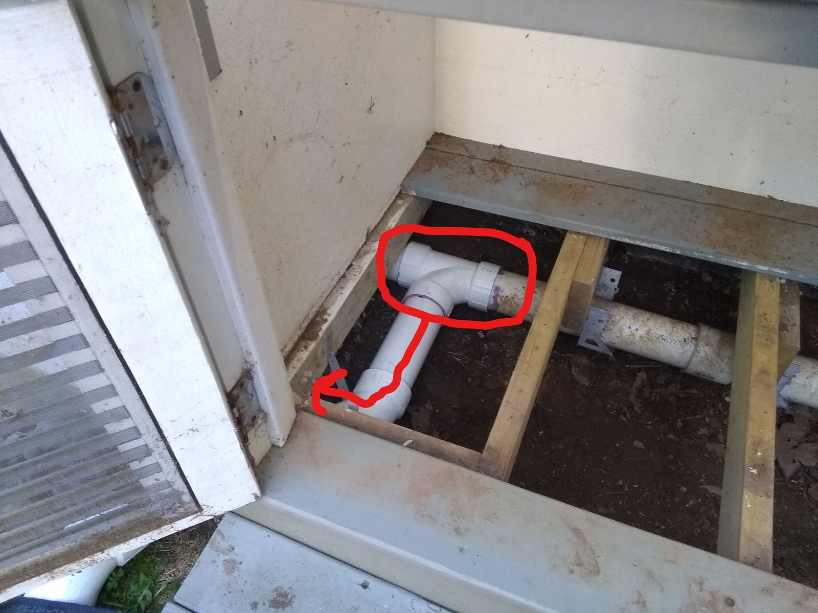

Then I removed the deck floor inside this cabinet and accessed this side to add my other piece.
Put the floor back and good as new.  Was meant to be removed for access below.  A moment of brilliance I had.  :throbbinghead:

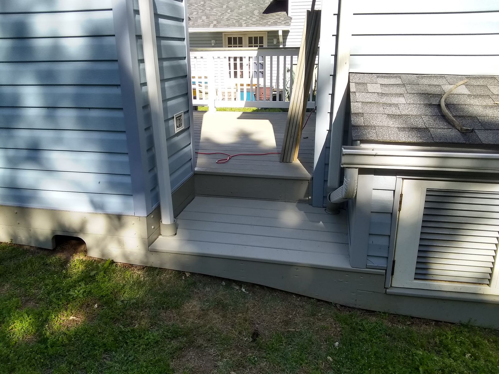

Painted the bottom of all the deck boards white, just like entire deck and then flipped and primed then added Deck Coat for a rough surface.  Seems to work well I have been on the deck in the rain and didn't slip.  Painted some gutters my neighbor took off his place and then painted the 3 inch PVC pipe grey to match and protect from UV.  Waited few days and for good weather and installed this afternoon.  Ran the garden hose through the system and no leaks.  :TwoThumbsUp:
