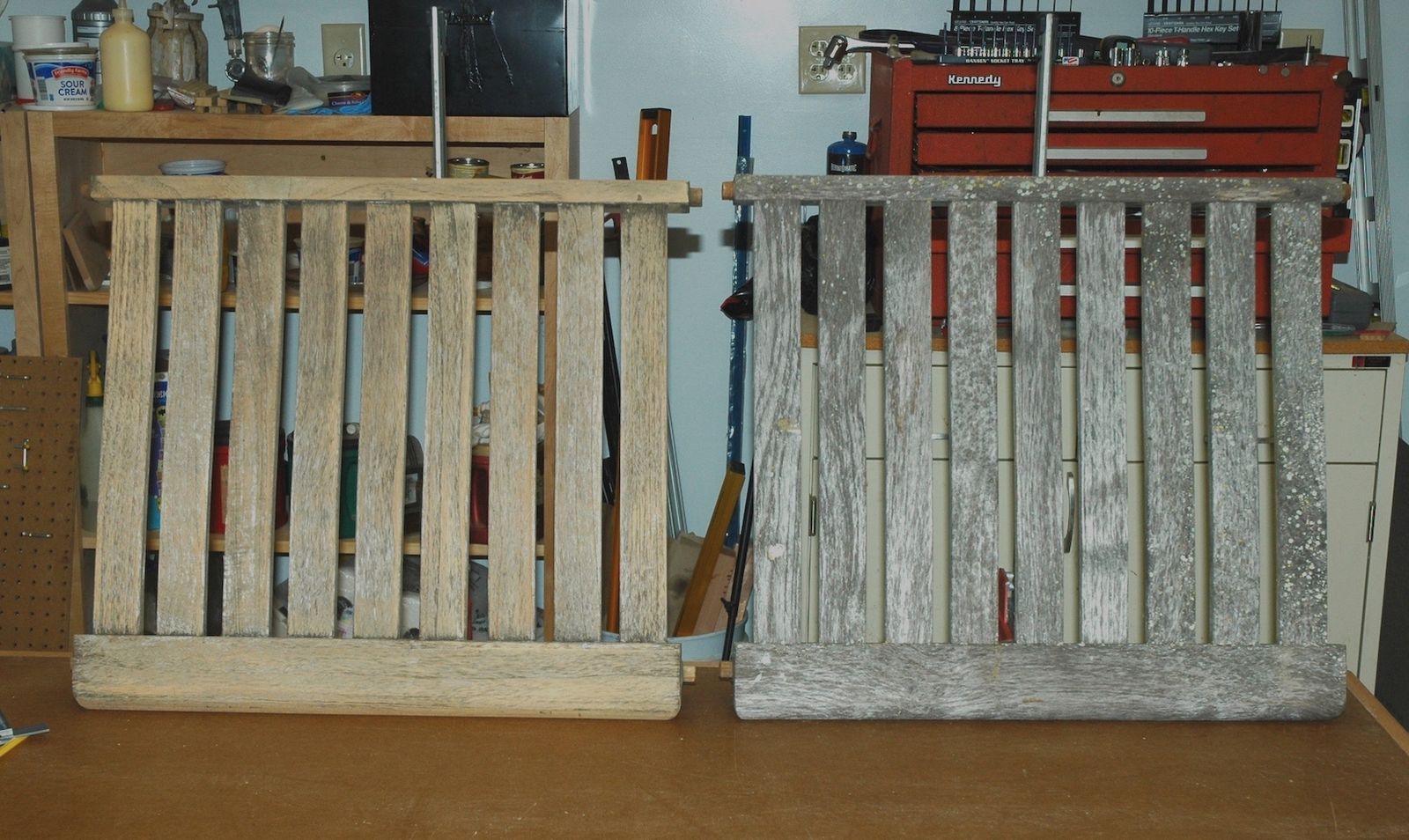

April 10, 20206 yr Popular Post comment_224612 This is one of those jobs I kept putting off because I "didn't have time". Turns out that wasn't really the reason () it's just that I hate doing such things. My wife has 2 teak rocking chairs that have mostly sat outside. The factory finish was totally the wrong one to start, but outside life and general neglect on my part made things worse. So I've sanded these back over the last couple of days while I could work outside (weather has been quite nice last week) and got them to this point. The seat on the right is what I started with, and on the left is what I call "good to go". These will be painted this time instead of the clear coat they had. I can't get the staining out so got the crud off as best I could and will prime them with an oil based primer, then top coat with a good exterior paint. Problem is, I have the primer but not the top coat paint. So I'm again stopped until I can go get the paint. But at least the wood is still in good shape, and while I've had a Fein Multi master for a long time....it had only been used for cutting and trimming things until now. I used it for sanding for the first time and found it useful for getting into some tight spots. Most of the remaining sanding was just done with an ROS (and lots of discs). Edited April 10, 20206 yr by Fred W. Hargis Jr Report

April 12, 20206 yr Author comment_224908 Keith, thanks for that. I was actually wondering if any f the paint stores had considered doing it. Others, as for clear coat any of them will require a repeat of the process over time while paint would be so much more durable. Even so, I have to check with the customer (LOML) and see what she says. If I wind up clear coating it will be with an untinted oil based paint. Report
April 12, 20206 yr comment_224912 Might be a job for clear paint? Best of both worlds maybe? I've not done it myself, but it is on my bucket list when I get back into some outside projects. Report
April 12, 20206 yr Author comment_224917 Yeah, maybe. That was the uninted paint reference I made. I've used it quite a bit in the past, but the brand I used to use (Olympic) isn't available in poil based versions anymore. Report

April 14, 20206 yr Author comment_225143 Well, the boss wasn't sure whether to paint them or clear coat them, you couldn't envision what they would look like clear coats. So, off to SW where I got a qt. of their SWP oil based exterior ultradeep color base. This stuff looks like french vanilla whipped cream when you open the can, but dries quite clear. So I'll show Marie what it will look like and go from there. I'll add that my SW store did have curbside delivery, but you had to call ahead so they can mix (if needed) and shake your paint. Then you pull up in front of the store and call them to bring it out. No cash payments, they take your credit card process the charge (you can do that when you order if you want) and bring you the receipt (and your card). BTW Keith, thanks for letting me know about the curbside stuff...I would have still been waiting for the crisis to end had you not mentioned it. Edited April 14, 20206 yr by Fred W. Hargis Jr Report

April 14, 20206 yr Author comment_225148 OK, got the clear direction from the boss..they are to be painted a medium gray. She doesn't appreciate the look of the grain once clear coated. Actually, I thought it came out really nice. Oh, well. Back to SW tomorrow after I call in my paint order. Report
