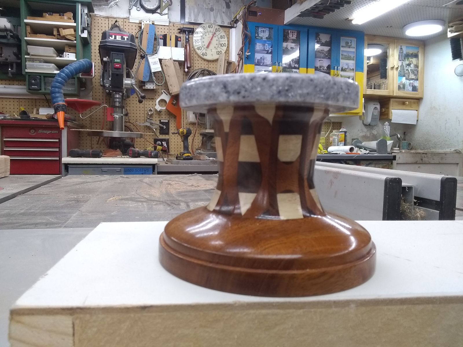

March 20, 20206 yr comment_222088 53 minutes ago, Ron Altier said: the most success I've with Ca is on my fingers. HF gloves takes care of that issue. I use the accelerator to quick dry the outer surface when I am gluing say 10-15 pieces up at one time. If you are not planning on turning the next day do without and let the CA cure well. For larger projects I use medium CA and let it cure 3-4 days before turning. Caution on my part, it is probably okay after 1-2 days. Piece of Corian glued with medium CA to the base. Report
March 20, 20206 yr Author comment_222110 Thanks, that is a beautiful piece. I'd like to see it closer. Report
March 20, 20206 yr comment_222111 4 minutes ago, Ron Altier said: Thanks, that is a beautiful piece. I'd like to see it closer. I will get some better pictures tonight. If you want some 2 inch square 1/2 inch thick Corian squares to try I have plenty. 3 drawers full. Report
