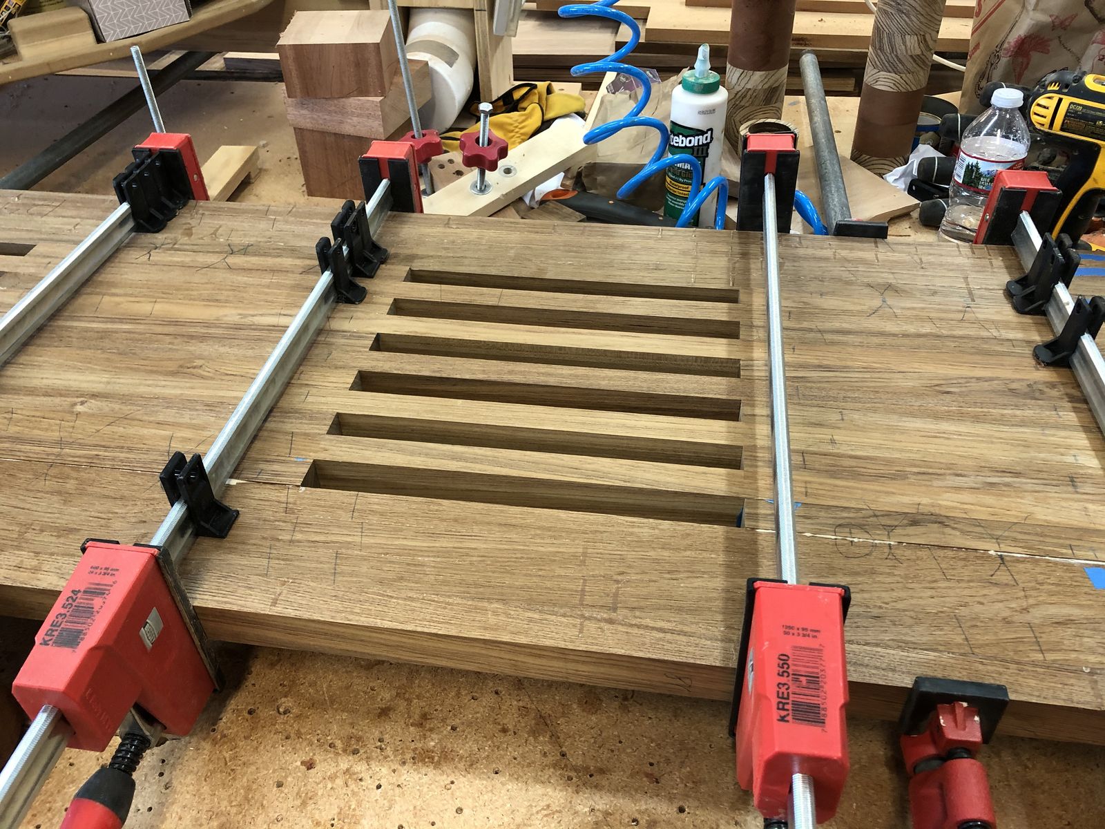

Popular Post Masonsailor Posted March 6, 2020 Popular Post Report Posted March 6, 2020 Had to make a deviation from my current project to make a swim step for a friends boat. Teal is nice to work with but wow is it expensive. He paid $26.00/bd ft. It’s a fairly simple piece to construct but a lot of pieces to cut. Paul p_toad, Gunny, Cal and 4 others 7 Quote
Fred W. Hargis Jr Posted March 6, 2020 Report Posted March 6, 2020 Ouch! $26 a bd. ft! What glue are you using on that, BTW? Cal 1 Quote
BillyJack Posted March 6, 2020 Report Posted March 6, 2020 Lookin good So far. I've got some teak. I just at it as its not my favorite wood for projects. Did he consider Ipe, or was weight and color a problem? Cal 1 Quote
Masonsailor Posted March 6, 2020 Author Report Posted March 6, 2020 Yes I’m using TB III. No teak was what he wanted. Fortunately he can afford it but still that was a big ticket. It’s a fairly large swim step. I didn’t buy a lot extra and it was $1500. The glue thing with teak or any other wood that oily is tricky. I wipe the surfaces down with acetone immediately before the glue but I think that is mostly a gesture. This is a trailered boat so it won’t be in the water that much on an overall basis. If it was on a boat in a slip and in the water all the time I would do the all thread with plugs through the whole thing. Paul Cal, Gene Howe and HARO50 3 Quote
Masonsailor Posted March 7, 2020 Author Report Posted March 7, 2020 The final glue up is done. This thing is turning out to be heavier than I expected. It’s still about a 1/4” over on thickness but still pretty heavy. I still have to attach 6 support gussets which are 3” wide and 19 3/4” long for the support brackets and ladder. I guess it’s either heavier than I expected or I’m older than I think. Hmmm Paul Artie, Cal and DuckSoup 3 Quote
